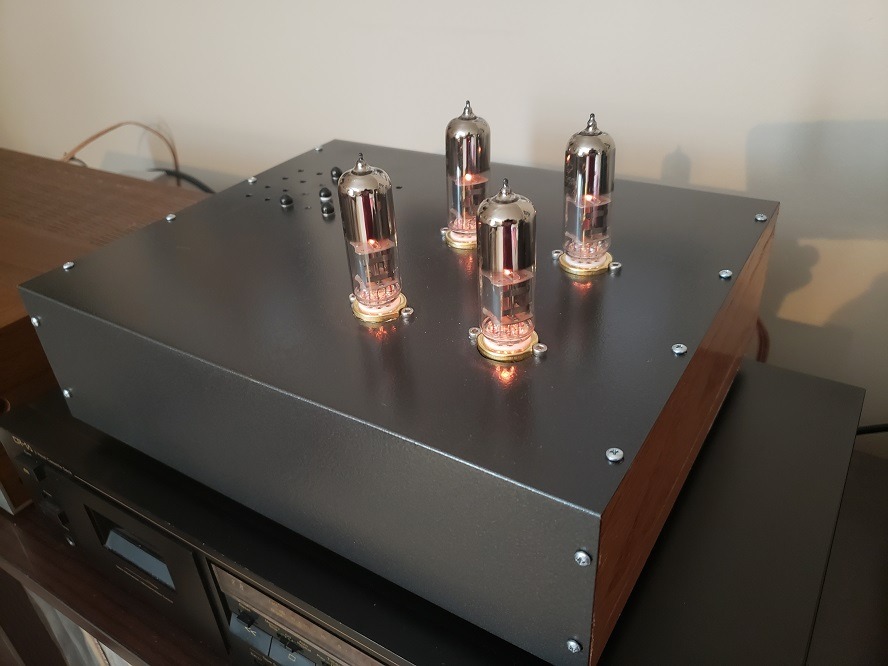

I wanted to post this recent build by Doug De Young (the more productive half of Bug Amps). it's a gorgeous build and an elegant circuit. I can't wait to listen to it.
The amp employs a pair of 6E5P in a class A PP design with input transformers. The input txs are vintage JBLs with a number of taps that Doug has used to include switchable gain. For an amp with DC heaters, it's very quiet. The amp has respectable distortion and frequency response:

It is actually a LTP, But with 2 separate by DC tails for better idle current balance, and cathodes connected by a cap on AC.

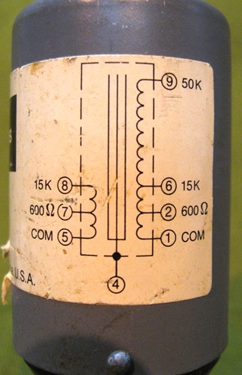

Phase is split by 150k grid leak resistors. Specs of JBL transformers are visible on pictures.

Waveborn has it exactly right, as usual! The 6e5p is a cool little tube because it’s got a fair bit of gain and huge transconductance. Like a 6j43p. That makes it ideal for a small single stage amp like this. Though single stage doesn’t really describe it well as I count the step up input transformer as the first gain stage really.Interesting amplifier. Can you describe teh circuit Doug. Is the 6ℨ5∏ (couldn’t find a cyrillic miroir umaged E) siuliar to any NA or Euro tubes? What are te specs for the phase split trap?

As Waveborn pointed out the CCS on the tail is split in two so that the current balance in the output transformer can be essentially perfect. All AC current flows through the caps between the cathodes. This also cancels distortion and forces class A operation. I matched all the npn BJTs for current gain before I installed them so the single 2.2v regulated supply is a global bias setting for the whole amp. I hope that’s elucidating.

The output transformer was changed. The reason being was I designed this at around the same time I designed and built a separate similar amp with 6j43p tubes. I ended up using the output transformer I designed this circuit with in that other amp. So when I wanted to build this circuit I had to redesign it with a different output transformer. That is when I discovered that the oscillation frequency was different with the new output transformer. That was before I decided to change the BJT to a different device. Though none of this makes anything you’ve said incorrect.
