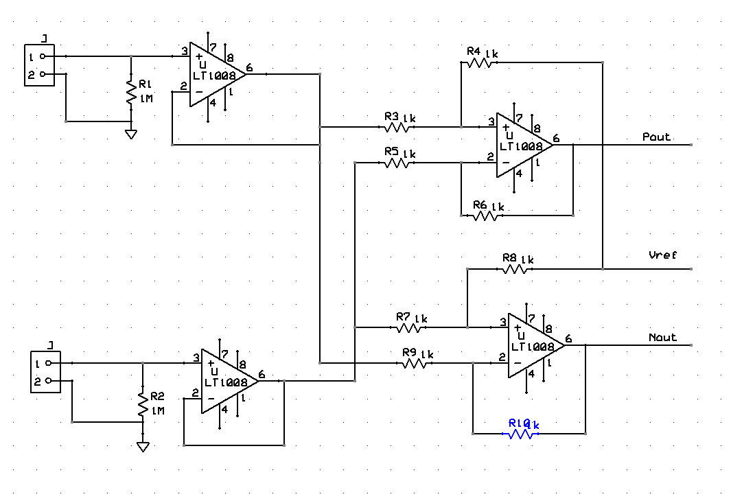

I want to encourage this project as much as I can.
I have been thinking about the analog interface problem since you sent the PM to me. Let me outline the issues so the magnitude of the problem is clear-
1) Signal to noise ratio needs to be greater than an AK5394A in all expected modes, that means 123 dB or more. (the detailed definition of this is more complex)
2) Distortion products must all be less that -115 dB
3) High common mode rejection differential input, so you get only the signal you want.
4) differential out symmetrical around the midpoint
5) High input impedance so it doesn't affect the source
6) Input induced nonlinearity needs to be very low so it doesn't add distortion to high impedance sources
The signal to noise requirements dictate high voltages and low impedances. The max P_P voltage on the input is 2.4V for each input or 4.8V P-P (1.7V RMS) differentially for FS out. The noise needs to be-124 or more dB below this. The distortion should also be less than this if possible.
AKM uses a simple 3 opamp solution that relies on either a good differential source or using an opamp to make a single ended source into a differential out (inverter). While this works it does not have much common mode rejection and requires active intervention to go from differential to single ended.
Circuits like the THAT differential design are low impedance input and require very close matched resistors (On the chip in the THAT and similar differential parts). However the resistor value may still limit the noise floor and will affect some sources.
My first thought is a pair of buffers driving a pair of differential amplifiers referenced to the right voltage for the ADC. The input buffers may need to be mixed (discrete+opamp) circuits. The differential amps will require some precision resistors and it may be possible to add the active common mode rejection. Its sketched in the image below. I have not tested it and this is not fully "baked" yet. The opamps shown are placeholders. it only needs 8 precision resistors. The opamps however need to be able to drive 1K (600 Ohms?) without distortion and it still may limit the dynamic range. Depending on the input requirements it can be scaled to have gain or loss to some extent.
Its just a starting point. The input buffer opamps need to be exceptionally good to meet the requirements above.

@ Demian,
Thanks for your elaborate feedback and encouragement.
1) I agree. If we want a total SNR of 122 dB the front end SNR must be at 129 dB. If we want 122.5 dB the front end must be at 132 dB.
2) I agree. Again the target is to get the front end distortion well below the distortion of the ADC, to avoid degrading the total too much.
3) As I tried to explain in the initial post, I plan to split the design into an input part (on one PCB) and an ADC buffer part (on another PCB, together with the ADC). So, referring to your schematic the two op-amps on the left would be the input part and the two op-amps on the right would be the ADC buffer part. Depending on how the input part is made, the buffer part may also have to show a good common mode rejection. With the simple design in your schematic the ADC buffer part would have to provide all the common mode rejection.
4) Yes.
5) Yes.
6) Yes.
Comment to 3): For the input part I may try out different designs. This could include:
A) Simple op-amp based, similar to what you have shown on the schematic. Many op-amps seem to have problems with common mode distortion though (Samuel Groener http://www.sg-acoustics.ch/analogue_audio/ic_opamps/pdf/opamp_distortion.pdf). Maybe an AD797 could achieve a decent performance here. I have a suspicion that the common mode distortion is responsible for the relatively poor THD+N performance (at high levels) of figure 10 in the AK5394A data sheet.
B) An input stage, using the LSK389, to achieve a very low noise performance at all input impedance levels, could also be interesting to design and test. It could be an interesting way to achieve the goal of 5) above. Hopefully it will also address 6) above.
Of course the input stage should also include gain and attenuation to give some flexibility in terms of being able to measure very low noise levels as well as relatively high voltage levels. I might sacrifice e.g. a 150V input option and stay with a maximum of e.g. 15Vrms to keep the design simpler. In case I want to measure power amplifier performance I could add an external attenuator.
At the moment I try to concentrate on the ADC buffer part. Therefore a relatively low input impedance is not a big problem, as long as it is possible to drive it with normal op-amps with good noise and distortion performance and does not require special op-amps with a high current drive capability, but perhaps lower noise and distortion performance.

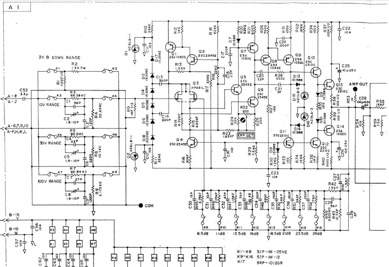

Shibasoku 725 input amp
Here is one effort. The cascoded JFETS on the input have very low input capacitance and it doesn't change in operation. However the noise is limited since the JFET noise is in series with the bipolars. in practice this circuit is about 5 nV/rtHz. Its possible to get lower if the JFETS are the input without the bipolar parts but other issues getting stability etc come crawling out of the woodwork.
It may be possible to tie the cascoded JFETS to the offest pins of the right type of opamp (LT1115). Seems like a lot of hassle for a small return but that's what a lot of this is about.

You are right about R2. Notice its a 7W resistor. It would need to handle a fair amount of fault current it seems. Maybe a fuse would be an interesting alternative.
Below is a take on the same cascoded idea. The mosfets are depletion mode which really simplifies the circuit. Adding it as a first stage with gain is more difficult to make stable. As it is the response is flat with as high as 50K source Z. Needs to be built to confirm it really can work this way. The LT1010 is not necessary.

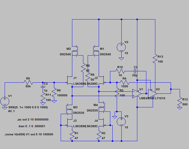

I have made a schematic, which shows what I am thinking of for the input stage. It is based on a design from the Stanford Research SR770, modified with a FET cascode, protection diodes on the input, some updated component choices and other changes.
Compared to the schematic shown in the previous post, I have moved the op-amp to the drain side of the input pair, so I get some gain here, improving the noise level. I know that it will be a challenge to keep it stable. But at least it would be worth trying.
I have simulated it in TINA TI with good results for noise and distortion. But I am not sure how much I can rely on this simulation, especially regarding the distortion. So of course I will need to test it in a real design.
Any comments to the design? Are the cascode FET's a good choice? Should they be paired? I don't have much experience in FET design. I have used the 2SK389 in a headphone amplifier I built some time ago, but it didn't have a FET cascode. For this design I chose the LSK389 instead due to availability and noise performance.
The resistor tolerances may not be correct in this schematic.
Actually I started with the ADC buffer stage and now suddenly we are looking at the input stage 😛

Demian can you post the non generic LT models for this circuit?
Here is some of the models. I have no experience with Tina so i don't know how to "port" the models but they are all pretty generic. The Supertex models came from Supertex. Your circuit looks ok. I used depletion mode mosfets from Supertex for the cascode which work well. The source resistors you are using see high. It gives a wider stability margin but higher noise and lower gain on the first stage. All tradeoffs to be managed.

I have studied the Amber 3500 input before. Its pretty trick, replacing the input bipolars with the Jfets. Cascoded this way the input cap drops a lot. Cascoding with bipolar transistors brings a lot of parts to do it.
The other interesting trick is the lighbulbs and the transistors connected at diodes for input protection.
I once made some simulations of different cascode circuits with JFET's and bipolars. At least in the simulation I got better performance with the JFET-based circuits. And of course the bipolar variants need a lot of components.
My main worry with the JFET-based version is the spread on the Vgs.
Usually you can get 5 mV between devices in duals. That can be dialed out with a trimmer and the remaining temp/voltage and time drift is pretty small. I have been using this type of circuit on products for many years with no issues. If absolute DC accuracy is required then a separate chopper circuit could be added.
I think what he meant was, does the cascode JFET's have to be paired?
