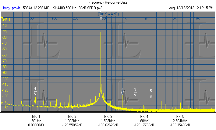

Here is a distortion plot I just made with the AKD5394A board. I upgraded the opamps in this channel to LME49710's. When I tie the two channels together the distortion rises to the level of the JRC5534's in the other channel.
The distortion is really quite low (probably in the area where you can't be certain of its real). Important- must use 12.288 MHz for the master clock. The distortion goes up with a 24MHz master clock. The input circuit is really very simple.
For what its worth I was using one of these really crude supplies for this measurement: JE215: JAMECO KITPRO: Education & Hobby Kits . Its not very good with a fair amount of ripple but I still get -130 dB hum. Same with a switcher.

Thanks for providing this very useful information. Good to know that I should use a 12.288 MHz clock.
Did you use the balanced or the single ended input?
When you tie the two channels together, how do you do that? Just the inputs?
Do you know how much of the distortion comes from the generator?

I was measuring using the single ended input (adds an inverter to drive the negative input). I just bridged the two channels with a BNC TEE. I'll swap out the IC's on the other channel later this week when more samples arrive.

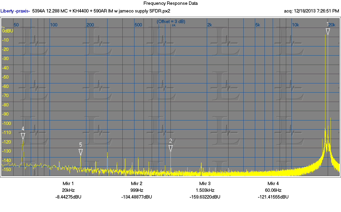

Here is an IM measurement I just made with the AKD5394A. I'm using two generators mixing at the output with the peak voltage at the effective full scale on the AKD5394A input (4.5V RMS equivalent).
The levels of each tone (19KHz and 20KHz) are approx -8 dB. the 1KHz IM product measures -134 dB. This is using the LME49710's. Using the JRC5534's I get -126 dB for the IM product. In either case that is performance close to what can be had with the best of analog equipment.
However the input circuit is not too flexible in this setup. now that there is a baseline its time to look at and test options.

Demian - are these numbers substantiated? I can measure IM to -130dB (spec'ed) with the Panasonic if you need a back-up confidence test.
If this ADC works out for the DIY'er as a reasonably priced T&M instrument, it will be fantastic.
