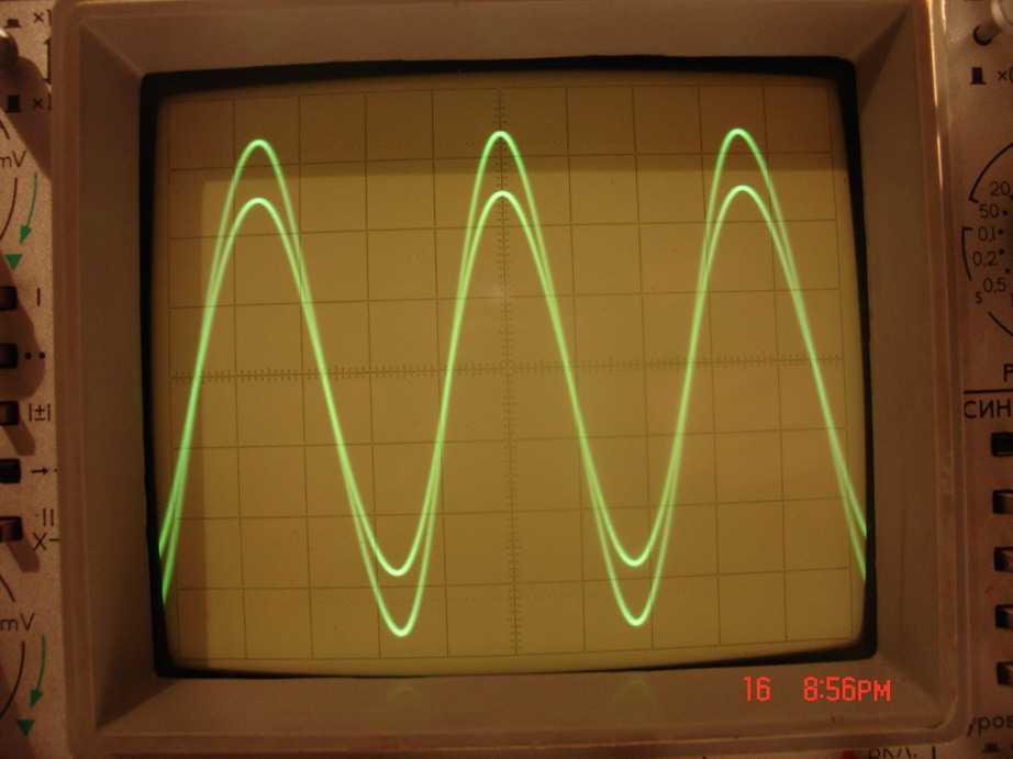

These two screen shots show an effect of decreasing the load resistor from 5,05kOhms to 590 Ohms, at 1MHz sine input signal, 14V peak to peak

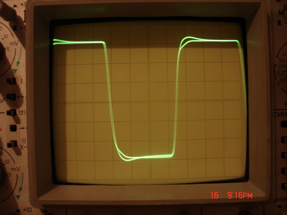

This picture shows input and output for 1MHz square wave signal, 14V peak to peak, 590 Ohms load, amplitudes are adjusted. The curve with front spike belongs to output.

14V peak to peak is about 40mW into 590, so that is a very fine result. Also I like the consistentcy of the output impedance (at normal frequency).
I know that it is not possible to exactly judge distortion from an oscilloscope screen, but as far as we can see it does look very good.
Thank you for posting your results. I am sure many people will like your circuit, and I will build this circuit for myself in the future.

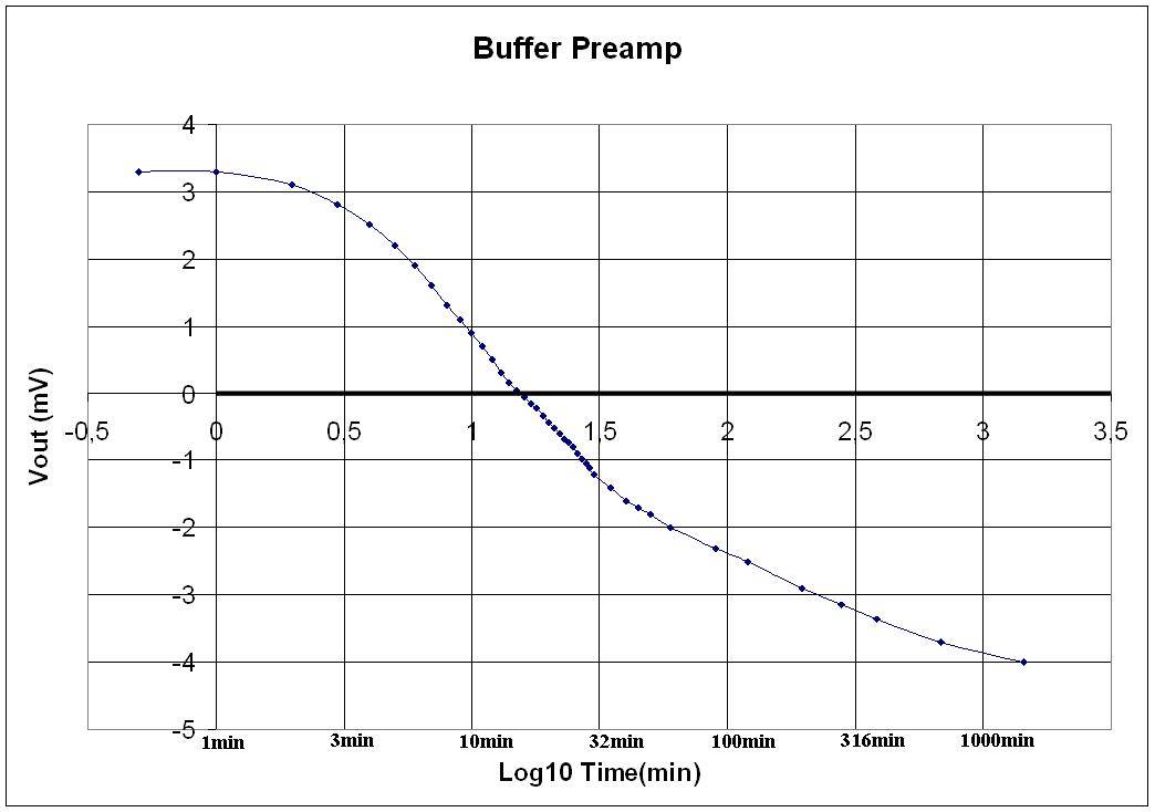

With a capacitorless buffer one is usually concerned with its thermal stability. I did a 24-hours experiment, measured output voltage at one of the channels. As one can see from the enclosed picture, reaching thermal equilibrium is very long process, since the case is heavy and and heat source is weak. But variation of few mV at the output I guess is quite admissible.

Happens in DCB1 too +/- 1mV. Takes an hour. People report that it comes across a bit better subjectively too after that time, but its not controlled info. +/- 3-4mV play I think its non issue with your build too. Very nice. Happy listening, and congratulations. Its a very good and very personal control unit made with seldom to us parts in a far away land. Very Sci-Fi. :hypno2:

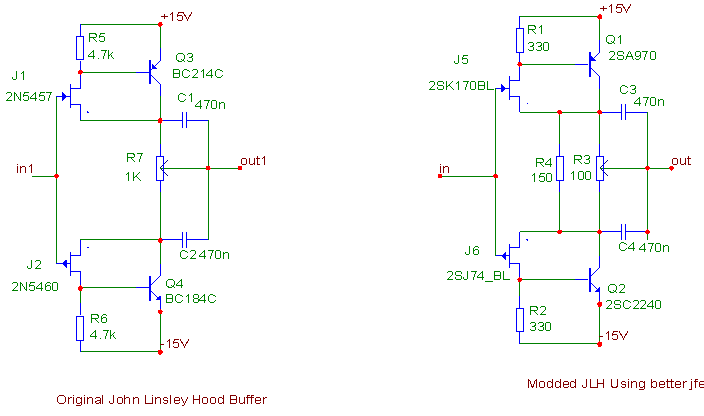

And there is the L. Hood buffer we must try under the shunt regime at a point too.😉 Another distortion profile, and holds better with level, 2 added BJTs though...

Did somebody try these buffers? Are there listening reports? It seems that we shall come to John Curl's linear module (double differential) along this line. For me, its more attractive now some 20dB gain powerful preamp, in order to try follower-based power amp.
