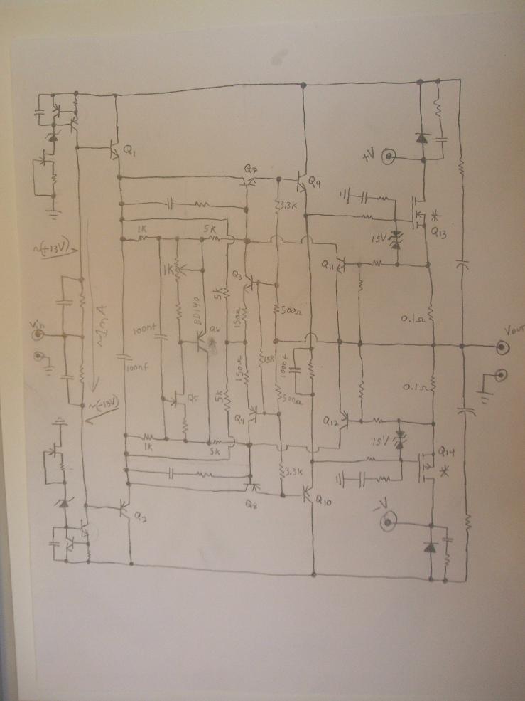

Here is mine, I used it about 25 years ago as an output stage in hybrid amp. Actually, it is a complementary opamp with an unity gain. I used diodes D1 and D4 instead of transistors in diffpairs because no transistors can survive reverse BE voltage when output is shorted. I used it as a fast fix of a vacuum tube guitar amp (Hungarian BEAG) when no replacement output transformer was available (couple of such stages as a bridge to drive 32 Ohm speaker cab). The owner decided to leave it as is, with no output tubes. Probably, it was the first hybrid amp then, though not commercially available...
As drawn, it is class AB, for class A remove diodes D2 and D3 together with pots and resistors to ground.
Edit: transistors were KT814/KT815 and KT818/KT819.

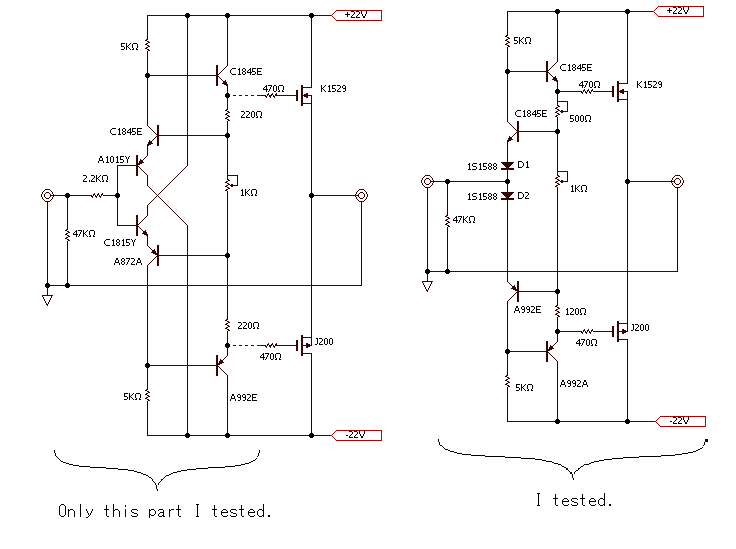

Hi
Though I don't test 95V supply....Sorry,
they are some bias for buffer circuit (not main loop feed back).
(It is not designed for 95V supply,so must replace other Tr.)
It's bias with local feedback.
If I test 95V supply , I may be try below ,
(because needs over 190V spec)
Power :2SJ201/2SK1530 200V/12A/150W
other all :2SA1406/2SC3600 200V/200mA//1.2W
if the supply is under 90V , I may try
:2SA1208/2SC2910 180V/70mA/0.9W
and resister 5K ohm is may be change (may be) 25K ohm.
OR chip amp LME49811,LME49830 ,not discrete
If I mistake ,I'm sorry very much ,please point out.
Regard

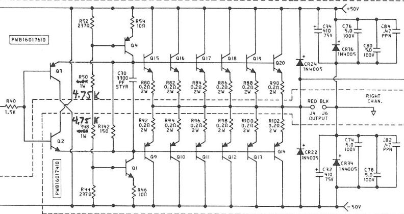

forr said:
"a HEC follower circuit"
Jan Didden's Pax amplifier output stage is a good candidate, more linear than a class A buffer, I think.

I was experimenting with a circuit intended to be exactly just a current follower. Using hexfets it is rugged as far as taking abuse and in temperature of operation. I burned my finger on the very undersized heat sink once and it just kept plugging along. :xeye: That “no secondary breakdown” part. 😀 Anyway, I haven’t bothered it in weeks due to being busy with life and I forgot some of the values off hand. I will have to dig it back out of the box later. Some of the resistor values depend on the output fets so you would have to calculate (guest-imate) and experiment a bit. It might take 7VDC between the gates just to break Vth. Anyway, it is just a CCS bias buffer with a high frequency error amplifier added to, then buffered again to drive the outputs. Q5 is bias close to zero temp co, and BD140 is Vbe multiplier. I like the bias about 300mA because the error amp has to work less and there’s a little more class A power but it’s not too bad in class B.🙂 I find these fets to be less sensitive to the accuracy of the bias source so if you over-bias and then over-compensate (with the BJT) it’s pretty hard to kill. :redhot: I guess if you use a high output voltage than you might want to limit the bootstrap. The amount of compensation required depends a lot on your layout. For Q9 and Q10 I used KSC2690 & KSA1220. Q’s 3, 4, 7, & 8 are very fast devices and can be low voltage. (<20V) One thing I like is that with the error amp gate drive you can use small source resistors and still have good bias stability with better damping that comes with a lower output Z and larger bandwidth despite the higher transconductance of the fets. So the hexfet isn’t very linear.🙄 Other than that, it makes a great output device to drive a speaker, IMO and others. So, if you can fix the non-linearity, your golden. 😉 Besides, those hexfet transistors are dollar a piece so your not out much if you screw up and melt them. :tongue:
