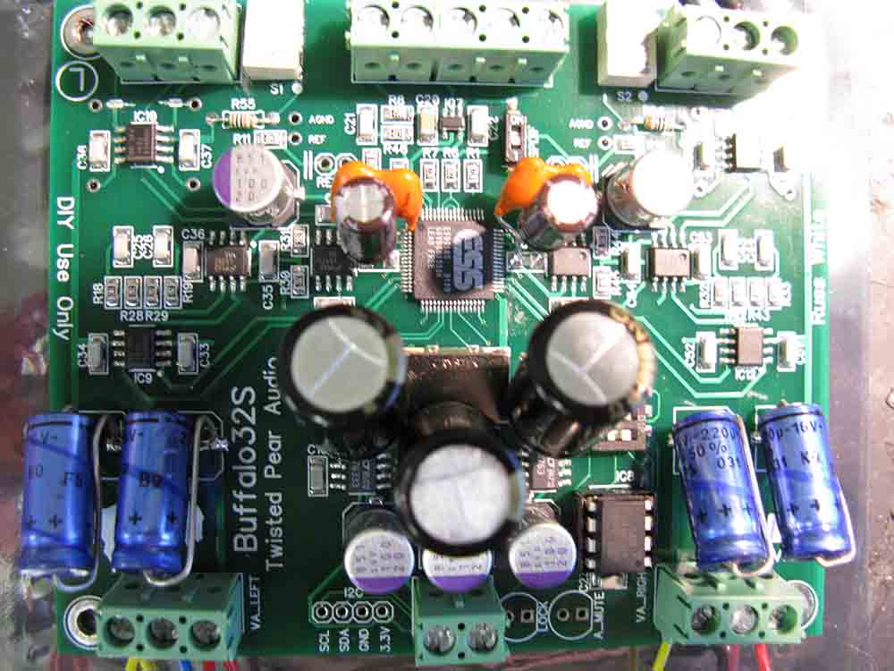

hybride said:Buffalo 1.2 ;-)
The change of caps near the Sabre chip has a relative big influence on the sonics.
Can you give us a description of what you've done. and the changes you heard?
Ok, Had good results with bypassing caps on the Buffalo24. So with the B32 i went to Mattijs de Vries from Triple M audio for advise. He is real expert and designer of power supply's for audio circuits. He never uses ceramic cap's in analog stages of the circuit because they sound bad. He also dislikes Oscons for analog stages. Oscons are very good, but there are 'better sounding' caps. What i did is remove the ceramic decoupling caps near the Sabre chip and change them for what he advised me. I have to ask him, but i thought that the orange ones are silver-mica and a little quality elco 4,7uf. I changed the analog Oscons for Philps elco's (NOS). For the 3 voltages near the clock (i suppose for the digital part) paralleled 3 x Panasonic FM elco.
Result: more open and dynamics top, more overall control. Less 'dull', more sparkling.
Next tip ;-)
I feed the B32s with batteries. Mattijs told me that feeding equipment directly from batteries gives worse results, even with good capacitors as direct buffer. Reason is that batteries has bad AC impedance characteristics. They where made for DC. When putting low esr elco's parallel it's only getting worser because they will influence with the accu. The result is worse damping. The solution is to feed equipment directly from a big elco with a serial resistor. So from the batterie with a 1-10 ohm resistor to one high capacity elco (44000 uf or higher) With that, there will be a RC filter. With the formula F=1:2*pi*RC the rollover frequency can be calculated. In other words; above the rollover frequency all the current will be taken out of the elco, while the batterie is loading the elco with straight DC current.
The values depend on the current. The lower the current the lower capacitors can be used.
Next tip ;-)
