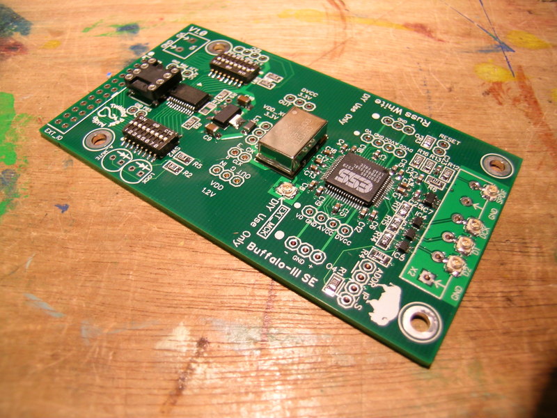

Buffalo-IIIse u.fl connectors
Had some time for building. Here is the Buffalo-IIIse with optional u.fl connectors.
The connector for EXT_MCK will be pre-installed standard. The u.fl connectors for I2S and S/PDIF will be available as an uninstalled option (they are not that hard to solder). As usual, terminal blocks are included in the kits.
The IP_S pads in the foreground control the input switching (S/PDIF or I2S) via a simple switch or digital logic.

Brian: The switching, will it be simlar to the 4-spdif board that you short to pads of the IP_S, and if "programmed" with external controller, what kind of command would you need to send to "switch", just a 5v(to two bits in different orders?)

As far as I know CCHD-950 dosen't have chip enable (tristate output) option. Which XO is used in this version of Buffalo DAC?
There's an option for BIII-SE without XO?
