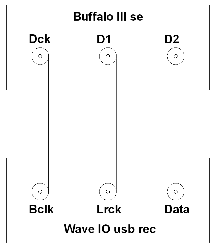

Buff 3se on waveio
spdif work fine
i2s lock is off and mute is on
BLCK - DCK
LRCK - D1
DATA - D2
GND - GND
with isolated i2s the same result
buff 3se all switch on
idea ? 🙂 thanks a lot

Hi Russ
It plays perfect on i2s now 🙂
many thanks for the quick response
I should study the manual better🙄😉
