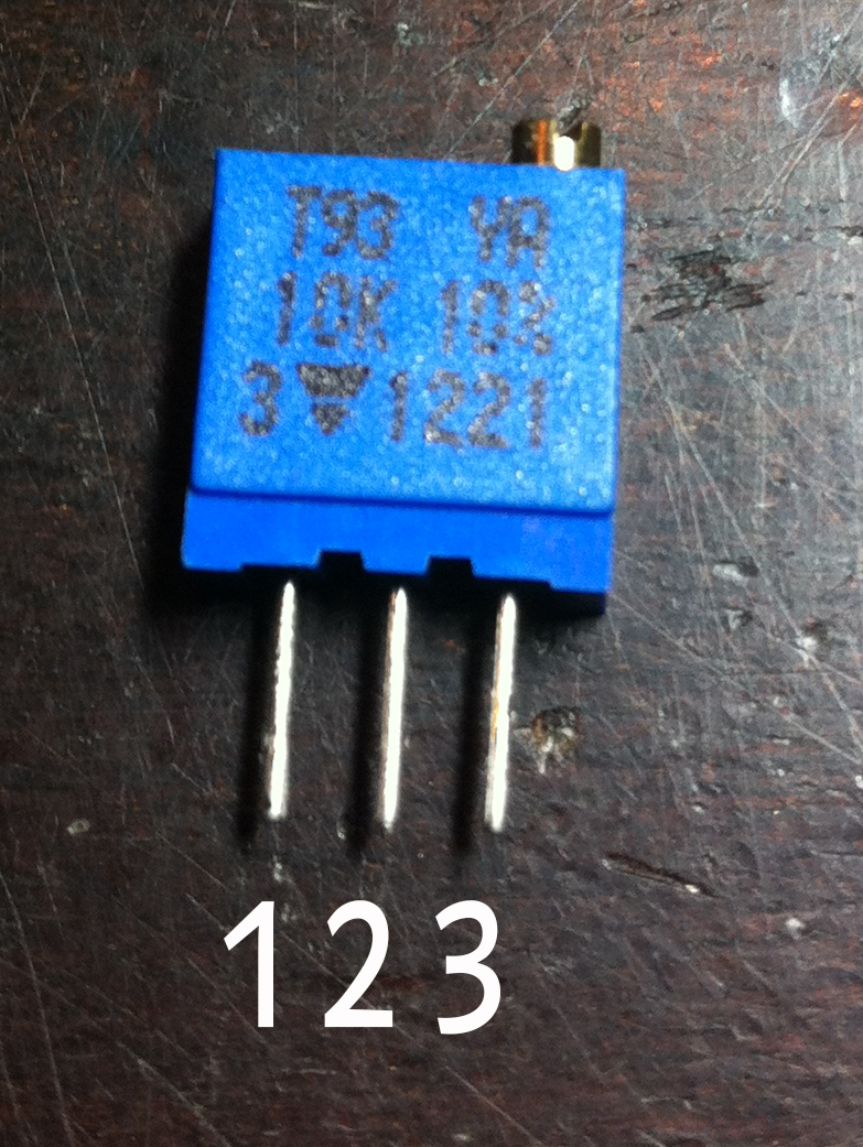

Started with the Placid HD BP. Manual says about the trimmers: Measure resistance between the two outer pins. (pin 1 and 3 in my picture).
I have don that but the resistance does not change. (stays 9.5K). Trimmer is not installed on the PCB. What am I doing wrong here?

That is because pin 2 is the wiper.. pin 1 and 2 are the far ends of the pot plane, and does because of that have a constant resistance.
You will notice on the board, the wiper pin (2) is shorted to one of the outer pins, which is why you will see adjustment once it is installed.

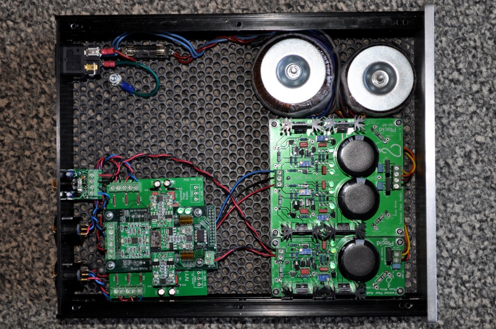

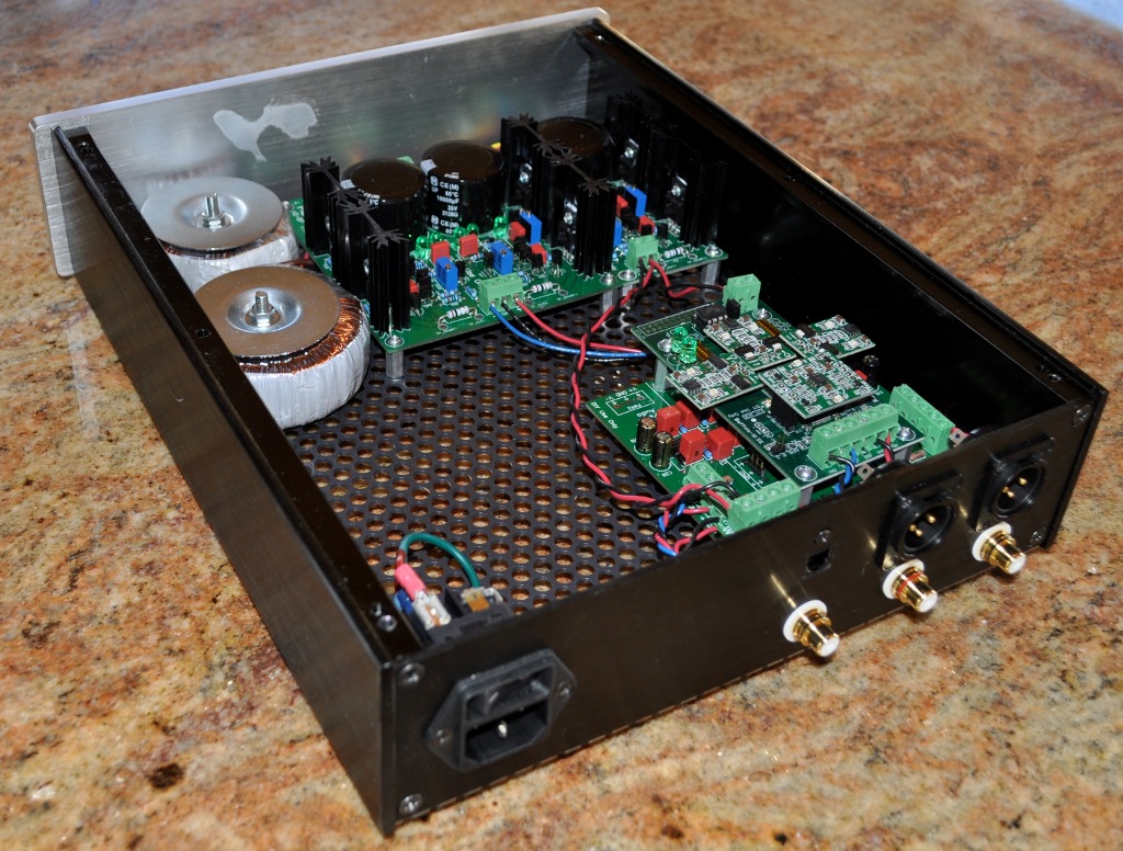

I finally finished by Buffalo-IIISE. The enclosure is really too small (11.6" x 9.5" x 2.5" inside dims) for good separation between the analog boards and the power supplies, but the hum levels are far below audibility. Good enough.
