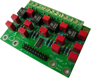

Is that 4-Input S/PDIF Module Kit listed on your website along with Buffalo 3 new one designed to work with new DAC? Thank you.
George
Four S/PDIF or AES/EBU inputs (isolated), quad-comparator level conversion, powered by B-III's Accessory Vreg (3.3v), mates directly to BIII, or via included ribbon cable/connectors.

I think- though these are fast changing times!- that a large number (the majority?) of 2 channel users will still want to feed consumer level S/PDIF to their new Buffalo III. But BIII needs TTL level input, and so they will need an additional comparator. But, at the moment, TP only offers the new 4-Input S/PDIF Module Kit to do this, making it an essential additonal purchase, together with its- for some users- unnecessary switching functions.
Is this correct? Some of your less technical customers might miss this, so I thought I'd raise it- at the risk of just proving me one of them, for completely missing the point!
One could of course simply add a comparator to a single of the inputs and be done with it. It's DIY afterall. Meanwhile, the new module is a LOT cheaper than the old MUX, even with a sidecar added, which offers additional functionality above that of the old Mux.
