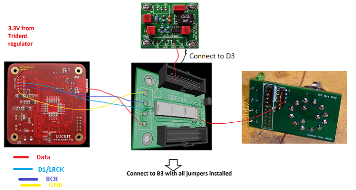

Hi, I am having problems that need your sharing or instruction to solve it.
I am rebuilding my B3 and want to be able to switch between I2S and Coaxial SPDIF using 2 bit selector.
I am connecting board like attached diagram. My problems are:
1. Do not know whether 2 bit selector and Sidecar are correctly connected.
2. Could not LOCK with I2S (I could LOCK with SPDIF from WaveIO) already tried changing SPDIF autodetect Bypass/Use.
Thank you very much.

If you are using a single S/PDIF connection, and OTTO might have been a better approach than the Sidecar.
I assume you have power connected tot he single S/PDIF module (not shown in your diagram).
Is the Sidecar connected top the DAC using all pins? I ask because it requires power, which can either come through the 20-pin connector or the control pads.
If you are triggering the Sidecar with one of the 2-bit selector positions, you need to reduce the Sidecar's resistor from 10K (supplied) to something lower, like 1K.

Thank you, Brian.
I connect Sidecar and B3 using all pin, also use it to power up Single SPDIF module. I will use lower value resistor, is my connection between Sidecar and Selector correct?
Assuming that I will need only I2S, what should I do/check to get LOCK with current configuration?
