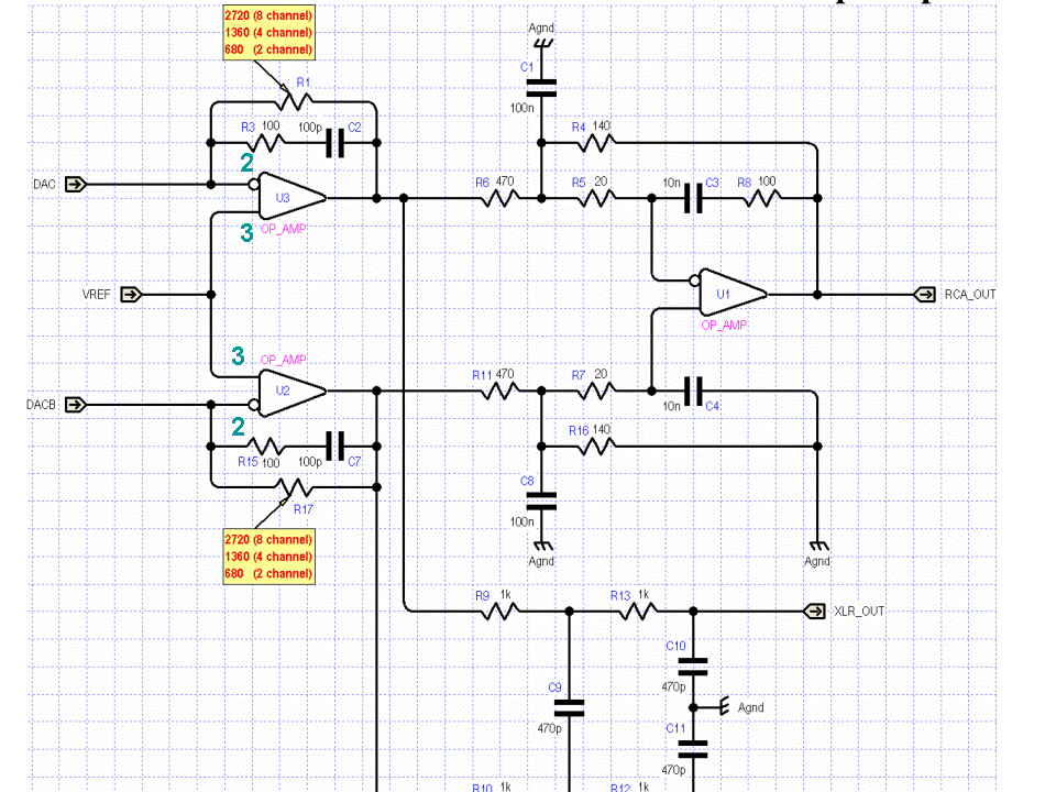

I need some help.
Please see the attached schematics.
What should be the recommended dual voltage supply?
Do I need a coupling cap for the output to RCA socket?
Where should the Vref connected to?
Is my numbering of opamp inputs correct?
Is the RCA socket connected to analog ground?
I need the single ended portion only

Everything you need to know is covered in the excellent integration guides.
