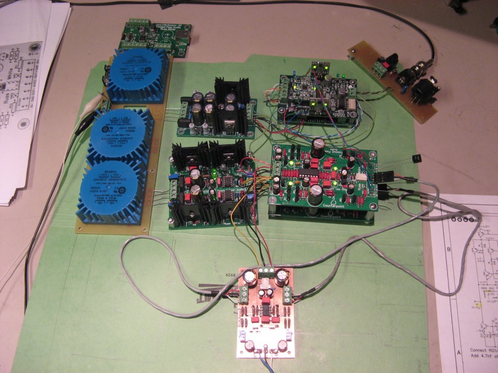

Hi. I finally resumed my Buffalo-II project. I bought the parts years ago. It is running right now but I have a problem that I doesn't seem to be able to solve. My current setup is:
-Buffallo-II with Trident Shunt Regs. The Volumite is on order. The Buffalo is stacked over the MUX. I'm using the I2C interface between both. I'll supply the Volumite directly from the Buffalo.
-LCDPS Supply: One side adjusted to 5.25V (Buffalo-II is using the Trident). I bypass the first R1 CRC resistor to get more current as instructed into the integration guide. Other side adj. to 5.0V, supply the MUX.
-2 Counterpoint ver2 I/V converters. Power supply from one Placid BP (one supply for the two counterpoints. Supply adjusted at +/-15V.
-Ballsie SE converter. This is a custom version made by myself that includes the Legato Ballsie section with buffers (to drive headphones).
The problem I have is a random hiss noise sound, very disturbing with the headphone.
This noise comes and goes. It depends of which parts I touch on the Counterpoint. If I touch some capacitors such as C5 the noise almost disappear. I connected the Buffalo AVCC voltage to the Counterpoint AVCC input.
The noise comes and goes. Very frustrating. Any idea what can be the problem?

I think I found the problem. I have just one Placid-BP to supply both Counterpoint and Ballsie Buffer, total supply current +-290ma. I used an external lab power supply to supply both Counterpoint/Ballsie and now the noise is gone, rock solid.
The Placid-BP was designed to supply about 200ma max. I think my Placid was starving on current and couldn't supply all the needed current and/or regulate correctly.

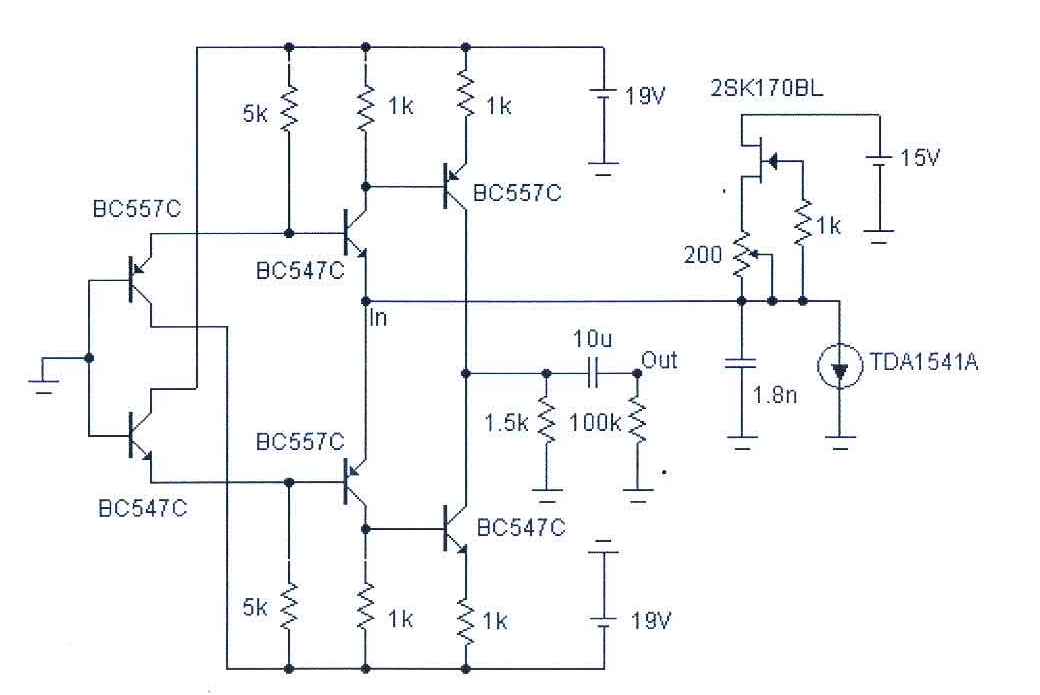

Hi Russ,
Is it possible to use attached schematic from Pedja
before the tube input stage?
Is there any DC offset to deal with?

So the schematic can work for Buffalo II.
Please tell me will it also deal with the DC
offset.
Thank you.
Audiohifi
