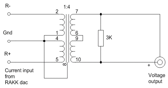

Running the B-II in current output mode and using a trafo and resistor for I/V.
The Lundahl LL1674 seams like a popular choice.
How do you hook it up and what are your results?
What impedances are you seeing, gains, voltages, ...?
Pros and cons for using a trafo?
Other transformers are welcome as well
The Rakk Dac do it this way... (LL1674)
I guess that'll work if you want SE output?

I'm a little worried using a LL1674 will give me to high output level? 1:4 would make the 1.65VAC into +6VAC and you only need 2V to drive most amps to clipping. The buffer will take care of the current.
So, I was thinking a 1:1 or 1:2 ratio would be better? However the lower the ratio the higher the load impedance to dac will see.
It feels like going in a circle and no one's the winner?
How high should the target output voltage be? (Passive vs into a buffer?)
Is it even possible to use the dac sucessfully in current mode with a trafo?
Since I'm adding a buffer, do I even need the trafo or is it redundant? Is the trafo only needed for truly passive output?
Is voltage output really any worse than curent out? -120dB to -108dB THD is really only a factor 4. The distortion is 4 times larger with voltage out, still in the 0.000x% THD range.
My tube buffer will surly have more than that?
hi,
Connecting LL1674 trafo directly to output of DAC puts it automatically to curent mode because od low DCR of primary windings.
In the model DAC is treated as an ideal current source which has infinite output impedance. Real DAC isn't ideal current source and has finite impedance and this value should be mentioned in datasheet. For example PCM1704 has 1kOhm.
LL1674 should be fine with 1:4 because the higher turns ratio, the lower impedance is seen by DAC - lower THD. If you got too high output level - great! - decrease load resistance on secondary - you let the DAC to see even lower impedance.
If you use trafo with 1:4 ratio you do not have to use any active buffers.
BTW What resistor you use on secondary?
AN_912.pdf, right hand paragraph, top of the page: "Equation 4 through Equation 7 can be used to predict the impedance seen by each DAC output (ZNORM and ZCOMP)".
Znorm=Zcomp=R0*RL/(2RL+4R0*N^2).
If no R0 is used it should be comparable to a resistor with infinite resistance?
RL<<R0 -> Znorm = RL/4N^2 (Very approximate)
Given the LL1674, N=4 -> Znorm = RL/64
Vs= (sqrt(2)*Imax/2)*(N*R0*RL/(RL+2R0*N^2))
Approximate R0 with infinity and we get
Vs=(sqrt(2)*Imax/2)*(RL/2N)
We want Vs=2 and Imax is 4mA I think?
RL=5657ohm
Plug this in and Znorm=88ohm seen by the dac. Do we just add the DC resistance to this, making Znorm=121ohm?

I think you should do it this way:
take your ll1674, put on secondary some fixed resistor (eg. 2,2k) then calculate R0 with equation (9) for Rl=2,2k it will be 68ohm and use this value as termination resistor. In this case impedance seen by DAC will be 55ohm (including DCRs of pri and sec ofcourse) and output level about 2V. It is quite managable.
You must strike a happy medium between acceptable output level end lowest possible impedance seen by DAC.

If I were going to use a transformer with the BUF II it would be a 1:1 600:600 type. Because your *always* using the DAC as a voltage source when you use a transformer. This is because the DAC is truly a voltage source with an output impedance of 195R. 195R is not a lot of impedance. So it is nothing close to an ideal current source. To compensate you need a load with *extremely* low impedance to make the "non-idealness" have as little impact as possible 🙂. Much lower than you could achieve with any transformer I know of. I have said before even a 10 ohm load modulates the outputs enough to cause 10-12db THD gain.
You also have to look at the transformer as a reactive component and your not likely going to get the impedance down low enough where THD will be stellar across the audio band. Good, yes. But, not as good as possible. I don't mean to make that sound too negative. It is not meant so. It just to set expectations. Also the distortion (not just harmonic) of the transformer itself will be much worse than -108db. So I would not even let that number come into play. 🙂
So if I were using a transformer I would not think of the DAC as a current source. As for it to be an effective current source requires an input impedance at AC and DC which is simply too low for any transformer (any many active stages) to achieve.
Now it is perfectly acceptable to add resistors to GND at the outputs of the DAC which then really just become voltage dividers. This is a very effective way to manage the output swing.

I don't understand why BUFII will work as a voltage source..it was mentioned many times that load less than some value (700ohm?) will switch it to the current mode so load about 50ohm will not?
marcusG,
about 55ohm. to the Rl value you should add DCR of secondary winding (605ohm) so with Rl=2,2k you will get 2,8k (-> R0=87ohm), then it is reflected to primary and with equation (10) you get Znorm=22ohm, but there is DCR of primary winding 33ohm so 33+22=55ohm
marcusG,
Your missing the whole point. It is both a voltage and a current source. it does not switch to either it is always both.
Its just that for it to appear to be an ideal current source (infinitely high relative output impedance) the load it is driving needs to be close to zero ohms.
For it to appear to be any ideal voltage source(infinitely low relatively output output impedance.) the load need to be close to infinite impedance. 🙂
So you see using it as a voltage or a current source if purely dependent on the relative impedance ratio between the source and the load.
At 195R 55R is not a very low impedance at all. 🙂 The ratio is what is important and it needs to be orders of magnitude higher. 🙂
I think I have explained this as well as I can.
Cheers!
Russ
It makes more sense to me now. I thought that there are 2 separate modes switched automagically - two diffrent modes like in other DACs like AD1865, but it usually it has separated pins.
Now it we want to use BufII in voltage mode, imput impedance of transformer should be many times higher than 195ohm so maybe trafo 10k:10k will be better choice than 600:600?
