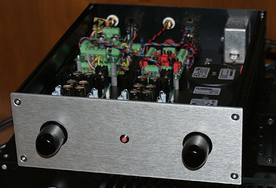

A finished Buffalo DAC
I've been busy the last days with my Buffalo DAC. Now it's all finished and I'm very happy with the result.
All I tweaked was the Vref and I don't feel the need to go any further, it's just perfect.

Re: A finished Buffalo DAC
Wow! Very well executed DAC. Nice job!
Hey! That's a net job. Congratulations. Did you cut and engraved the chassis by yourself or did hifi-2000 made the metal work for you? I know they offer this service.

Thanks for the compliments. 🙂
It's a Hifi-2000 Case (Galaxy GX288) supplied from audiophonics.fr in France.
The metal work (back panel and insertion panel) comes from schaeffer-ag.de. I wasn't aware that Hifi-2000 is offering that kind of service. With these panels you really get a professional look, there's no way I could have done that myself. One blemish may be the blank outside edges but AFAIK you could have drilled and cut your own materials.
I like the Galaxy case. It looks really neat and the aluminum side profiles allowed the insertion of a mounting panel. Like that, mounting is straight forward, everything perfectly on its place.
Analog and digital signal wires are well separated from power supply and control wires which are routed underneath this panel. There’s no hum or hiss or anything like that to hear on the speakers.
So far I’m running my DAC without the top cover to please myself with the interiors - maybe I should get a transparent acryl cover. 😉
