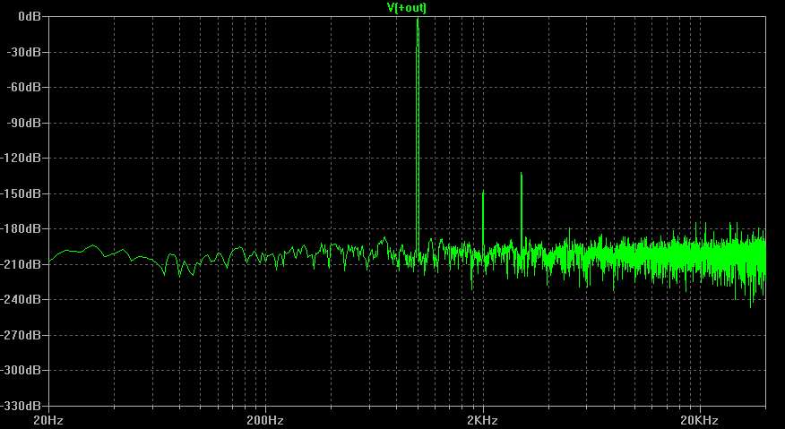

Just to show my reason for excitement concerning the new counterpoint. Here is a simulation FFT shot of the counterpoint at 1Khz (20khz is nearly identical distortion wise).
This is a single ended output at 1VRMS.
Balanced output drops 2nd order distortion to nothing.
Now get this. I simulated that result with mismatched Qs (beta 20%) and 4 ma more current through one half the the cct (simulating mismatched Rs etc). The integrator works very very well. 🙂
Cheers!
Russ
