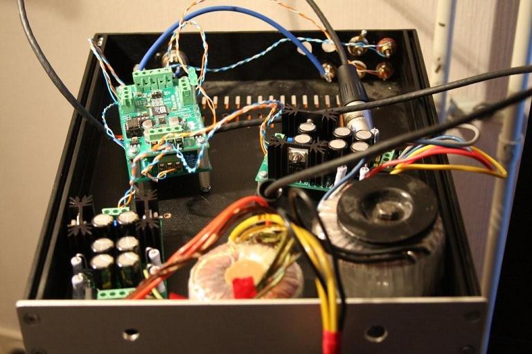

matjans said:Hey guys,
just to let you know I just built my Buffalo after the normal startup-problems: soldering station was missing/lost (i recently moved to a new house), out of solder (on sundays), no room to work, you know how it goes.
Current state: spaghetti! I plan to put it in a nice case sometime, but i'm really waiting (lurking in the dark) for the uber controller.
Soundwise: *very* good. Wide, stable, accurate soundstage. Quite neutral, i think. Lots of detail, especially in the lower (bass) regions.
I'm using it with a sonos as source (the only thing I had with volume-controlled spdif output, for lack of balanced diff. preamp) and a pair of UcD400's as amp.
Looking good. And just to make sure, it the Buffalo, an IVY and a couple of PSU's, right ?
yep, buffalo, ivy, dual supplies as in the kit, with the update pack russ sent (*great* service btw!).
Hi matjans.
Just have to say it's Brian who deserves most of the credit there. 🙂
Hope you enjoy it! 🙂
Cheers!
Russ
