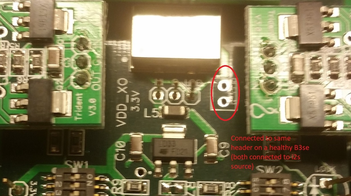

I have been trying to assist pellesmil with troubleshooting his dac. He and I believe the crystek clock is damaged. He tried to figure it out on his own with a little assistance from me. And now he needs your input on how to proceed.
The clock is damaged. I do not know if there are other problems as well. And prior to swapping the crystek I though perhaps it would be a good idea to verify that the B3 is working if the clock is swapped out without actually swapping it out.
He has a working B3se that AFAIK can be used for this. If I am not mistaken, he can connect both the B3 and the B3se to the I2S source and connect the clock pins from the healthy B3se clock output to the corresponding header on the B3 and leave out the trident on the B3? If all else is ok, the B3 should lock as well as the B3se right?
BUT. The picture he posted of the clock and the "5V" on the crystek output pin worry me. How is this possible? Where does the 5V come from? Is it related to the trident that power the crystek and eliminated as a possible issue if he remove the trident? Is this a sign of a damaged ESS chip? Is this just a matter of a Vin to Vout short on the trident or something like that?
Well, my suggestion is that he remove the trident. Measure the pin again, if there is still 5V there, well what then? Is it supposed to be like that? Come on. Fumbling around in the dark here....
Sorry for our slow replies. Russ and I have both been slammed at out day jobs lately.
First, yes, that plan should work. Thanks for helping out.
Secondly, the 5V is troubling. There is no 5V anywhere near the XO. That is a GND pin, so I am guessing it was a mistaken measurement from the 5V input to the XO GND. If not, something very strange is happening.
