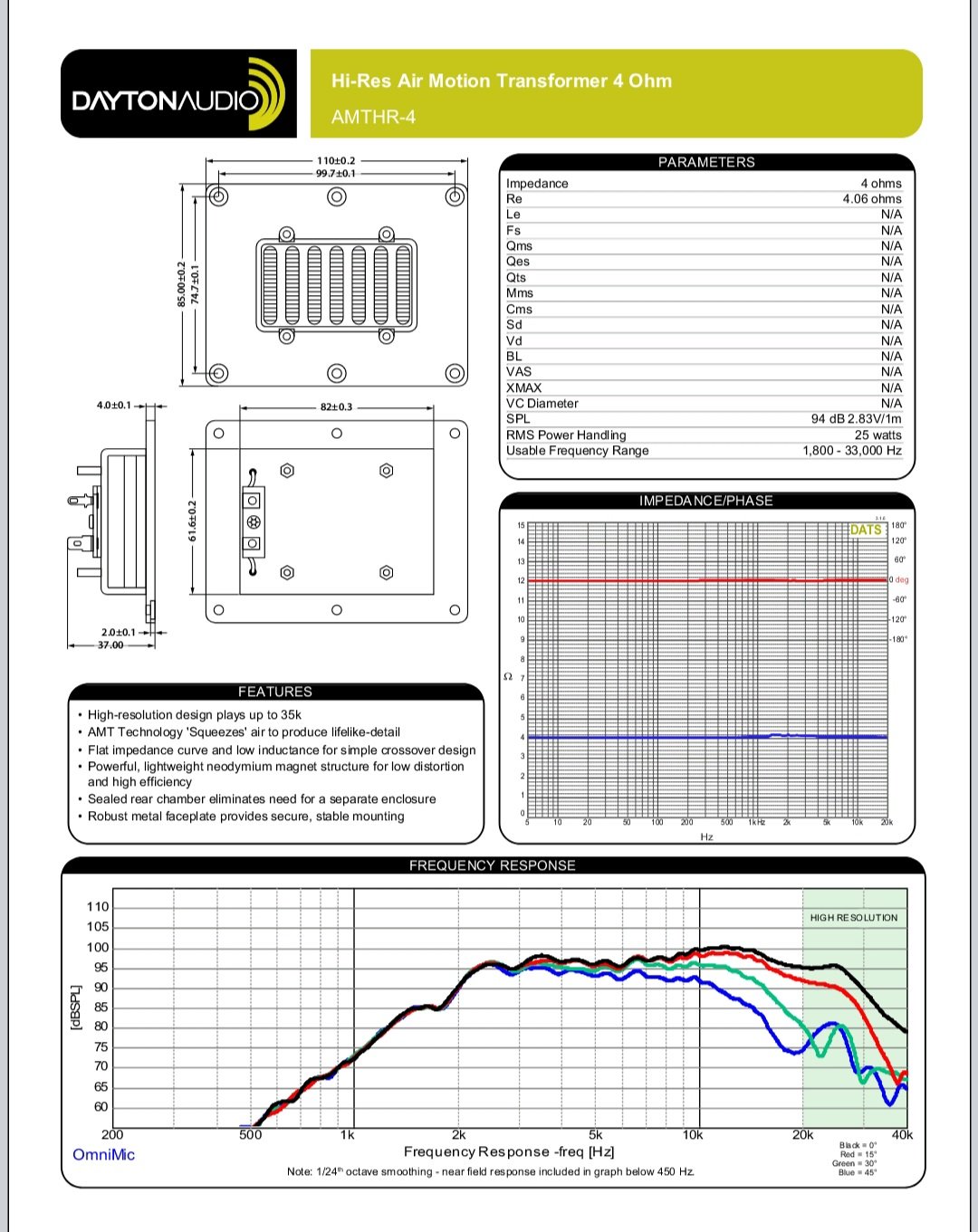

I decided to try out the newer Dayton AMT HR-4 tweeters on sale for $80. Their regular model AMT pro and 3-4 had a very ubrupt falling top end after 10 - 12 k which looked like it would sound dull even just slightly off axis. The membrane color looks different on these newer models, assuming they're thinner than the older ones. Sensitivity is also a little higher. I'll keep you guys posted.

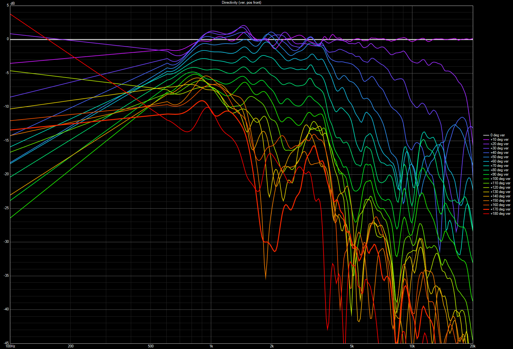

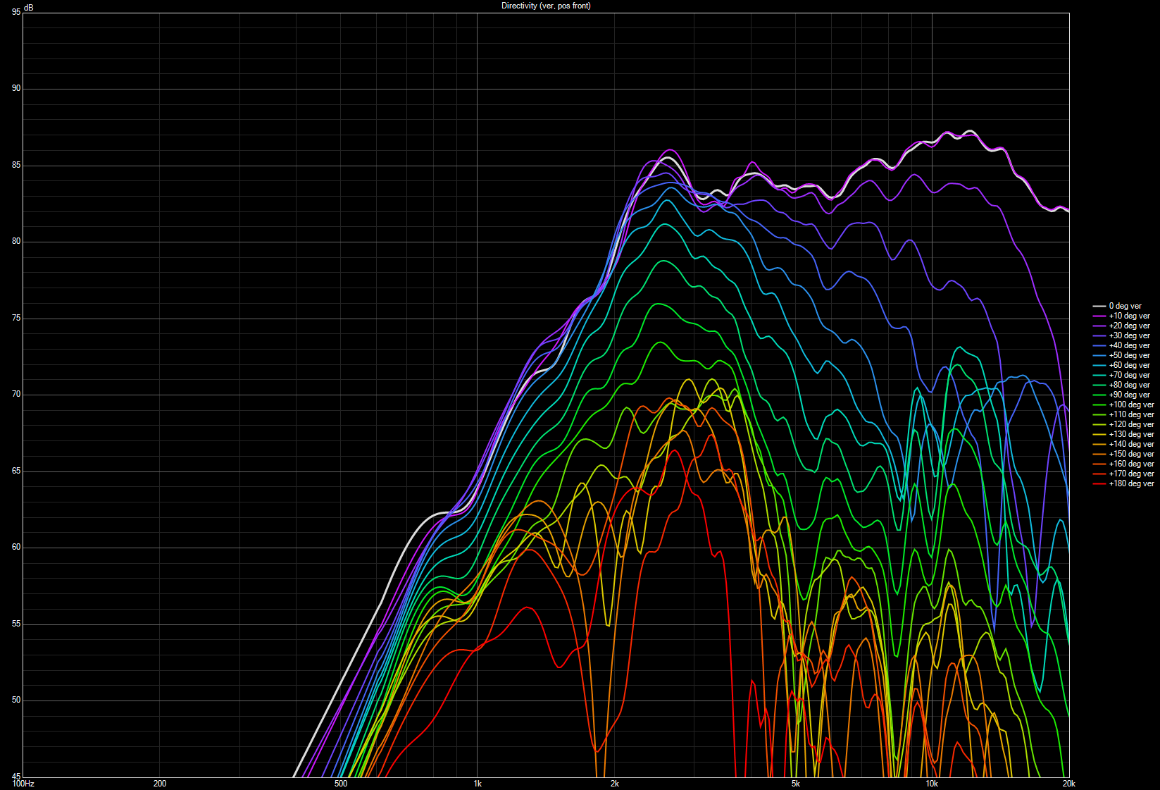

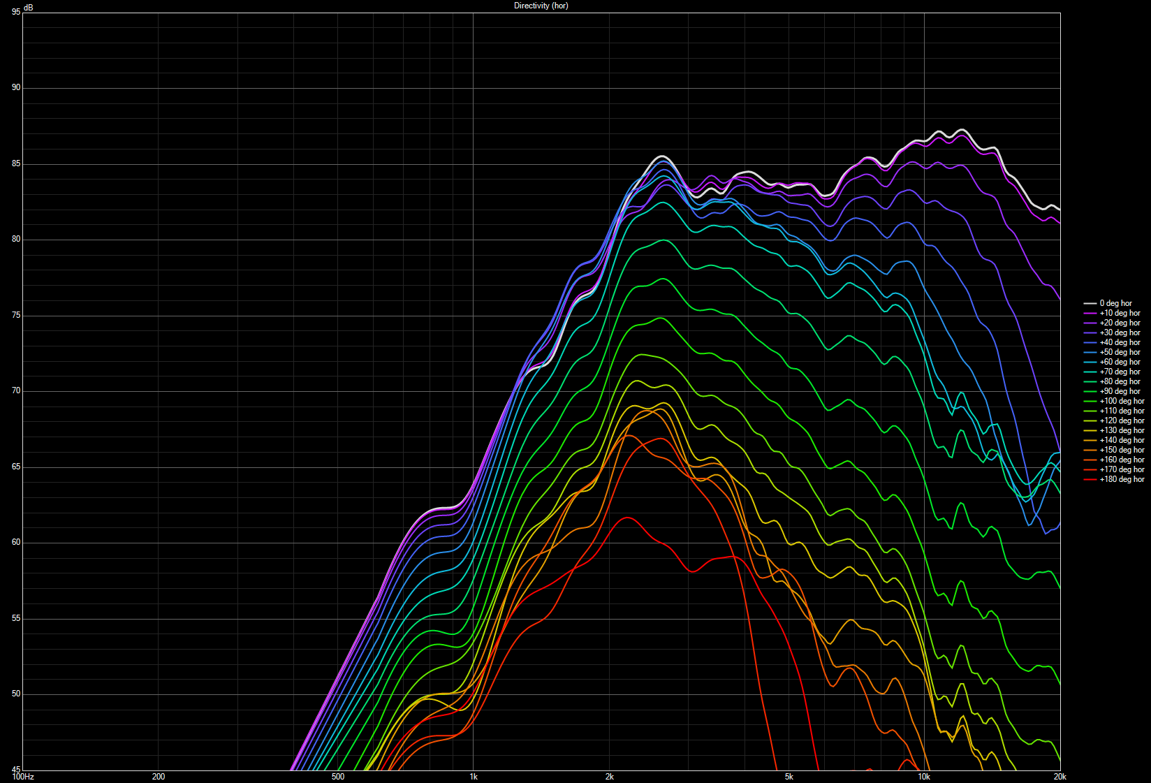

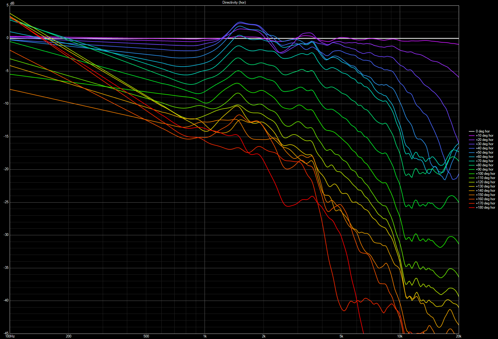

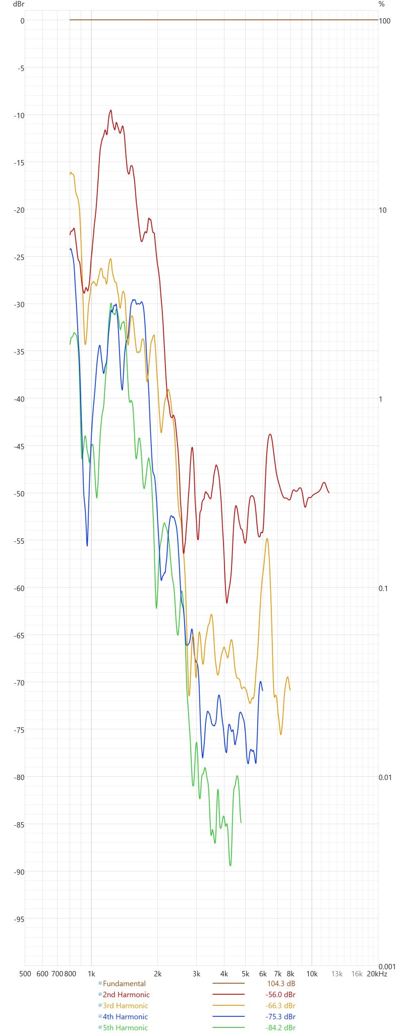

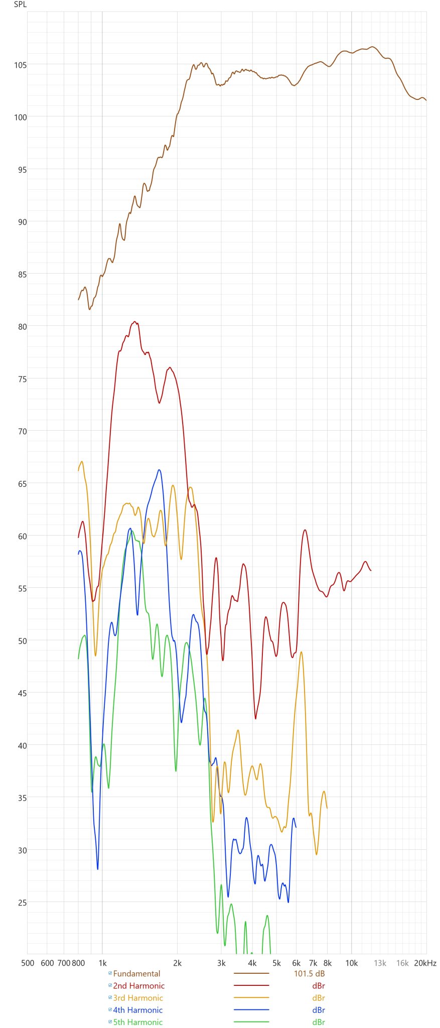

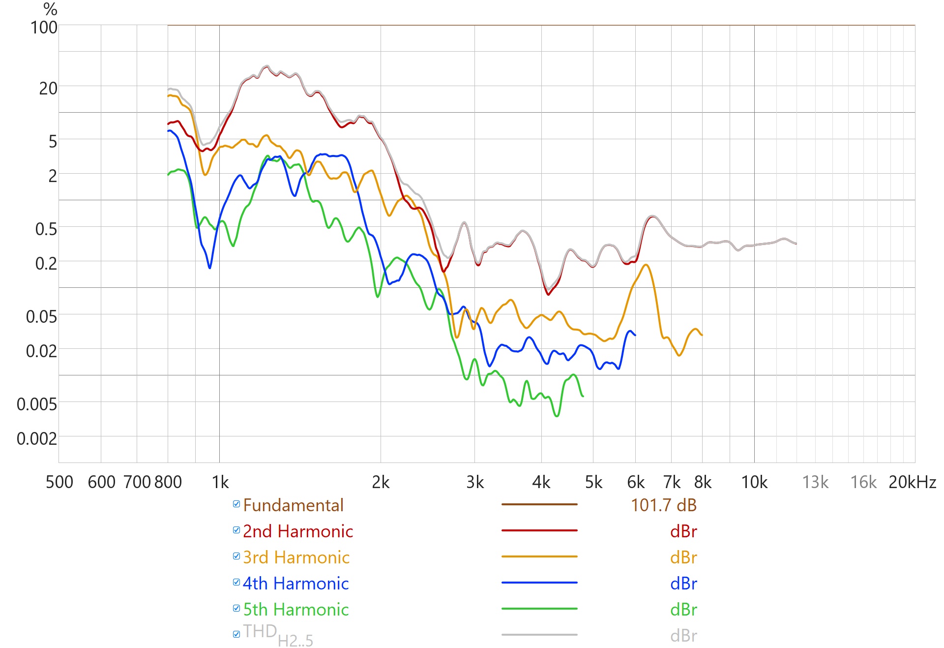

Here are some measurements. On an actual baffle, not IB. Actual baffle is 15-in wide with 1-inch roundovers. Tweeter is 5-inches from the top (top edge has no round-over) - which I think is causing a little peak at 2.7khz. Distortion measurement are at 106dB at 31.5 cm ---> 96dB at 1m.
I look forward to how @profiguy 's measurements compare.
On- and Off-axis 0-180 degrees
Horizontal measurements Normalized
Vertical measurements
Vertical measurements Normalized
Distortion
Reactions: Arez and profiguy
I don't know, I don't measure the voltage, I just use an SPL meter (which has a +/- 1.5dB tolerance).
For xo work I just get somewhere close to 87 dB and don't really pay attention.
For distortion measurements I do use the SPL meter to get 106dB at 31.5 cm.

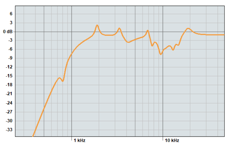

AMTPro4 have actually different lots on market and they have different SPL response curves, deviation is big. I have seen nearly flat SPL, but my ones need DSP correction.
These cheaper AMTs appear to have quite a large fluctuation in FR and inconsistent performance. This is frustrating, as you can't count on getting a close pair, unless you buy a few at a time to pick out the best 2 that match the closest. That also creates an unnecessary burden on retailers with returned units, further complicating things for both buyer and seller. Sometimes it makes more sense to just use a pair of large domes instead.
