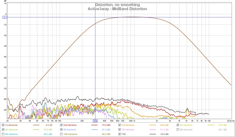

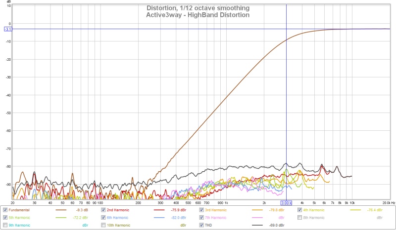

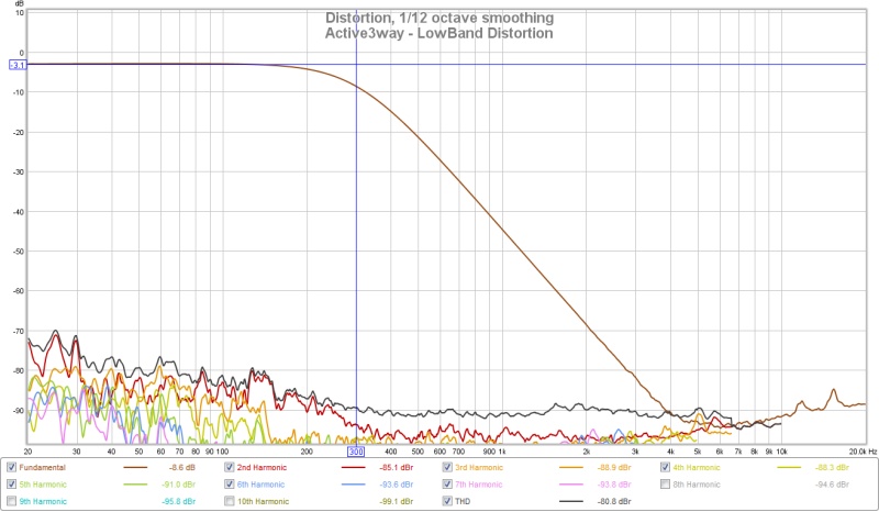

Distortion
The following are measured with REW and a PC soundcard (24b). The graphs are scaled so that the max line in = 0db. So I adjusted the output such that the max signal into the soundcard is -3db to avoid clipping. It also means that the soundcard output can't be maxed because of the gain at the active XO input.
In all cases the TH is -80db which I'm good with. Its hard to determine if its the XO or the PC sound card that's the limiting factor here but I suspect the PC. I also need to clean up some switching noise from the SMPS. Then I might try a different setup that would allow me to figure out the actual noise floor on the XO and if I can push the TH a little lower.

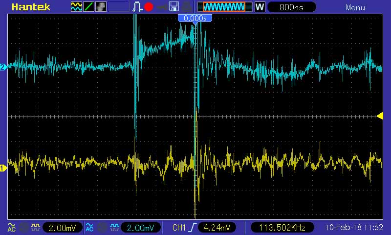

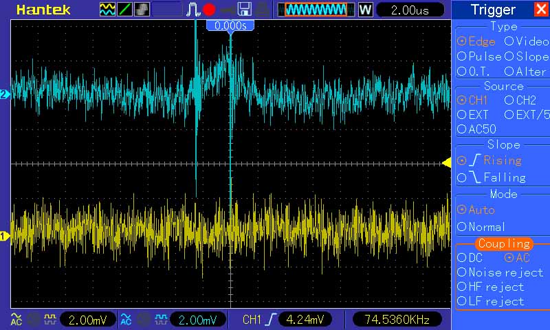

Noise
I don't have equipment or a method of proper noise measurement other than time waveform and an oscilloscope. There is some SMPS HF noise present, and the XO board lacks HF decoupling. This test was with the inputs shorted to ground and a 10K load on the outputs.
The on board regulators attenuate some of the lower freq SMPS variation. Pic#1 show the ac component of the +15vdc rail with the mid outputs (M) as a wide view. Pic#2 shows the zoom in of the ac components of the +15VDC and the low (L) outputs. Pic#3 is a zoom in of the ac components of the +15VDC and the high (H) outputs. Pic#2 and #3 show the onboard regulator helps for some variations, but the HF goes through everything. A power filter will be added after I test a few other related pieces of equipment.

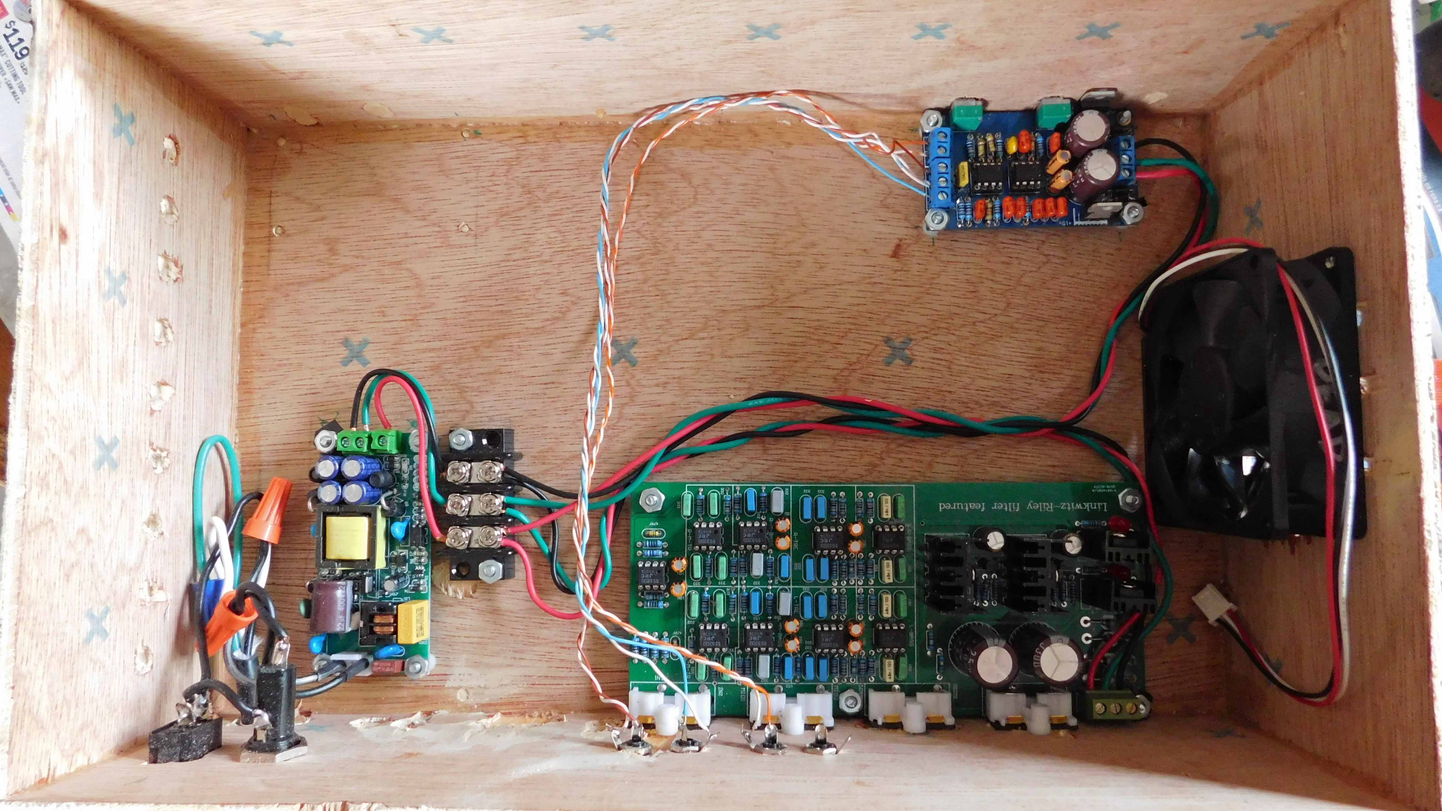

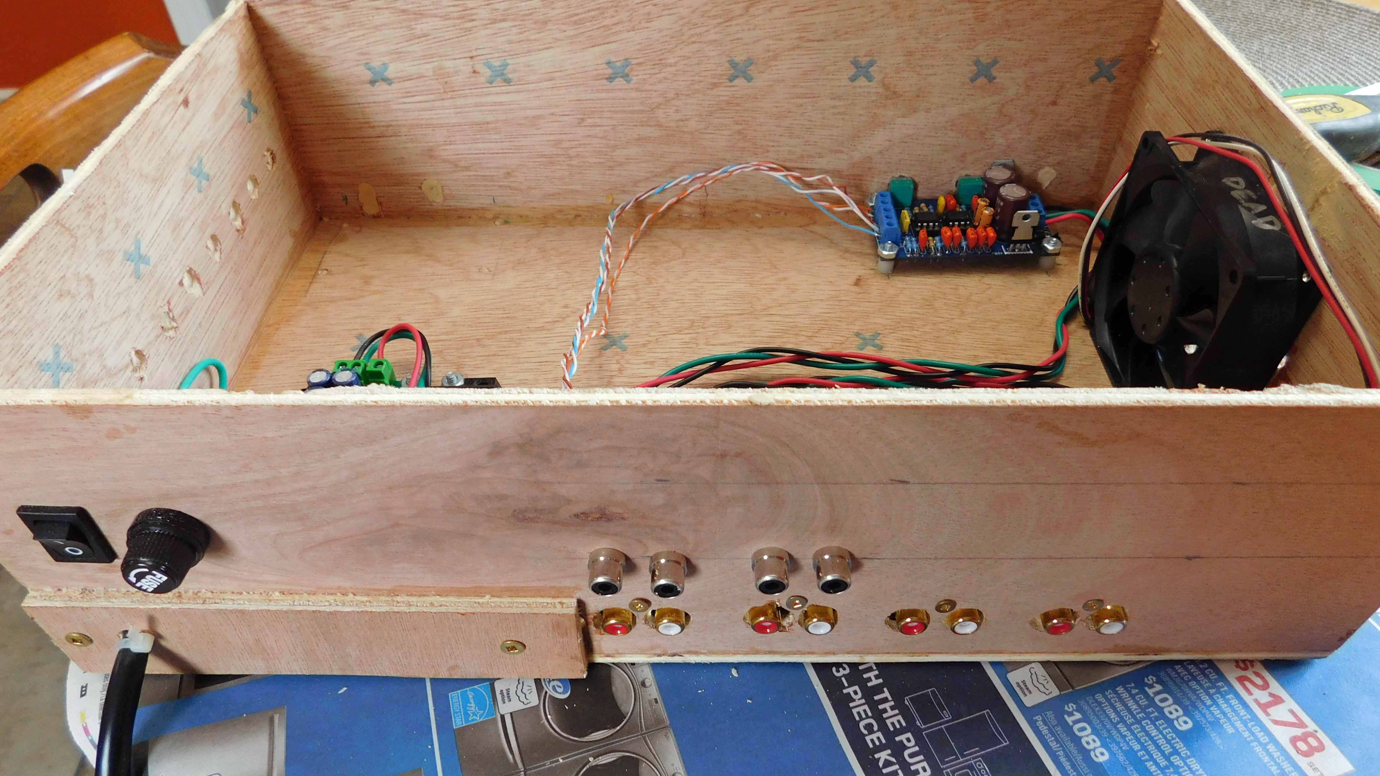

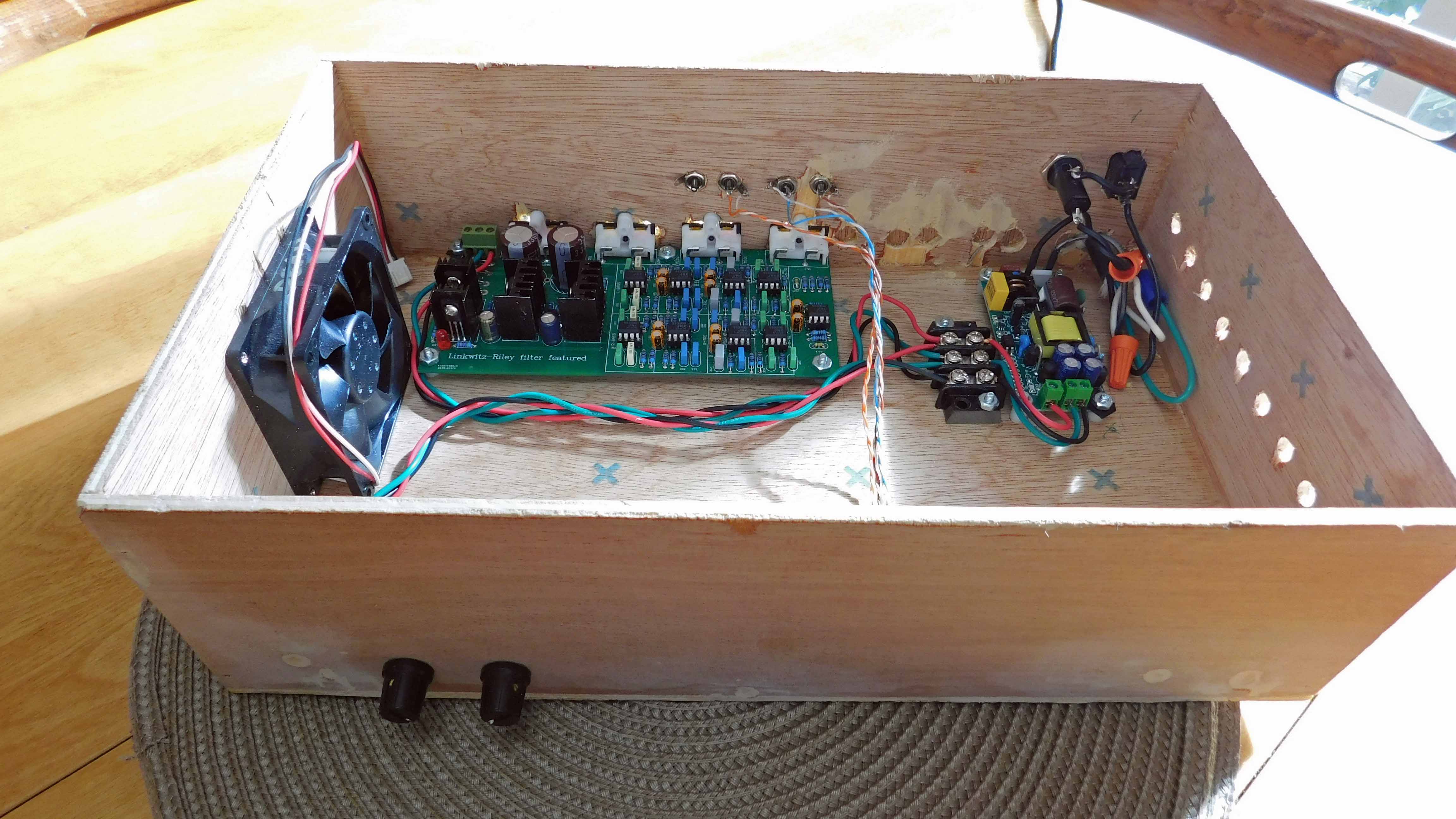

packaging
Finally got around to putting it in a box. The fan will eventually something like a LM317 based speed control to make it quieter. There is enough room left for additional boards. The current FR is shown with the mod'd sub bandpass.

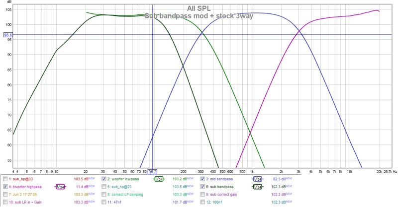

I'm getting closer to deciding on the final 3way XO points that I want. Each driver would handle 2.5 octaves and behave well in the XO overlaps.
sub : 20-100Hz
woofer : 100Hz-600Hz
mid : 600-3.6Khz
tweeter : 3.6Khz-20Khz

How do you roll off the woofer below 100Hz? The woofer and the subwoofer seem to have the same SPL from 30 to 100Hz. Will this arrangement make the sub-100Hz range 3dB louder the rest of the sound spectrum?
The woofer will have a sealed chamber, so it will have a -12db/octave acoustic rolloff at 100Hz. Still, the slopes are different (sub -24db, woofer -12db) so a small bump could occur. The sub's volume (gain) and XO point are adjustable for this reason.

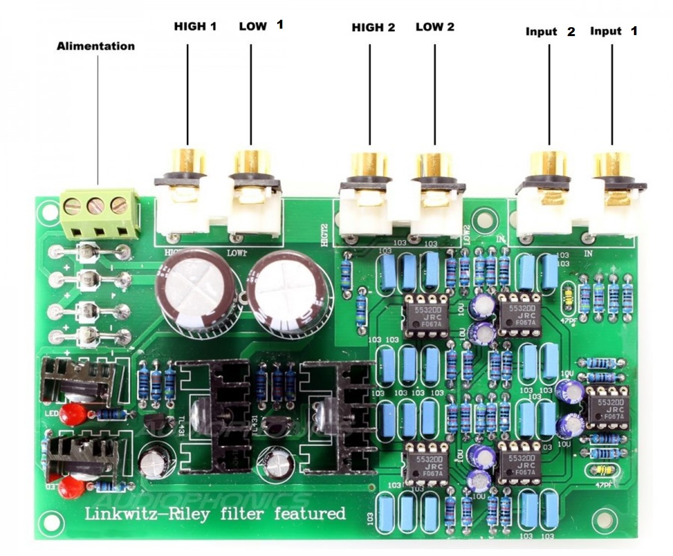

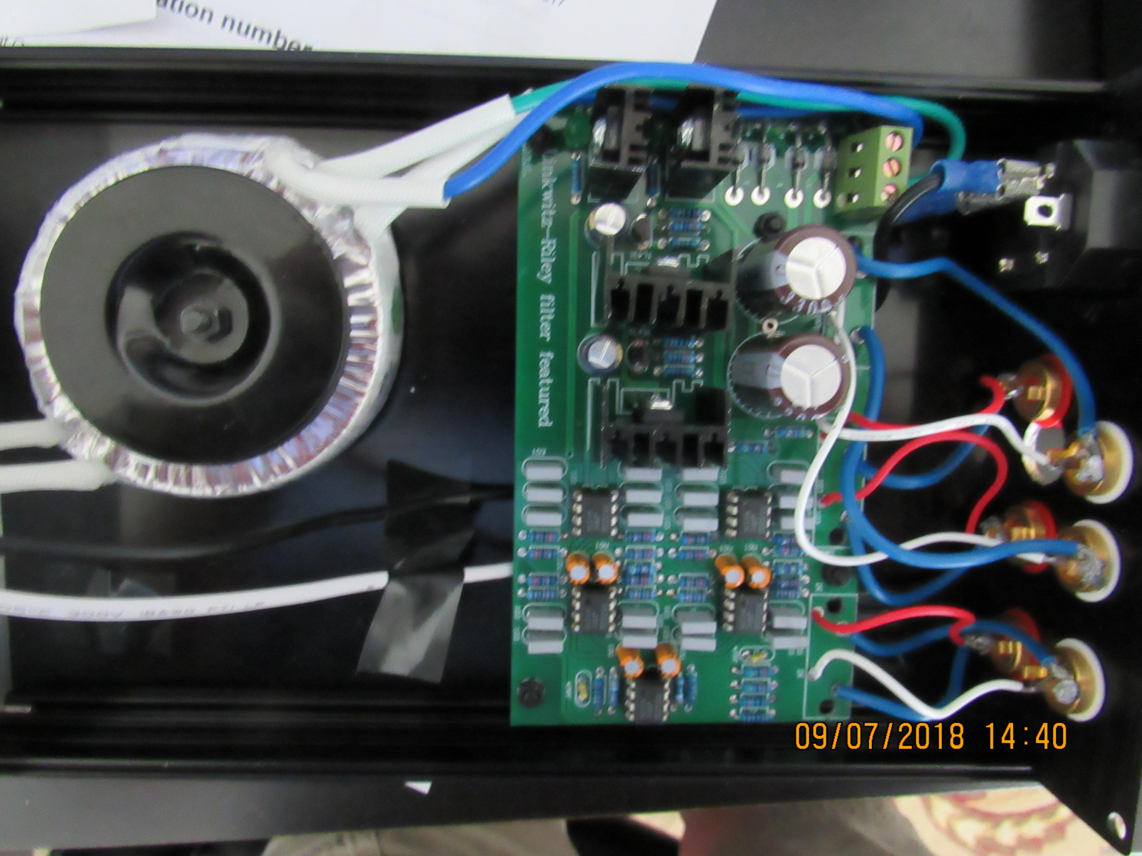

I am building a crossover trying to use this board.
Preamplifier Crossover 2-Way Electronic Frequency Divider board Free adjustable 831230323184 | eBay
But I cannot get the seller to provide a schematic or to send instruction on how to set the jumpers and trimmers after I got all the other parts and a case sized for this board. I may need to look at this.

I have 3 old fashion linear power amplifiers (6 channels). They have no input volume control. The 2-way board I purchased does have LP, HP and master volume control. I will wait a few more days to see if the seller will provide more information.

Usually, boards like the one you ordered have master volume and tone controls. There is not enough info to tell what the extra controls are actually doing.
It's very easy to add a simple 2 resistor signal attenuator (fixed gain) to the HF output of your XO before the amps. Or you could add a pot between the XO and amp input if you wanted it variable attenuation.
The 3 dual ganged potentiometers are marked bass, treble and master on the circuit board. It is possible that they are volume and tone control. No way to tell until the seller send a schematic. The 2 sided board is hard to trace without removing the components.

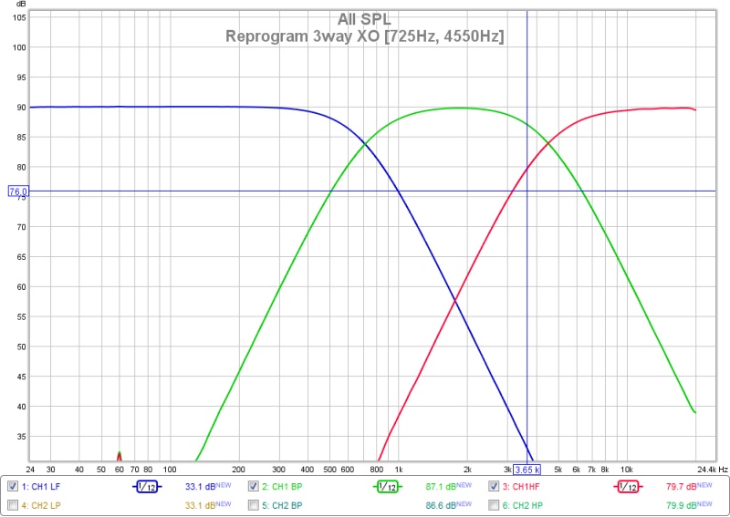

Reprogrammed XO points
I finally got a chance to reprogram this to want I need. Only the resistor values were changed, .... lots of resistors. Luckily you can buy small 1% kits with a limited [1K-47K] value ranges to suite this.
List is per channel, so double this:
[R30,R34,R50,R51,R52,R53]=4K7
[R31,R32]=9K1
[R33,R35,R36,R37,R40,R42]=7K5
[R41,R43]=15K
New XO points [725Hz, 4550Hz] will allow domes midranges and small tweeters.

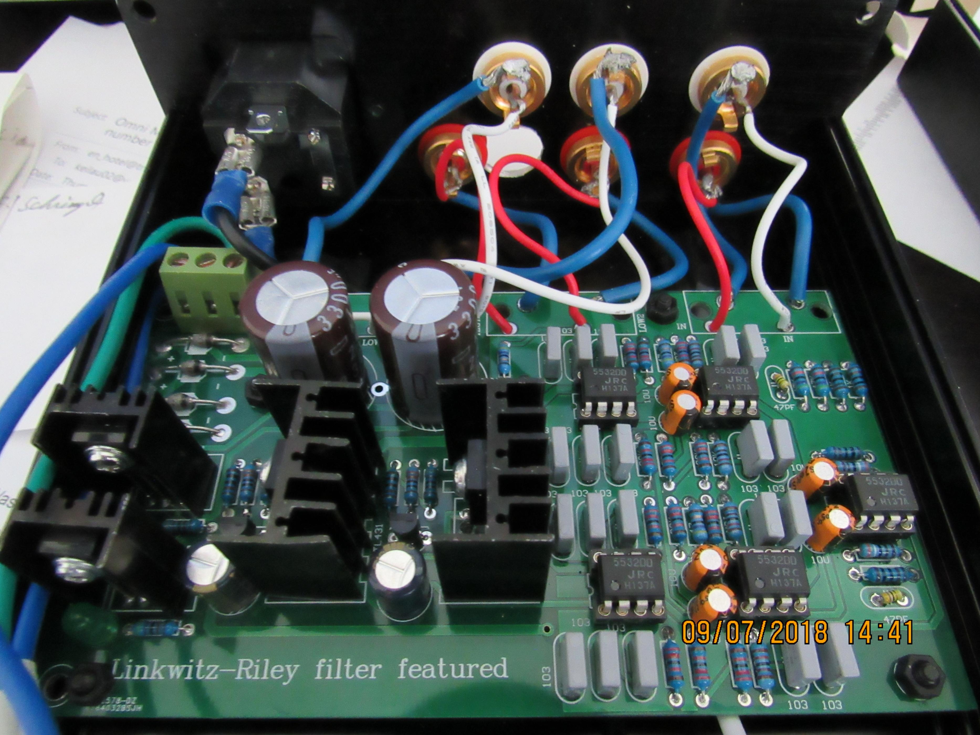

I just finish building a 2-way crossover using the PCB from a seller in China. It sounds fine first connected. It is time for some measurement.

Nice. What is the XO point set to?
First a wording of warning. The XO has gain of 4x (12db) if it's the same base design as mine (looks like it) and its output can go to 7V rms so you need to make very sure the signal level going into the XO is set to a low level. There is gain control on the soundcard output (via PC) as well as in REW (signal level). Start with both on low (-20db) setting and gradually increase to avoid clipping. REW allows you to check input levels. Assuming you are connecting your soundcard's Line Out or headphone (green) to the XO inputs, and the soundcard's Line In (blue) to the XO outputs.
The curves I show are actually 3 measurements. I sweep 20Hz-20Khz connecting the soundcard Line In Left to the XO output I want to test. REW requires both the XO's output (connected to line in left) and its own test signal Line out right (connected to line in right) to make the measurement. Set REW to output the test signal on both Line Out L&R, reference Line In right, measure Line In left.
First configure your settings via "preferences" section and then make the measurements via "making measurement" section of the help file (manual).
The filter is text book Linkwitz-Riley 4th order set at 100 Hz for subwoofer. The seller did the crossover frequency mod for me and used the correct R and C values that Linkwitz's calculation show. For my board, I have R=11.3K and C=100nF, with corresponding 2R and 2C. Component quality and construction look pretty good for me.
