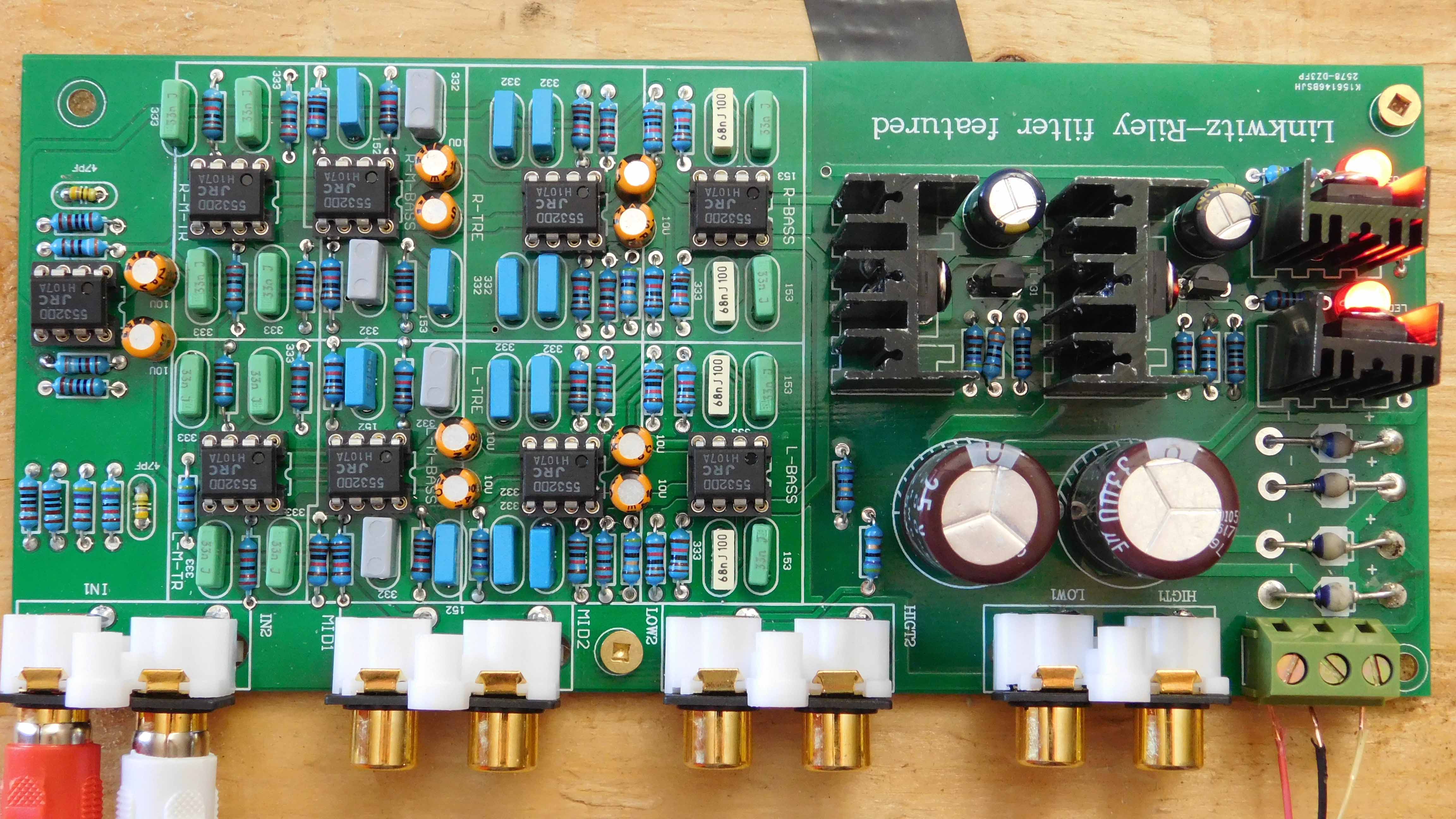

My active analog filter box is simple and behaves the same every time it's powered on. I need 8 outputs to support an active 3way stereo and 2 independent BP sub controllers. Budget active subwoofer lowpass #2, buy, eval, mod I'm very happy with the way it performs. A mini DSP (only 4 outputs) would offer no advantage to me for these functions and it may be electrically noisier. Level adjustments from differences in driver sensitivity are done at the amplifier.
I use it with a digital solution that has better DACs than miniDSP and more processing power for DSP including large FIR convolutions and customization with a headless networked audio player. Either my RPI or my PC can be used as a stereo source for this active analog filter box and they can perform any residual corrections (eq, conv) required. Raspberry Pi with Piano2.1 DAC DSP and Volumio2

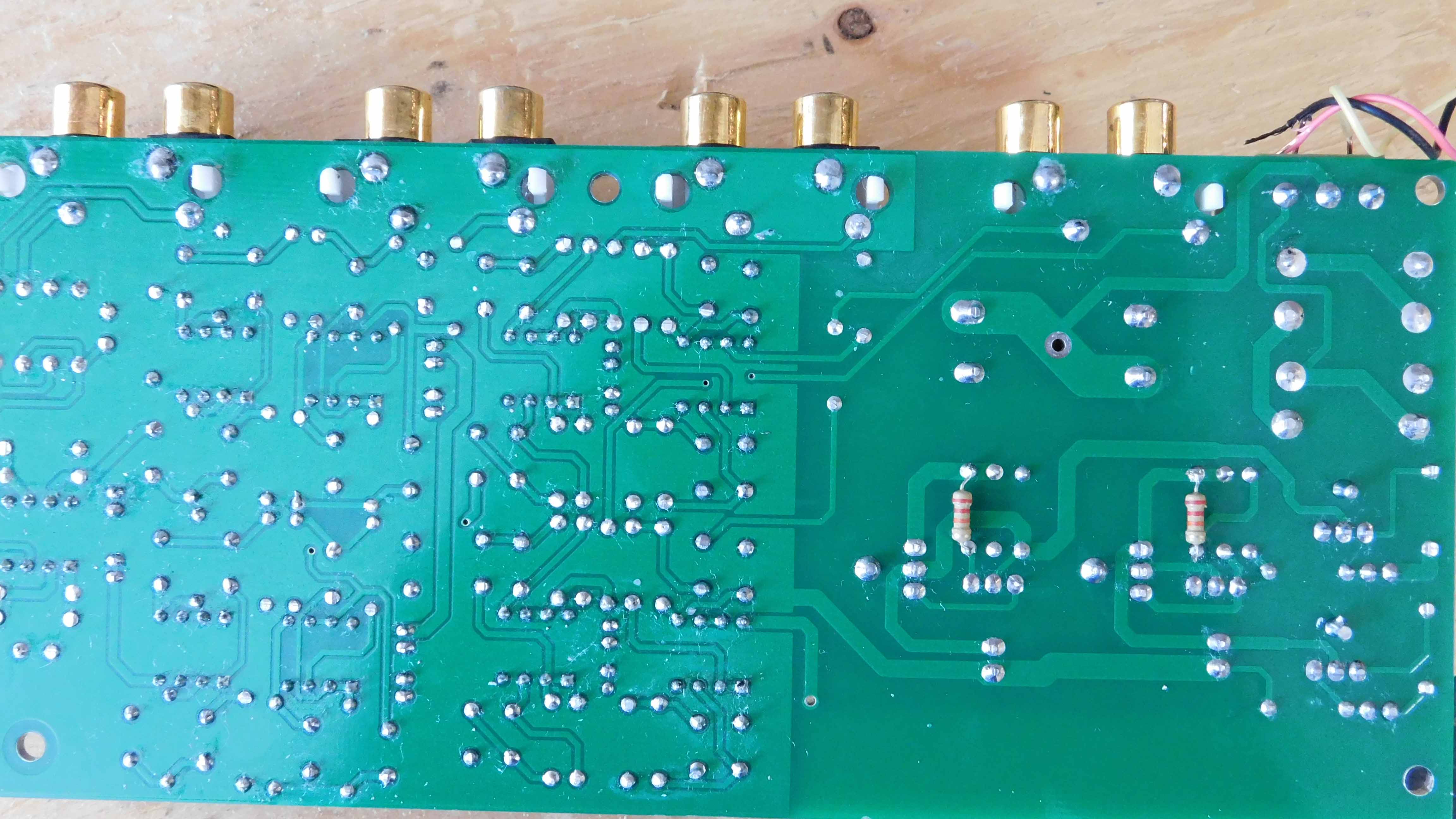

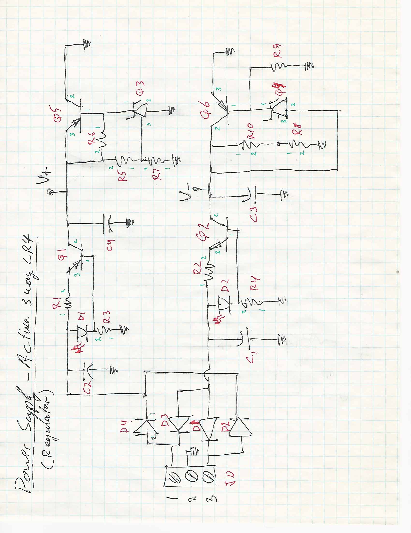

My configuration has grown alittle. I added P/S filtering and a second subwoofer controller.
They are simple filters and gain adjustments for my subwoofers.

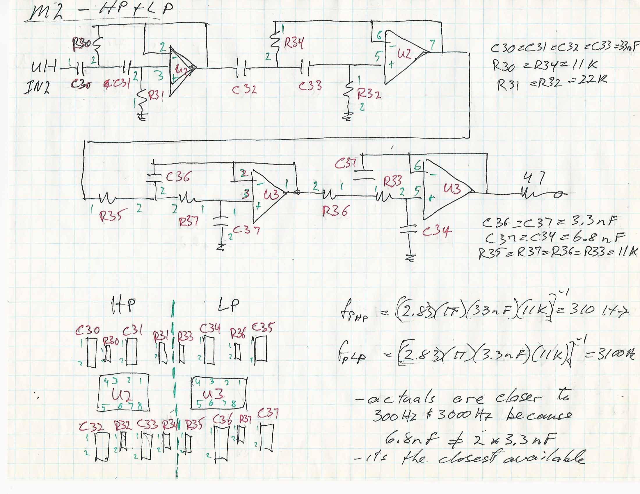

There is a fixed subsonic HP BW3@20Hz and fixed LP BW2@130Hz. The 2 pots are for variable LP BW2[20Hz-130Hz] and variable gain (0-20dB]. Phase reversal is done by swapping the amp connections to the subwoofer.
