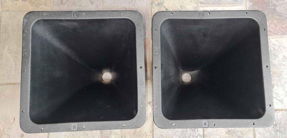

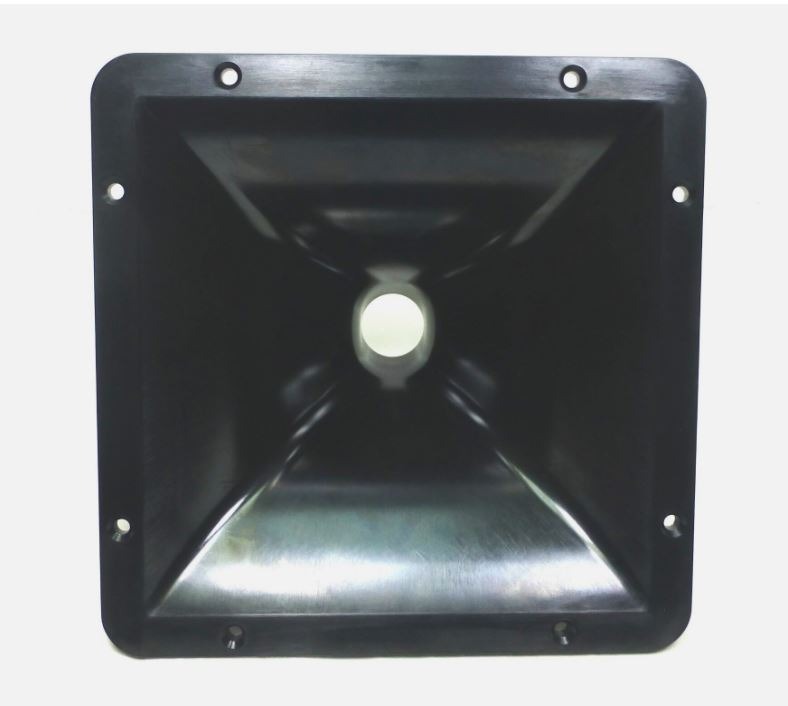

What about various 1.5" horns including JBL ones on the Bay?-the real problem is the lack of an inexpensive waveguide.![]()
https://www.ebay.com/itm/186196082867?hash=item2b5a26c0b3:g:-ZwAAOSwn8FlZSJv&amdata=enc:AQAIAAAAwM7hRQF8wPHU5O+G3ggXdCScFDMmQ7LBVII7FMzf3aoyNBJkS2m6yo1paV2lvrBD+kug2mwrr8c4rvX6oG10VS8KZ6BvaP8ENs
https://www.ebay.com/itm/3326100487...0TDtxs2YTE2jAZmqBEQZSi0bpIWAK/GuKnoFRUsKDftYY
https://www.ebay.com/itm/125951598616?_trkparms=amclksrc=ITM&aid=1110006&algo=HOMESPLICE.SIM&ao=1&asc=257779&meid=a4b4757967e0411ba675d31aea182ea1&pid=101875&rk=3&rkt%3

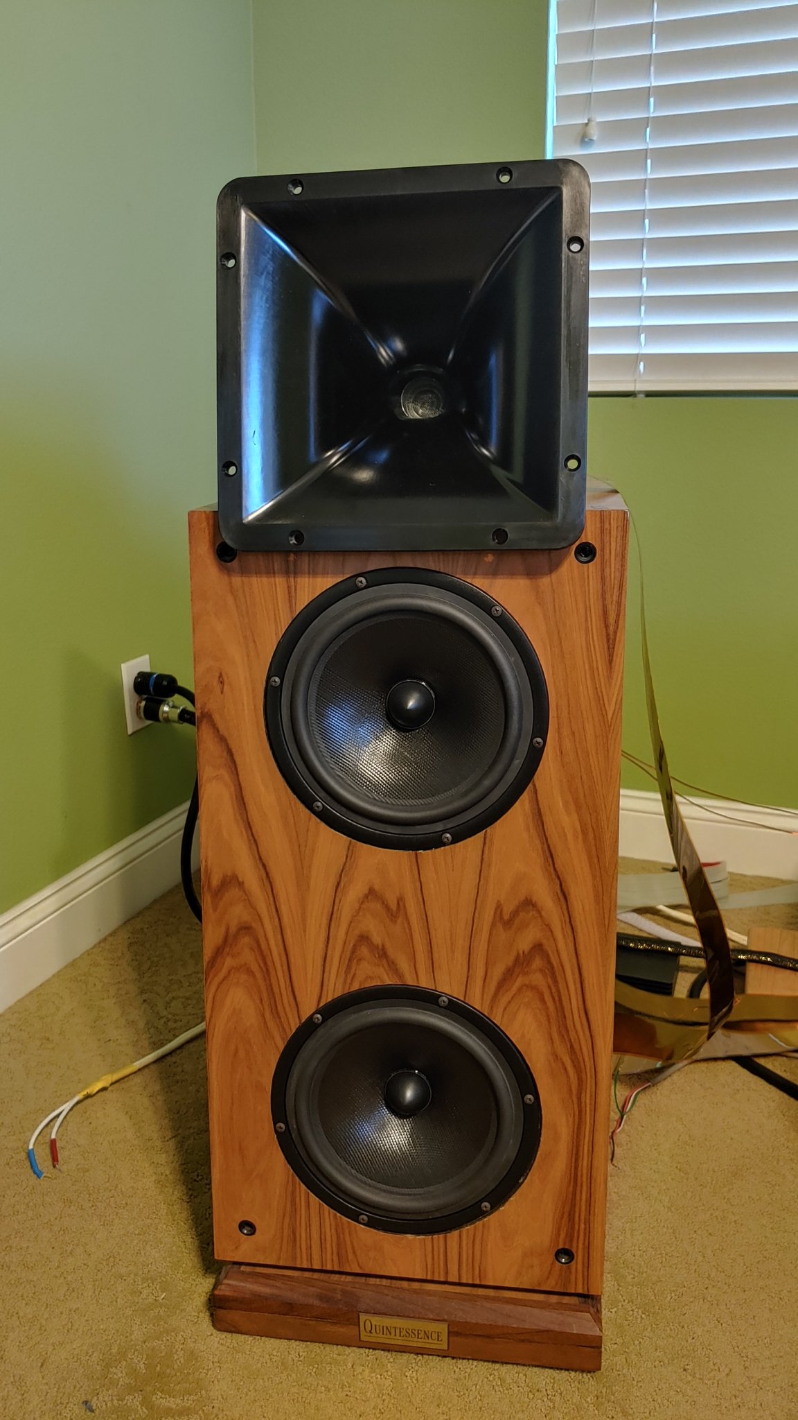

I use and like this one: https://reconingspeakers.com/products-page/jbl-horn-lens-5006815-stx825/280 Euro’s or 280 dollars (converted from Canadian dollars)
Nice thing about that horn is that if the room is small or close to side walls, rotate lens for 60 degrees horizontal……..for home use the 80/90 is really too wide. I’d LOVE to see a 60/40 or even a 50/50 lens for typical 8ft ceilings. JBL for their pro home cinema used to make the Syngergy 1400 which was only around 45 degrees horizontal and that system sounds amazingAnd I ordered the Lase horn 10.5x10.5"

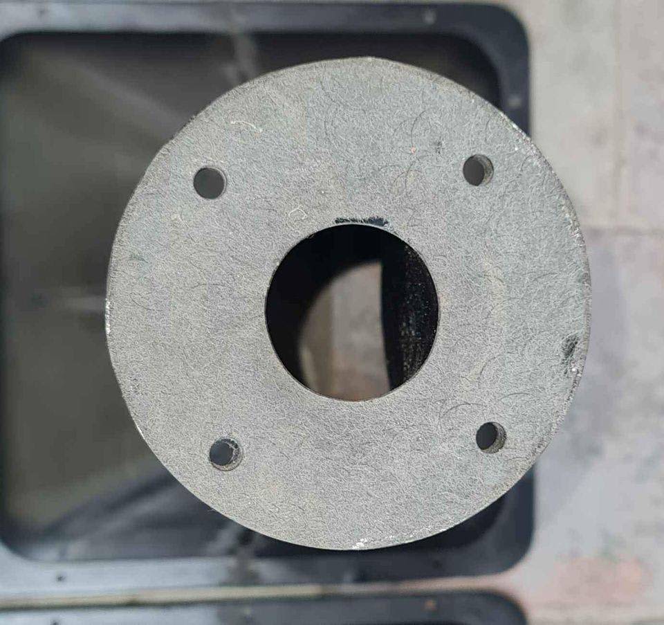

1“-1.3” entrance, not 1.5”.I use and like this one: https://reconingspeakers.com/products-page/jbl-horn-lens-5006815-stx825/
