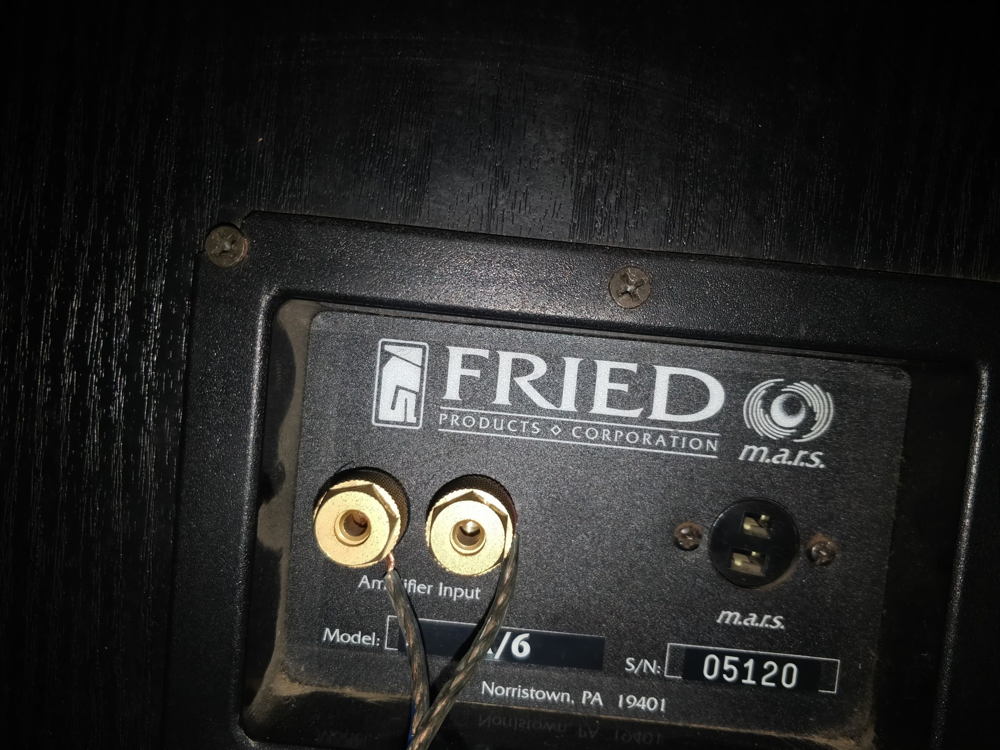

Hi Allen. The Mars socket - inside - has two terminals - one of which is connected to the + terminal of the speaker binding post, and the other is connected - to the -ve terminal of the speaker binding post. Additionally - the +ve wire is in two pieces, one end to the +ve speaker binding post and the other seems to be going UP into the speaker cabinet to the tweeter or woofer. Can't decipher without pulling apart the speakers.

On the subject of the MARS socket, this is the M.A.R.S tomfoolery from outside, the socket.
This is what it looks like from inside :
As you can see one of the + terminals [that connects from the amplifier to the speaker] is also connected to the + terminal of the Mars tomfoolery
And then the positive RED and the negative BLACK of the MARS cables are going up into the chassis of the speakers
as in here
Thanks for your help sir! cheers,
