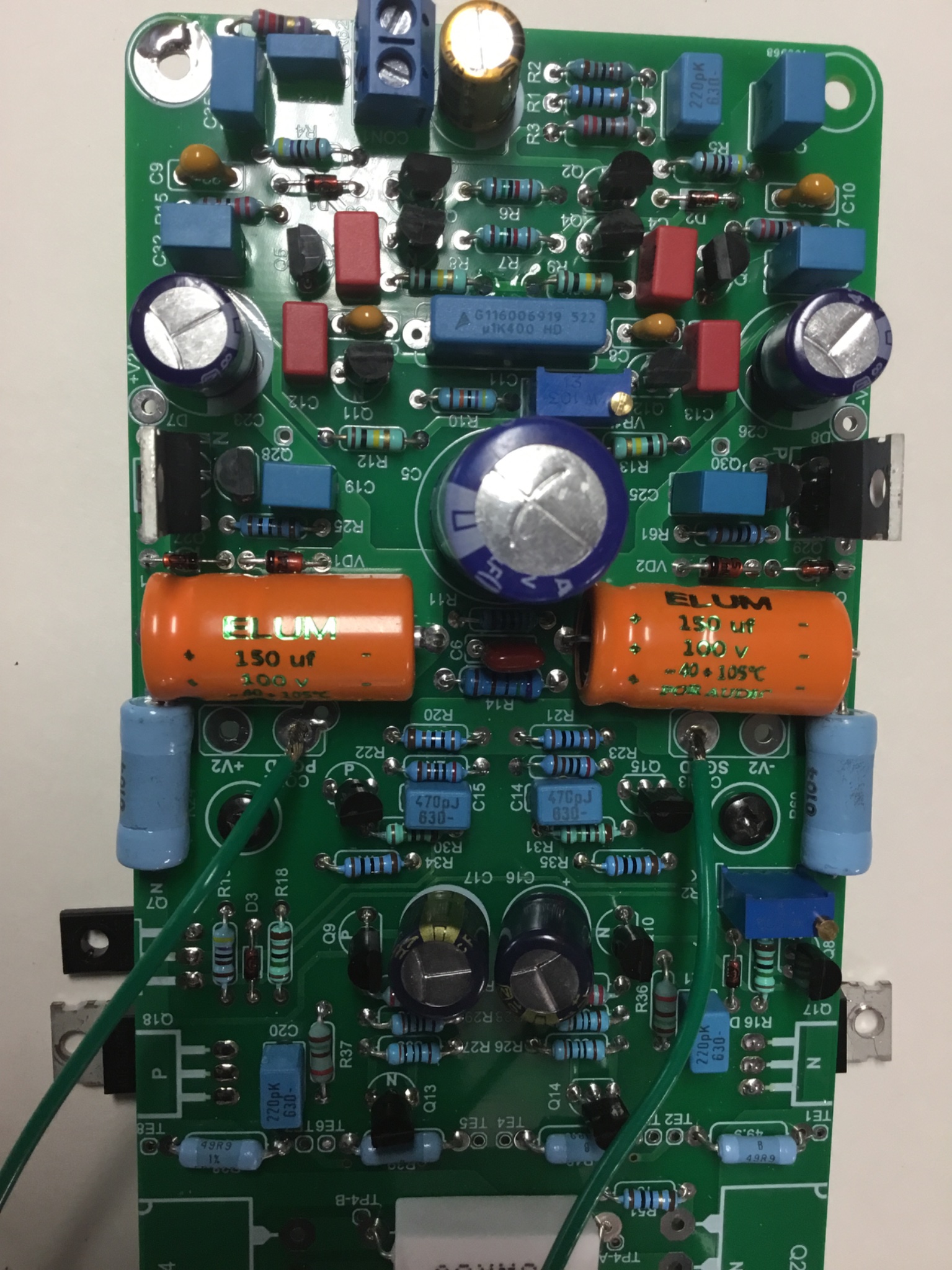

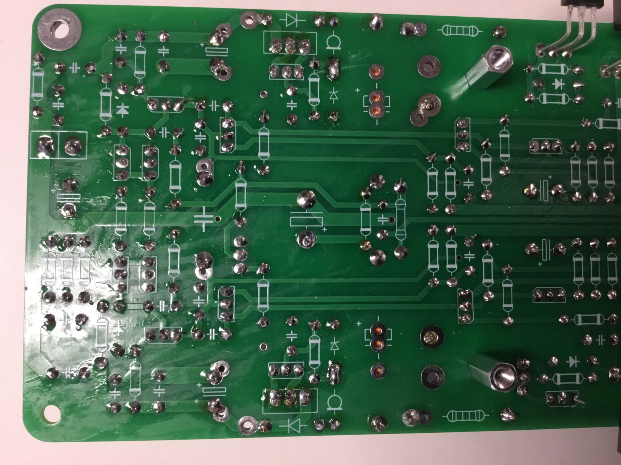

I’m about ready to give up on this project. Can’t get past the initial start setup. Both boards have -5.5 vdc on the output. I have 33 vdc, but neither vr1 or vr2 have any effect. I seem to remember another builder having this issue and never getting it resolved. Anyone have any ideas?

1. Check Power Supply Rails: Confirm ±33 V relative to ground on both amplifier boards. Make sure ground is properly connected to the center tap of the transformer.
2. Verify Potentiometers (VR1/VR2): Measure across the potentiometers to ensure they change resistance. Check if voltage on the wiper (middle pin) responds to adjustment.
3. Inspect Transistors: Double-check orientation and type (NPN/PNP) of input and VAS transistors. Reversed or incorrect parts can cause DC offset.
4. Measure Key Voltages: Measure base, collector, and emitter voltages on the input differential pair, VAS, and bias transistors. Compare with the schematic.
5. Compare Channels: If both boards behave identically, the issue may be with shared power supply or grounding.
Post clear photos of both sides of your PCB, especially around Q1–Q4, VR1/VR2, R11–R14 area.

Thanks for the response. The power supply is good and doesn’t seem to be the problem. My suspicion at this point is the transistors. I bought 50 of each and tested them all, but who knows whether they are counterfeit or not. I might order another set of boards and use 5401-5551’s, or just keep the power supply and use it in another project. Thanks again for the suggestions.
Not great pics…..best I could do. Since both of the boards do the same, seems like it has to be a component issue. I have 33 vdc on v2a and basically nothing after that.

Hi.. yes photos suffer from glare, vert hard to se area q1-q4.. could be helpful with better photos..Please confirm the pinout orientation of Q1–Q4. You're using BC550/560, which have a C-B-E layout, not E-B-C like the silkscreen might suggest. If inserted according to the PCB print, they may be reversed — and this would explain your -25 V on all bases.
2. Double-check R11 and surrounding resistors (R12–R14) for damage or bad solder joints. You mentioned R11 smelled burnt — that may affect feedback/biasing.
3. Measure voltages again after letting the board settle for 2–3 minutes with the bulb limiter connected. Focus on:
Vb Q1 and Q2
Voltage across VR1 and VR2 wipers
Voltage across R41 and R45
