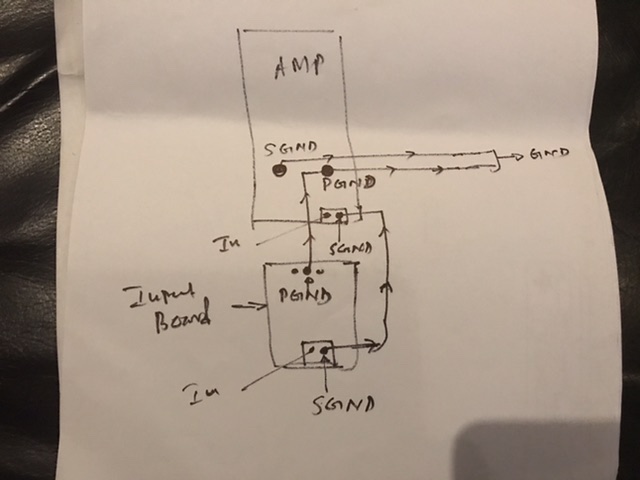

The input board has a PGND and an SGND, have you connected them together somewhere? You must do this if you're testing the input board by itself. I got caught like this. Otherwise follow the wiring diagram that comes with the documentation.

Thanks chalky...please check my final wiring diagram.

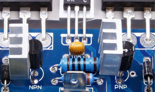

I calculate that Q5-6 are dissipating 370mW in normal operation so I guess that they would get pretty hot. 370mW is quite a lot for a TO92 package. If Q1-4 are cold, Q5-6 hot, and Q7-8 warm with SGND connected then I think this is ok ( assuming that you're using 150R and 2N5401/5551 for Q6/5 ). The 2N5401/5551 can dissipate 625mW ( as can the original PN100/200 ) but its not a good idea to run parts hot. The BC546C/556C can only dissipate 500mW so it would run even hotter. Must admit that I didn't notice how hot Q5/6 got on my input board. In the interests of device longevity I'd epoxy small heatsinks onto Q5/6. I'll poke around to see if I can find any better options for Q5/6.

Actually I think the 2N5401/2N5551 for Q6,Q5 is probably the best bet. They are cheap, readily available ( at the moment ), and although the free air dissipation is 625mW the collector dissipation is 1.5W. So heatsinks would definitely be a help for now. But as I said I don't really see why the vas current has to be so high; so when my new boards come I'll recalculate a few component values to see if I can get the vas current down without compromising the overall performance.

Epoxying heatsinks on doesn't sound like a good idea since the epoxy adds thermal resistance. In the past, there were clip-ons for TO-98s and similar.

If it runs hot it dies young. Physics fact. A thin layer of silver loaded epoxy has a very low thermal resistance - used for high power leds all the time. You can still get to92 clip on heatsinks but they're not very good because they are physically small and the contact area with the semiconductor is also small. The design that is being copied here is 30 years old and things have moved on a bit since then. Bryston themselves have improved on the 4B SST. Some of the parts that Bryston used are are unobtainium and so the most suitable modern equivalents must be found - and if necessary the circuit modified to accommodate them.

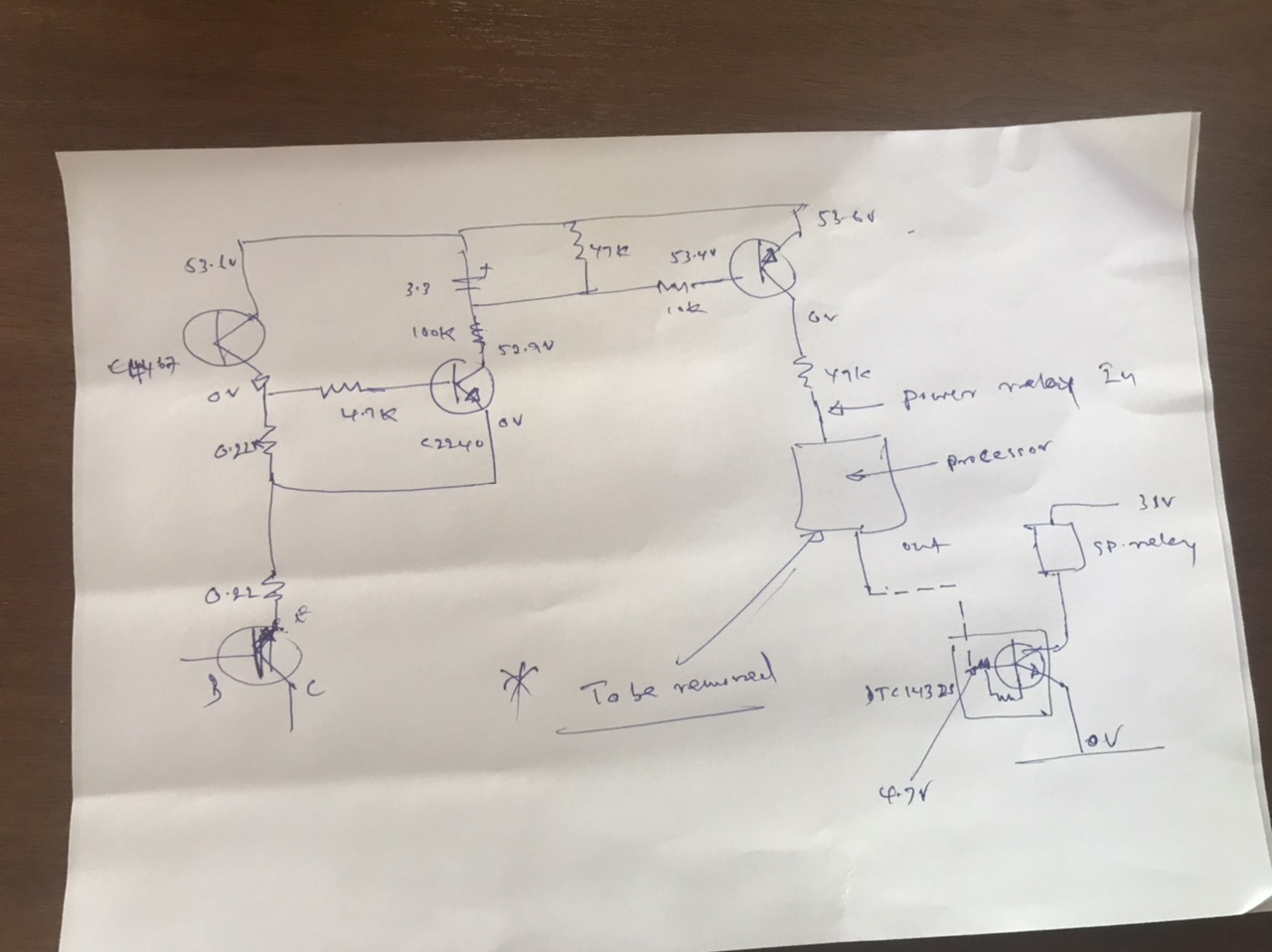

Hi chalky and other experts please do a favour for me.I have Yamaha V890 which having malfunctioning processor .i reconstruct amplifier part and enjoying with it.i want to switch on speaker protection relay preserving it protecting function so please redesign it in simple way without processor. Schematic is attached.(sorry this not related to topic)
