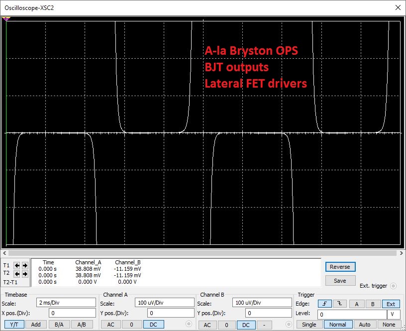

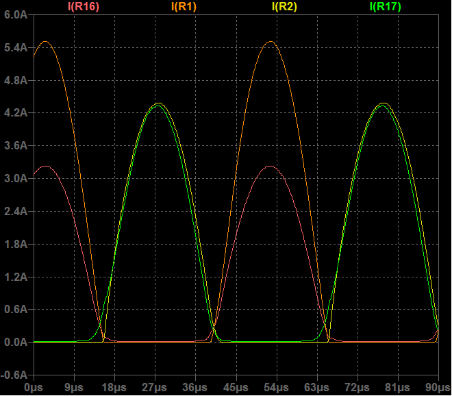

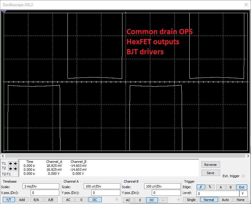

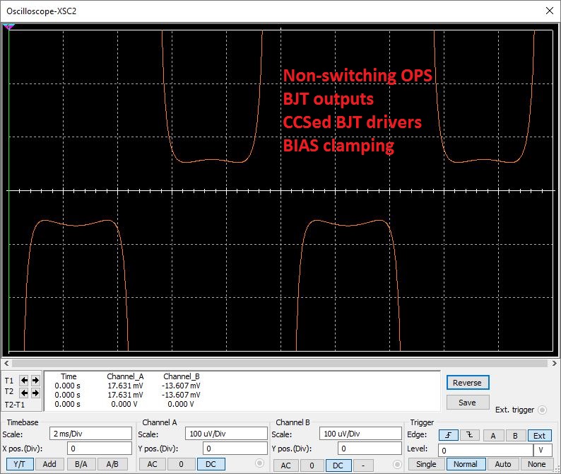

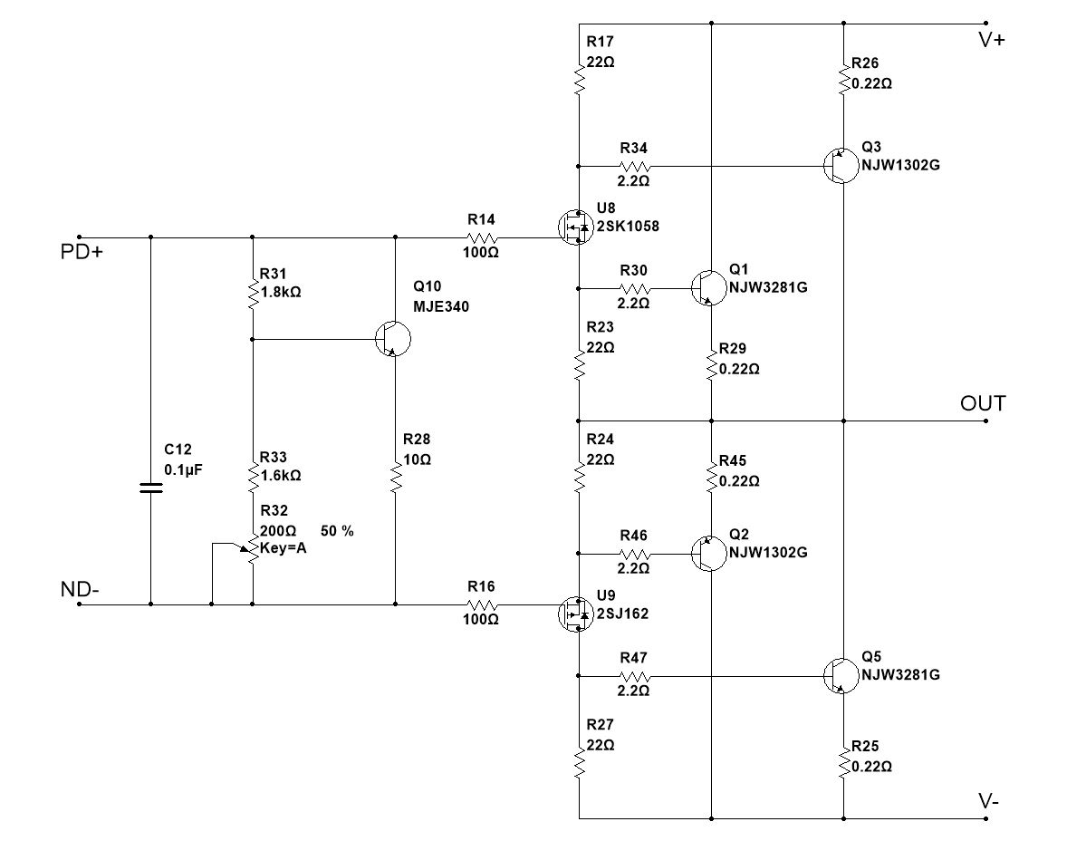

Gentlemen, a few observations I find rather interesting.
In a-la Bryston OPS arrangement with BJT drivers, the currents at both sides of the phase splitter are slightly different because of the base current of the phase splitter (emitter current is always slightly higher - you know that).
I decided to try using the Lateral FETs as phase splitters - not a new configuration, Lazy Cat used it long time ago - anyway, just curios, how it compares to the other arrangements, known as good ones. So - no gate currents, so the phase splitter is highly symmetric.
See the pictures:
1) First picture is showing the arrangement I simulated. Showing very solid performance - low distortion when biased properly (resulting in 62.5mA at idle per output device).
2) Collector currents of the output BJTs at the above arrangement (measured as voltage drop over the emitter resistors). Those currents drop down to zero (no surprise), however the corners are rounded enough.
For comparison:
3) Collector currents in the non-switching arrangement with bias clamping mechanism. Highest performance among all the options tested at higher frequencies.
Another good option:
4) HexFET based OPS with fast BJT driver stage, regular bias spreader, tuned-up for the tempco of HexFETs. Surprisingly, the drain current does not touch the zero line. I don't have any good idea why it stays just above it.
Another point - the corners are rather sharp, much sharper than the ones with BJT outputs.
The last two options are live-tested, showing excellent performance.
I'm going to try the 1-st one as well - simulation looks promising.
Valery

Nice work Valery😉
I will try the FET version but with LTspice and VDMOS models, this should be more accurate because it includes sub-threshold conduction and capacitance modulation.
Sub-threshold may round-off the sharp corners you noticed.
Best wishes
David

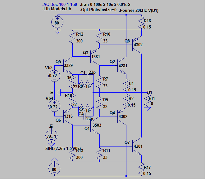

I can't get excited about the full blown Bryston .. but if you can make "a decent amp with no IPS or VAS", I'm really interested. 😱
Please post your ASC for this.
OK, here is a first cut, with no attempt to match Vbe or hFE.
It's just over 1 V rms input and over 300 W output.
Distortion @20 kHz is 0.087 % mostly 2nd and 3rd.
Like you, I don't usually carry on about harmonic profile, just make it utterly inaudible, but 0.08 % is more than my usual so I checked it's OK.
Note the currents are not evenly shared on one side due to mismatch, this could obviously be improved but what is noticeable is that the distortion is still decent.
Maybe continue this in my current drive thread so as not to hijack this one.
Best wishes
David

My simulations show:
- Follower with LatFET drivers - pictures 1, 2 in my previous post - THD 20 = 0.07% (20V RMS @ 8 ohm);
- Non-switching OPS follower - picture 3 in my previous post - THD 20 = 0.03% (20V RMS @ 8 ohm).
Valery
Valery, my THD conditions were similar to yours except 50V RMS.
David, I'm just thinking... we should have probably used some way of driving the OPS, closer to VAS output conditions (high output impedance), otherwise we loose such source of distortion, as input impedance modulation (including input capacitance modulation) of the OPS, especially relevant to the version with BJT drivers.
Two voltage-controlled current sources and a simple bias spreader, shunted to ground with 1M and 10pF on each side, would model conditions, close to VAS output ones, I believe.
Valery

Guru Zan, could you post your transistor models please.OK, here is a first cut, with no attempt to match Vbe or hFE.
