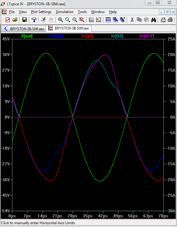

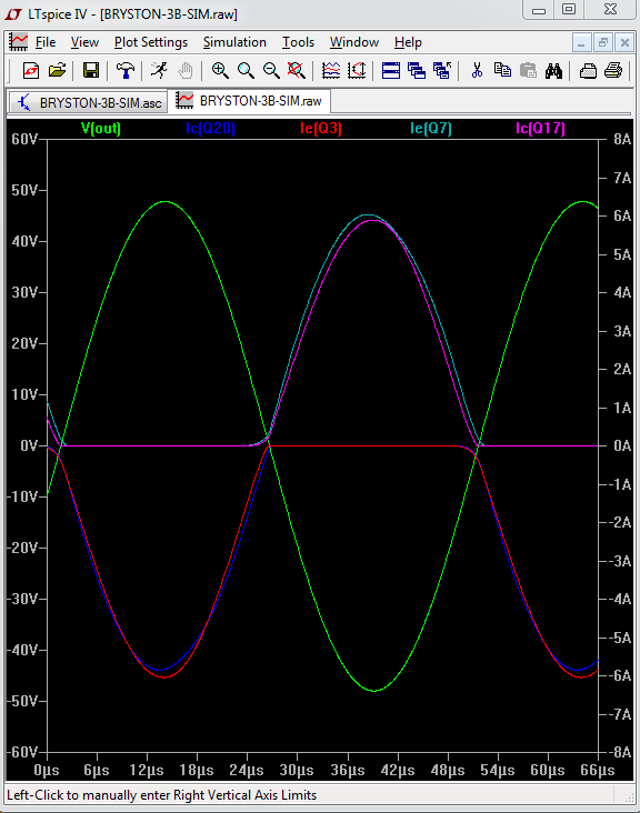

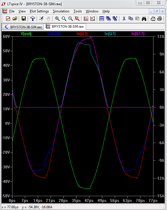

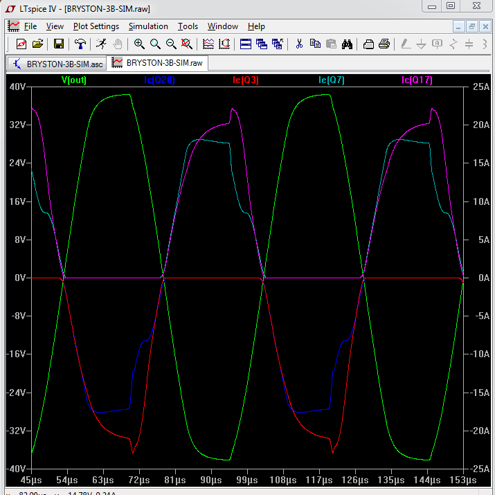

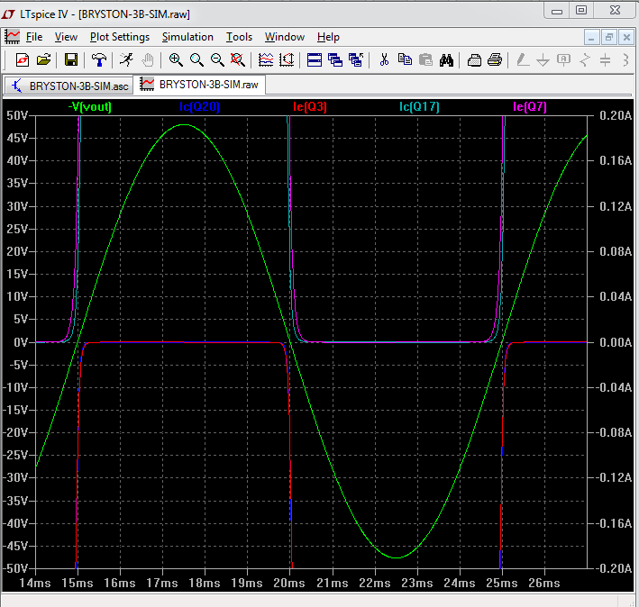

Gentlemen, a few observations I find rather interesting.
In a-la Bryston OPS arrangement with BJT drivers, the currents at both sides of the phase splitter are slightly different because of the base current of the phase splitter (emitter current is always slightly higher - you know that).
I decided to try using the Lateral FETs as phase splitters - not a new configuration, Lazy Cat used it long time ago - anyway, just curios, how it compares to the other arrangements, known as good ones. So - no gate currents, so the phase splitter is highly symmetric.
See the pictures:
1) First picture is showing the arrangement I simulated. Showing very solid performance - low distortion when biased properly (resulting in 62.5mA at idle per output device).
2) Collector currents of the output BJTs at the above arrangement (measured as voltage drop over the emitter resistors). Those currents drop down to zero (no surprise), however the corners are rounded enough.
For comparison:
3) Collector currents in the non-switching arrangement with bias clamping mechanism. Highest performance among all the options tested at higher frequencies.
Another good option:
4) HexFET based OPS with fast BJT driver stage, regular bias spreader, tuned-up for the tempco of HexFETs. Surprisingly, the drain current does not touch the zero line. I don't have any good idea why it stays just above it.
Another point - the corners are rather sharp, much sharper than the ones with BJT outputs.
The last two options are live-tested, showing excellent performance.
I'm going to try the 1-st one as well - simulation looks promising.
Valery

Nice work Valery
I will try the FET version but with LTspice and VDMOS models, this should be more accurate because it includes sub-threshold conduction and capacitance modulation.
Sub-threshold may round-off the sharp corners you noticed.
Best wishes
David

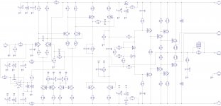

I can't get excited about the full blown Bryston .. but if you can make "a decent amp with no IPS or VAS", I'm really interested.
Please post your ASC for this.
OK, here is a first cut, with no attempt to match Vbe or hFE.
It's just over 1 V rms input and over 300 W output.
Distortion @20 kHz is 0.087 % mostly 2nd and 3rd.
Like you, I don't usually carry on about harmonic profile, just make it utterly inaudible, but 0.08 % is more than my usual so I checked it's OK.
Note the currents are not evenly shared on one side due to mismatch, this could obviously be improved but what is noticeable is that the distortion is still decent.

My simulations show:
- Follower with LatFET drivers - pictures 1, 2 in my previous post - THD 20 = 0.07% (20V RMS @ 8 ohm);
- Non-switching OPS follower - picture 3 in my previous post - THD 20 = 0.03% (20V RMS @ 8 ohm).
Valery
Valery, my THD conditions were similar to yours except 50V RMS.

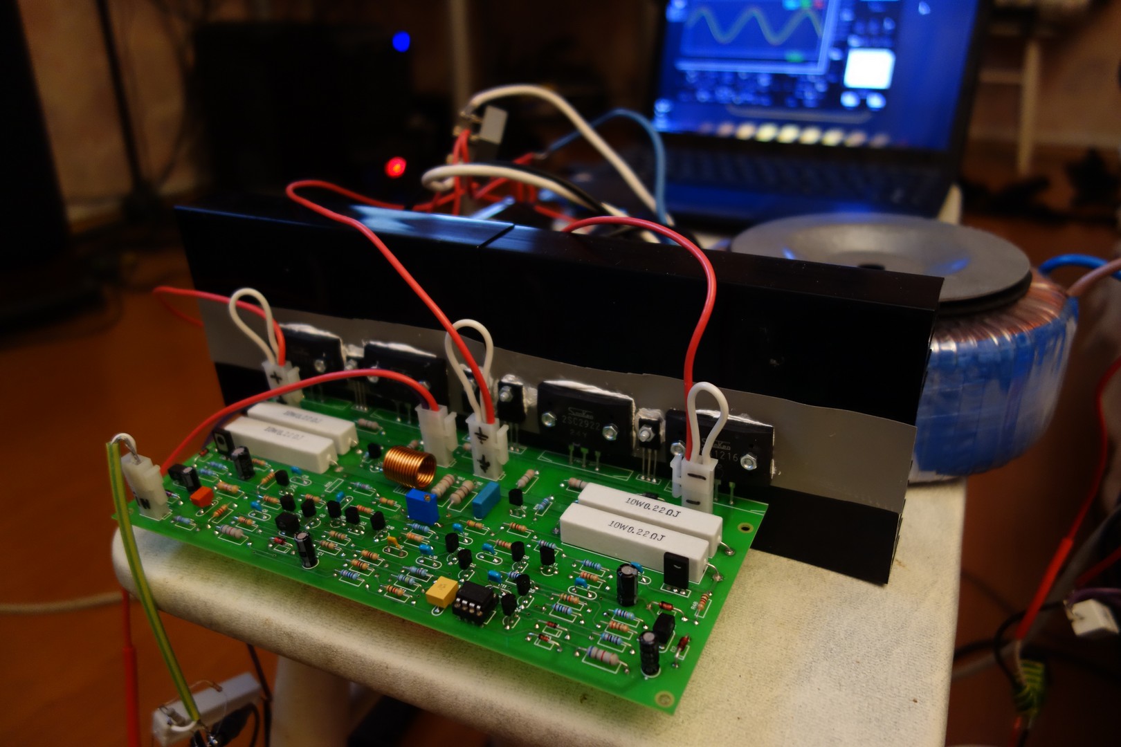

Hi Dan,
A very valid point - a few considerations though.
I normally try to design the power amplifier in a way that clipping happens in the VAS stage, allowing much faster recovery. This approach leads to somewhat reduced energy efficiency (OPS rail voltages are higher than they could be), however nice clean clipping is worth sacrificing some efficiency, I believe.
In my experimental prototype, I used C2922/A1216 outputs and C4382/A1668 drivers (Sanken). Those drivers have got twice as much ts, comparing to the output devices, however I did not have any issues, abusing the prototype with hard clipping, square waves up to 1MHz, etc. With lateral FETs as the drivers, there seems to be no issue at all, as you just mentioned.
I had a rail-to-rail shoot through in the other prototype with rather conventional EF3 arrangement and MJ21193/94 at the output, running a sine wave sweep 100Hz-1MHz - at around 300-500KHz the OPS has self-destructed.
I don't know their ts value, but it looks like it's higher for about an order, comparing to the modern RET devices.
Valery

Guru Zan, could you post your transistor models please.OK, here is a first cut, with no attempt to match Vbe or hFE.
I'm trying to replicate your results. I'm assuming the Cordell models are OK but what do you use for 3329 & 1316?
Firstly, my apologies for not getting back sooner.
First used in Thomas-Patterson 1979-1982
Differences between this and Bryston;
Opted for simpler compensation so as not to tie the Vas to output power rail trash.
Just MJE15028/29 drivers with 2N3773 / 2N6609 outputs. Circuit values were appropriate for the circuit topology.
Use of reverse bias protection diodes where required.
Sharp knee current limiter combined with a voltage clamp on the output.
Spice does not model storage times or there be more than a few vehemently complaining about the nasty clipping characteristics of this output stage.
Cheers Dan
Didn't I send you them, included with the IXYS FETs?
In any case, this was just a quick draft to look at the concept, the precise values don't matter, should have similar behavior with more or less equivalent transistors in each section.
Actually that would be informative in itself, try "home brand" transistors and see how much it needs to be tweaked.
If you don't have the inclination to fiddle with it then I can resend my models.

- Bryston 3BIII SPICE Simulation - Current Sharing and Output Stage
