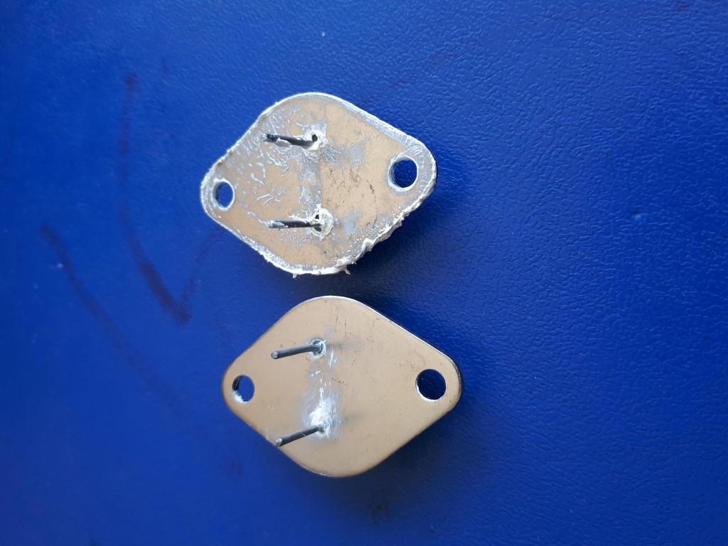

1/ Removed 2 shorted TO-3: no sign of over heat, is it good or bad signs (maybe caused by something else...)

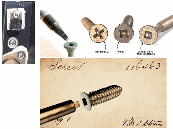

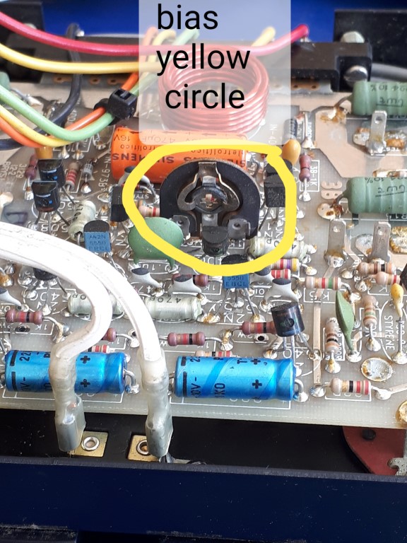

2/ Bias, look like a circle thingy (picture attached) and to be adjusted by phillips screw driver, is it the right one?
These type of transistors usually don't look any different when they have failed, remember that you should replace all 4 TO3 transistors. Yes that is the bias adjustment potentiometer, a small flat screwdriver works well for adjusting it. Here is the official Bryston procedure for testing and biasing the amplifier:

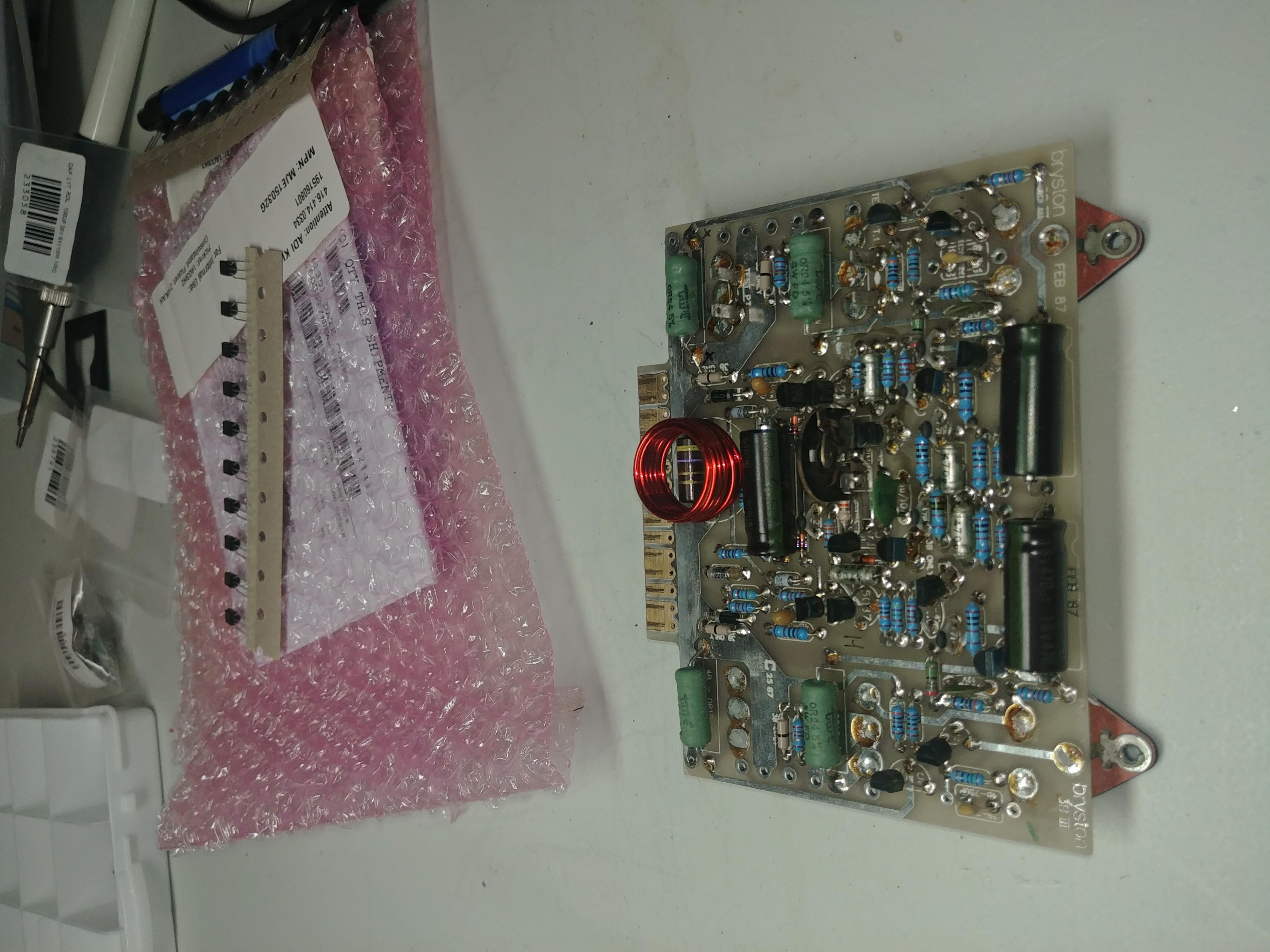

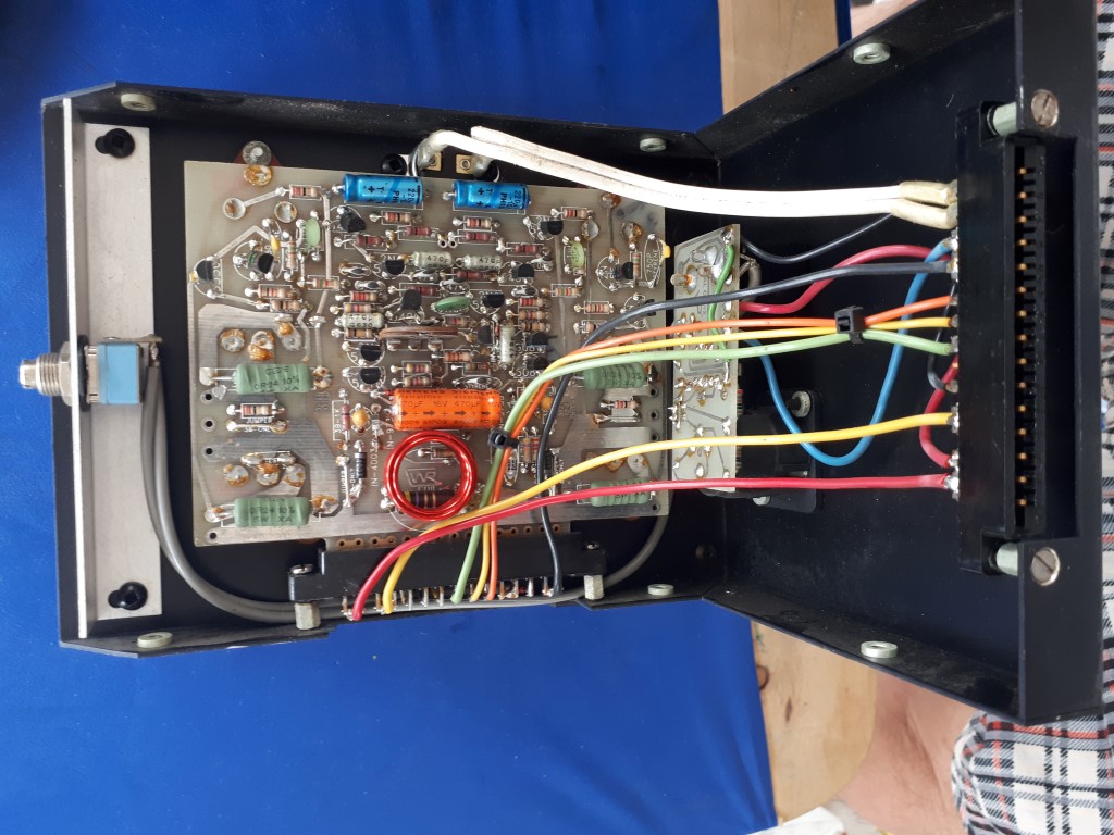

I serviced one of these amps a few months ago. The lousy carbon bias pot on one channel was toast and took out not only a pair of outputs,but a driver and the bias transistor as well. The bias transistor is bolted under the pcb. Check it as well. It's the mje182.
Replace the trimpot with a cermet type and I suggest you replace on both channels,because sooner or later these will fail. By the way I used MJ15003/4 and MJE15034/35 for the drivers.
Gosh, I hope not -- their condition is plainly visible. If it needs a squirt of Cramolin, you don't have to struggle to get it in.
Yes, and it's a design that I consider (my humble opinion) improper: Intermittent wiper opens the bias -- maximum current through all succeeding stages. I alway fit the trimmer shunting the BE junction so when it goes open you get very low bias. Horrible crossover distortion is better than smoked drivers and outputs.

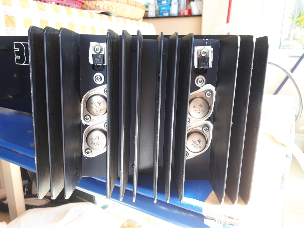

- I can't think of any good reason - from a layout standpoint - for the outputs to be polarity-paired diagonally, which is what your 2nd pic, original post shows

Yup -- Whoever installed those outputs put 'em in wrong!
The PNP's (orig(*) 2N6609) should be in the two positions toward the front of the amp. The NPN's (orig(*) 2N3773) should occupy the two locations toward the rear of the unit. Furthermore, since these modules are 'ambidextrous', the left channel is exactly the same layout.

Umm .. sorry, but I don't see how the working channel could be (the same as the dead right channel) -- without a fair amount of diagonal cross-wiring -- the driver is up at the top (module in 'right channel' position as you face the front of the amp), and each serves a pair of outputs. The 0021's should both be together under their driver; the 0022's together under theirs.
Cheers
edit: Yup, I've now checked it seven ways from Sunday, including on my 4B, and the outputs are paired-up vertically, each pair having its own personal TO-220 driver.
