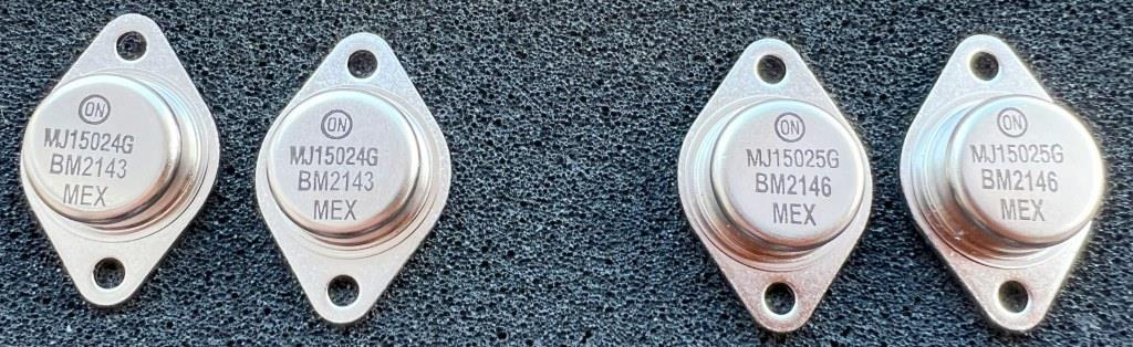

Now I bought another one to restore, however this one is more broken...... blown fuse on one channel,, with one dead output power transistor (2N6609) and it's complimentary is suspect as well (2N3773).
I purchased 4 new MJ15025
...and 4 new MJ15024, as replacements for both channels. Only two of each will be needed.
Question, is matching the power transistors very important ? or can I rely on the matching of the (original Bryston) pre-stage low power transistors, for acceptable DC offsets ?

This symptom looks identical to what I experienced restoring my Bryston 2B, in my case I suspect it was the two power supply capacitors that had deteriorated over the years resulting in an unbalance in the DC power supply rails which caused the output power transistors to fail, along with the blown fuse.
Fortunately though it was straightforward to repair, as documented in the report "Bryston 2B Power Amplifier repair - Hints and Lessons Learned".
https://www.audiocircle.com/index.php?topic=184949.0
The complementary MJ15024G / MJ15025G sets I purchased had similar manufacturing batch numbers and didn't worry too much about matching the power transistors.
In fact, I did not need to make any adjustments to the DC offset as documented in the related report "Bryston 3Be Power Amplifier - Adjusting and Minimizing DC Offset". https://www.audiocircle.com/index.php?topic=188637.0
