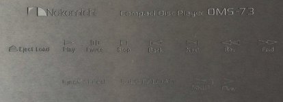

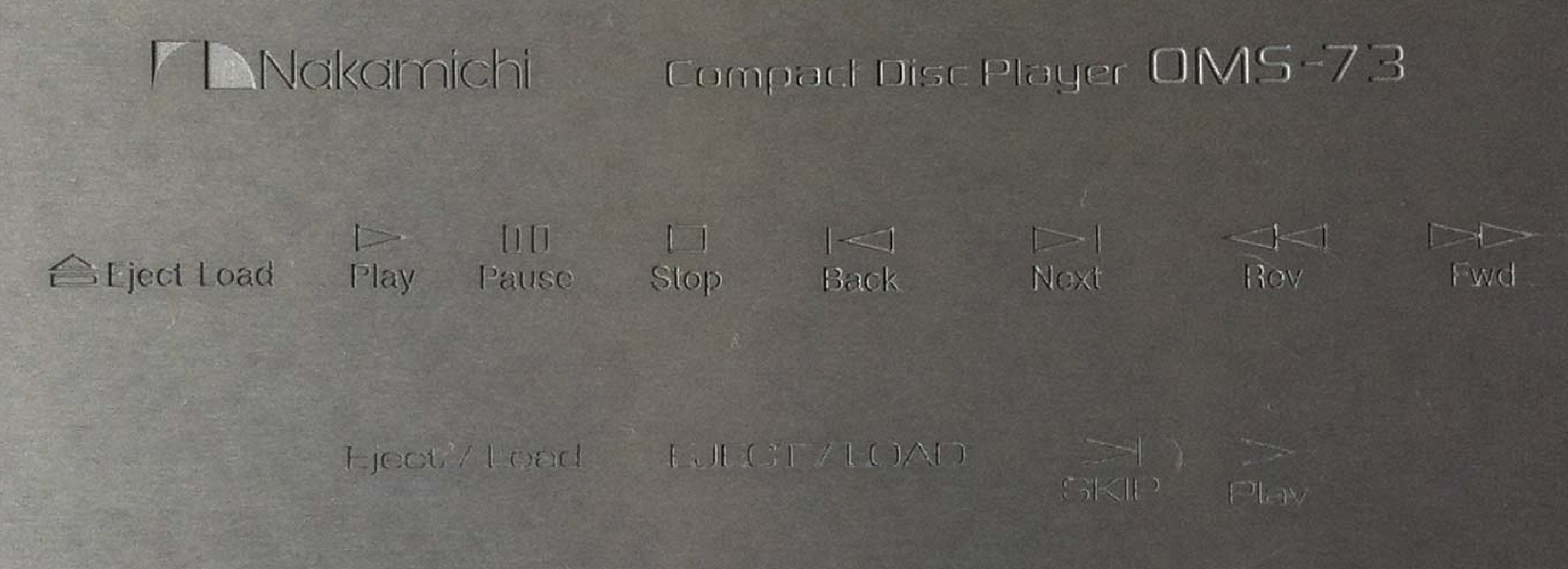

BTW, engraving letters: This is laser engraving in aluminium 6060. Normally the laser only changes color of the alloy
but in this saample tha laser is strong enough to mill away the material, like a needle in classical engraving
I did use Nakamichi-Fonts and design as reference. Goal of the test wa wether the engraved letter would change the
brushing. Depth of the engraving was about 0.3mm, width of lines about 0.2mm. So the letters were not bigger than with ordinary silk printing,
with letters of 2,5mm size.
But the anodizer ruined this sample... dseethe stains and chalk-like residues? 😱
