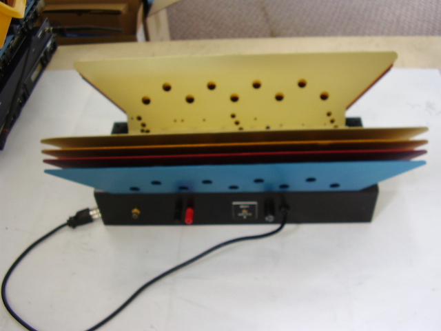

The anodizer I use locally is "Pittsburgh Anodizing" I think their minimum is $75.00. I think their charge is around $.035 per square inch.
They use a black dye from Sandoz to get the color they like that does not easily fade even in sunlight. This is a cosmetic anodizing with a thin anodized layer. For the "Thick" the aluminum self colors. That means it really is the alloy that determines the final color.
The process they use is light anodize, dip in color tank and then into a sealant tank. They also do a few other colors.
Brushing is a different matter. Most folks just use a belt sander with a 120 grit belt to carefully brush the surface. Some just sand by hand on the bare aluminum. I used to have a flap wheel sander not too dissimilar from a "Time Saver" but lost it in a flood. I usually sand the entire aluminum panel before punching, cutting it etc.
Attached is an amplifier I built with their anodizing. (Very low resolution! Old picture, old camera.)

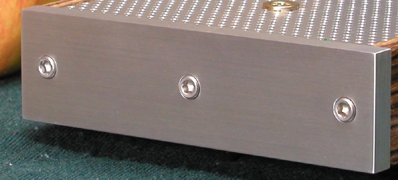

This is a sample I got, from a German company.
I did provide the plate, the AlMg3 mentioned
Shiny, but not well brushed. See the "gepunktete Bürststriche",
the dotted lines?
The same plate, another german anodizing company:
Crap. The "graue Schliffriefen", the grey sandings grooves behaved like chalk. Probably not sealed after anodizing.
Again the same plate, third german anodizing company:
The gloss is acceptable but are this really straight lines?
I doubt anyone who brushes himself as a DIYer would be satisfied with this...
The following is what I saw from the Korean company Pavonine @IFA german consumer electronics fair.
Aurender and probably Samsung are their customers
A close up, also Pavonine, nice:
Did not get this perfect finish from any sanding shop and anodizer in my country yet.
