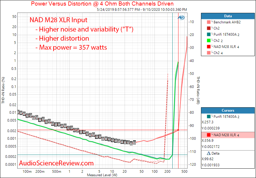

Looks like Nad’s 1ET400A power amp implementation adds 18dB of distortion and noise to the Purifi module. They might need to hire George to get it right. 1w/1khz 4 ohm THD+N comes in at -90.45dB.
