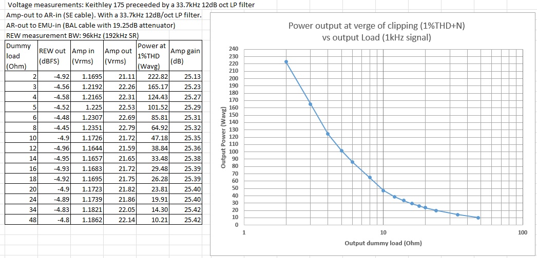

Living in my very limited experience world (*), I was surprised reading your “Class-D's Achilles heel” in post #7, that’s why I asked. But I don’t think that you have provided any convincing evidence that class D do have inherent issues with driving low Ohmic loads.
IMO that capacity is mostly to be attributed to the PSU sourcing the amplifier, rather than to the amplifier itself (assuming proper heat management).
In any case, apologies for the off-topic post.
(*) I had in my mind the recent testing of my old 41Hz Truepath amp which didn’t show any particular indication of losing steam (attached).

George if you make the power axis linear you should get a straight line to support your statement.

Jan, no statement. Just home made measurements. Easy to look up the table for 2,4,8,16 Ohm/power series, or the 3,6,12,24 Ohm/power series.
I have some more class D amps here that I will check in due course (all cheap units, not those that enter Stereophile’s Labs)

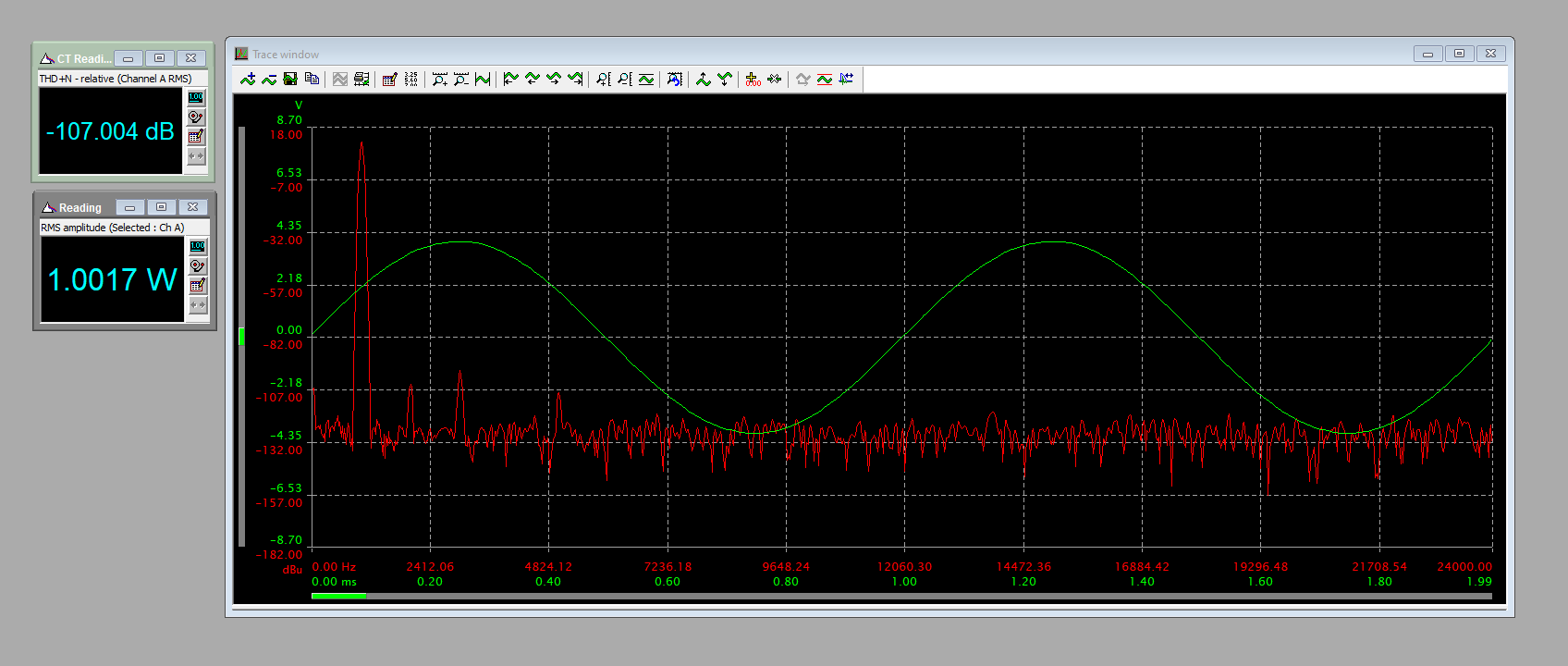

The NC1200’s are 11 year old technology now. Try a proper Purifi amp build. This is how a proper Purifi 1ET400A amp measures at 1w/1khz with a proper input buffer in the signal path. In fact this is also with the DAC and Preamp stage in the signal path as well.

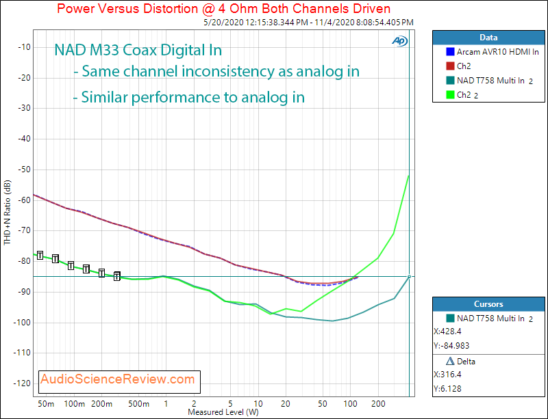

NAD shouldn’t be used as a reference point for Purifi either. Their M33 streaming amp only has a THD+N @ 1w/1khz of -85dB though the digital inputs! Waste of the amp modules. I’ve beat them by 22dB with my build.
