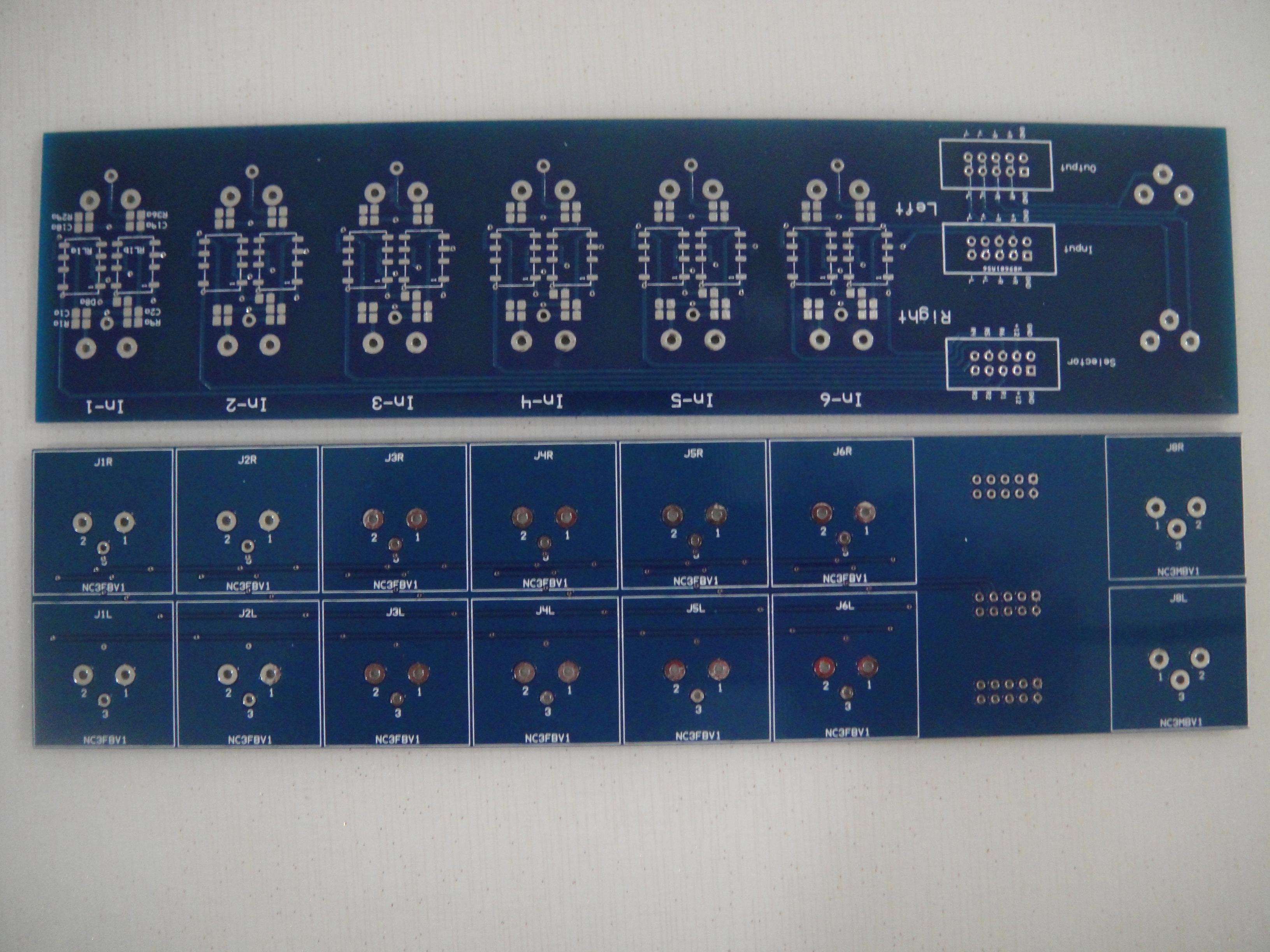

I open this thread to propose the 6 inputs board for the Bruno Putzeys preamplifier and understand if there is sufficient interest to start a GB.
I designed this board for my own Bruno preampli. I need more than 2 inputs and I want also a rotary switch in the front panel with a LED indicating the input selected.
The 6 input board measure 216 X 53 mm and the switch board measure 50 X 42 mm
To use the input board the following components should NOT be installed in the Bruno preampli:
- R1 – R9 – R11 – R18 – R29 – R36 – R38 – R45
- C1 – C2 – C3 – C5 – C18 – C19 – C20 – C22
- D8
- K1 – K2
Each one of the 6 input use the same parts. You can also use less inputs, just avoid to populate the parts and use a proper selector
So, in the input 1 you should solder:
- R1a – R9a – R29a – R36a (b, c, d, e, f for the other inputs)
- C1a – C2a – C18a – C19a (b, c, d, e, f for the other inputs)
- D8a (b, c, d, e, f for the other inputs)
- RL1a – RL2a - I changed the relays ID because they are different from the Bruno BOM. The new relays is the G6K-2F-Y 12VDC
I am lazy guy, so in my board I mark in the silkscreen only the input 1 as the others are identical but I will mark all the other parts in your board 🙂

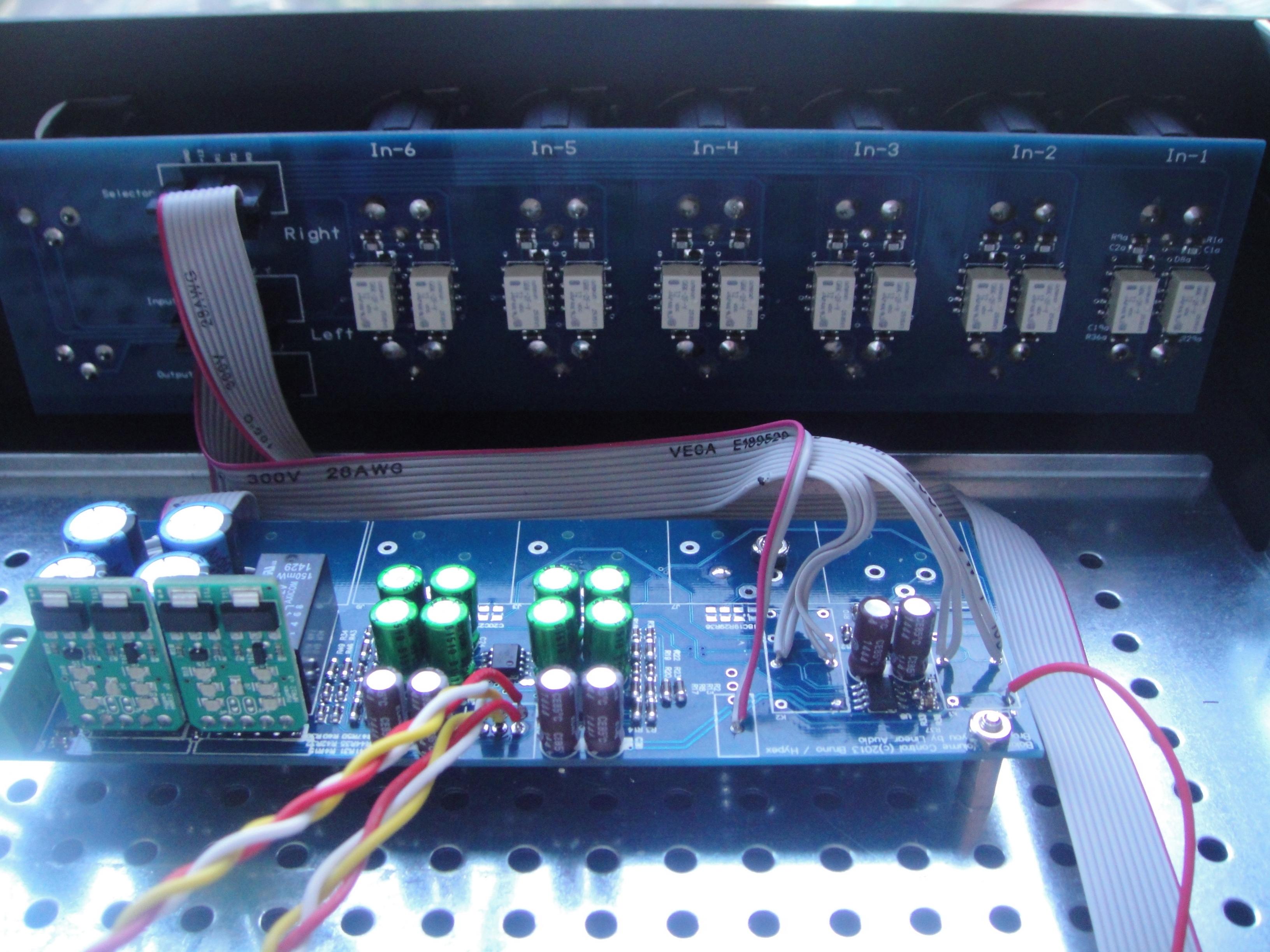

The board have 3 connectors for ribbon cables 10 pins:
- Selector – To be connected to the selector board with a ribbon cable F/F. The function of the pins is clearly indicated. The relays are powered with the +12V as common fix connection and the GND is switched to activate the input.
- Input – This to be connected to the Bruno board in the central pads of the K1 and K2 that are not installed. The L+, L-, R+ and R- are clearly mentioned in the silkscreen of the board
- Output – This to be connected to the pads of the J2 and J8 that are not installed

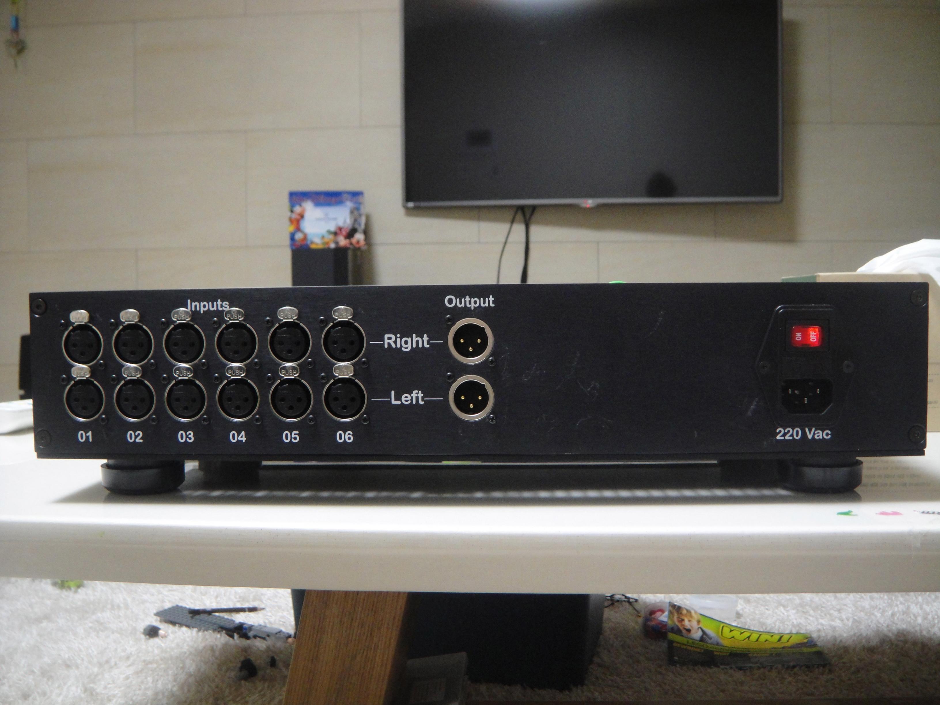

In the board are allocated all the input and output XLR connectors. The board is designed for the NC3FBV1 for the inputs and the NC3MBV1 for the output. They have the screws that mating connector shell to pin1 and front panel as required, are easy to be installed in the panel after soldered, are available in Mouser and are not really expensive.
The most difficult part for me was to found the correct screw for the connectors. Finally I found a shop that have the correct one, if are interested let me know and I will include them in the bag.

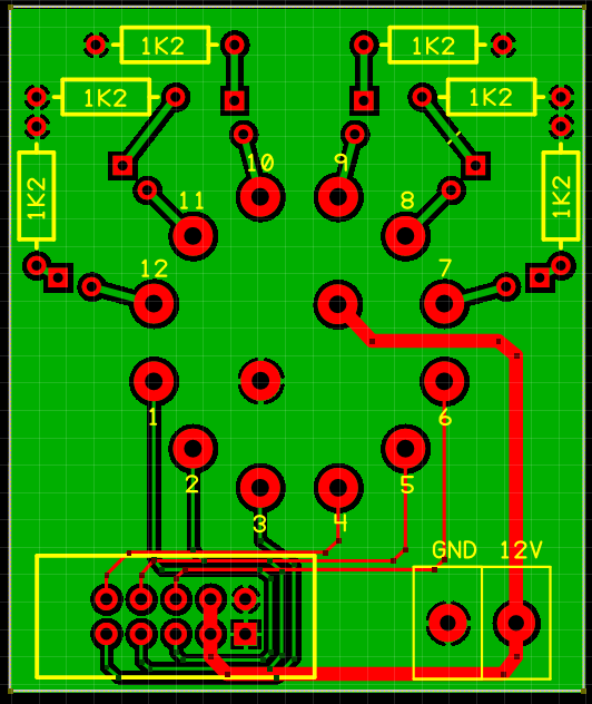

I also designed (but not yet realized) the input selector board that is connected to the input board through a ribbon cable. That will make easy the installation and the connection with the input board. I choose a normal rotary switch from e-switch KC-26-A-30.0-01-N-L-S available in Digikey and Mouser. Is not so expensive and make nicely his job
In the selector board there is the connection for the +12V that is needed for the relays and LEDs and can be taken, as I did in my preampli, in one of the K1 or K2 pads where the +12V are available
I attached the printout for the rear panel drilling that match the PCB and the printout for the front panel drilling for selector and LEDs.

Hi Do,
The 10 ribbon cable just send to the preampli board the 4 signals (L +&- and R+&-) plus the GND. The switching is done in the input board. In each input there are 2 relays engaged by the selector.
I hope it's clear 🙂 I will post a schematic as soon I am back home
