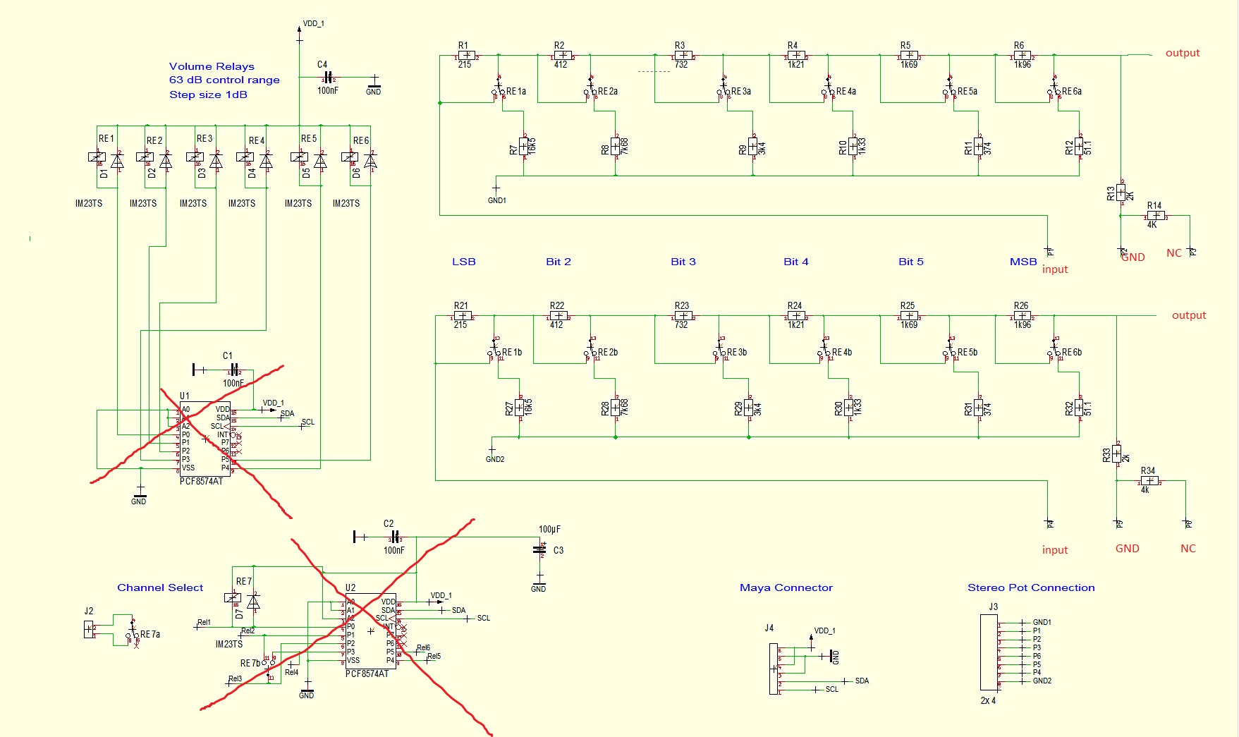

Just in case someone else wants to add a subwoofer to a system, using the BPBP as main preamp, you can do as I have done in order to avoid the extra cost of another BPBP :
Just get another VolCB, leave the two IC´s out and connect the relay spools parallel to the relay spools of the main VolCB and modify it as the attached schematic. Follow it by an opamp buffer (evt. with gain).
You could also mount the second VolCB with all the components and connect the control input in parallel with the main VolCB input and of course not parallel the relay spools then!
