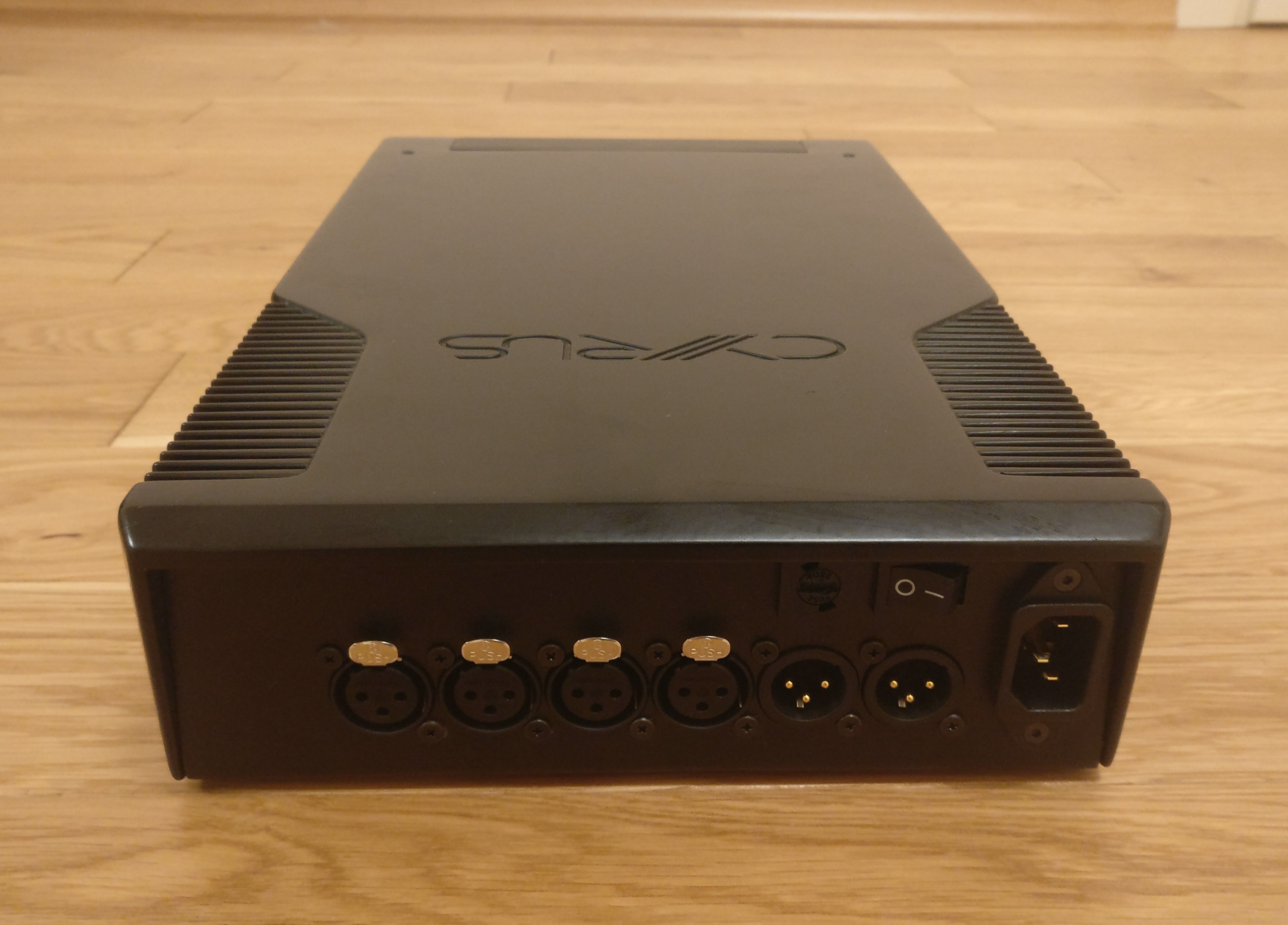

The sad fact that DIYers never have good enclosures to work with has always been a great problem for me, after the tukan guys stopped selling those magnificent half size cases I bought several of these Cyrus enclsoures which are simply a marvel to work with as they have been designed as one size fits all for the various devices Cyrus makes - you have a plethora of mounting holes inside, some of them have usable transformers as well, even small heat sinks at the back for low power amps or high power DACs 😉, Cyrus supposedly used a special allow and you can change the front plate without much effort. It looks especially elegant in silver, sometimes you can buy a faulty one at a great price(no longer since I mentioned it here 🙂 ).

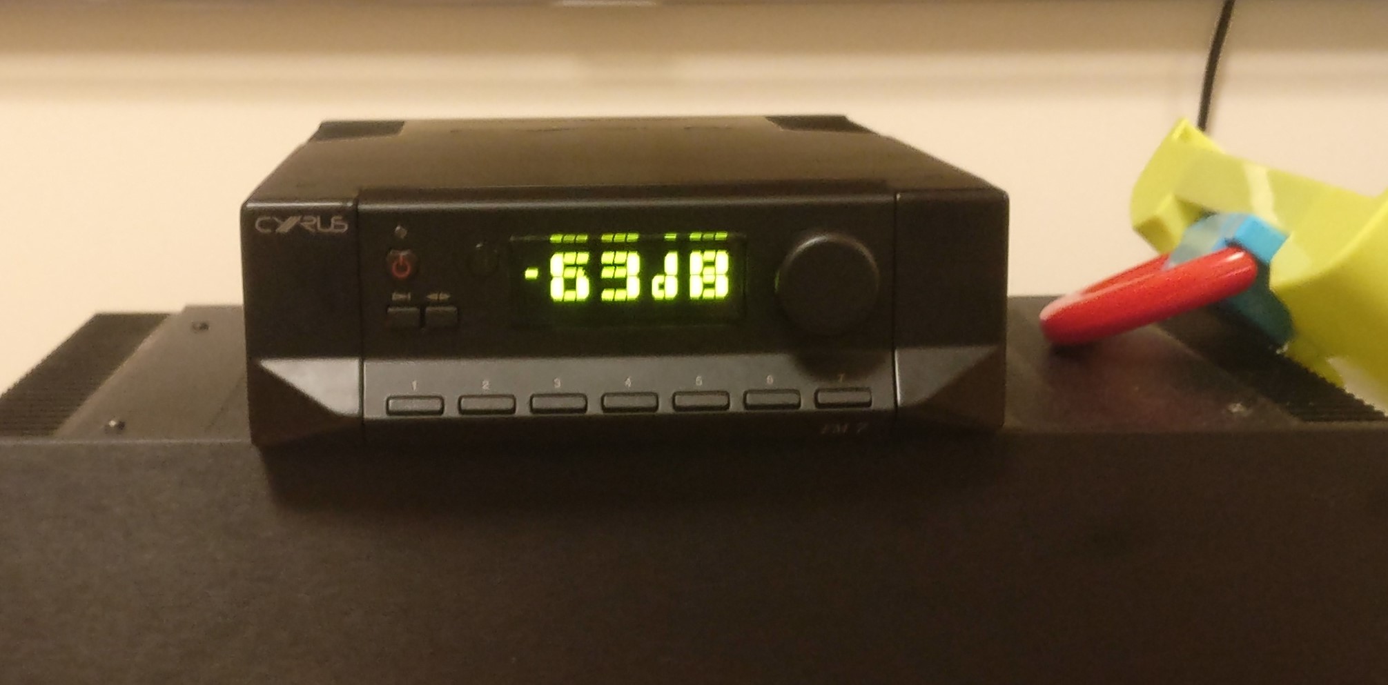

I was lucky that the Maya display fit perfect with the front window so it really looks like a Cyrus preamp with tuner markings and a few extra buttons 🙂

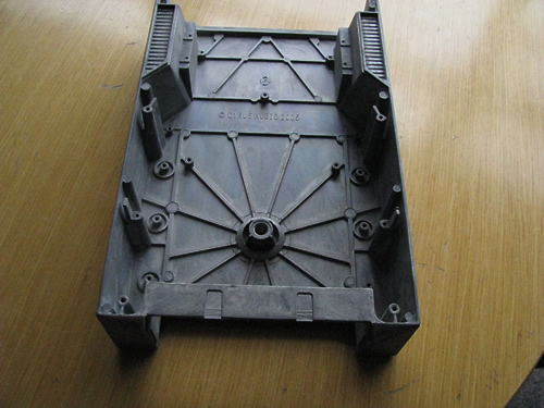

What era Cyrus is it? Early one, from the 80s? I have a non-working Cyrus tuner (the kind with the large front display) .. maybe it is of more use as a case (and selling the working parts e.g. transformer).
Like this one:
I always appreciated how Meridian managed to turn regular, industrial extruded aluminium conduit(?) or something into some great industrial design for the time (with the 200 and 600 series).
No offence taken 🙂 It was one of the latest FM devices they made, they can be bought cheap or a faulty one. Breaks my heart to kill a working device but do it for science...
This is severely off topic but I just never had the time to share my experience with the BPBP which of course sounds very good and the Maya that is probably one of the most complete and thoroughly engineered DIY kits ever. The combination just killed a Parasound preamp from the highest range...

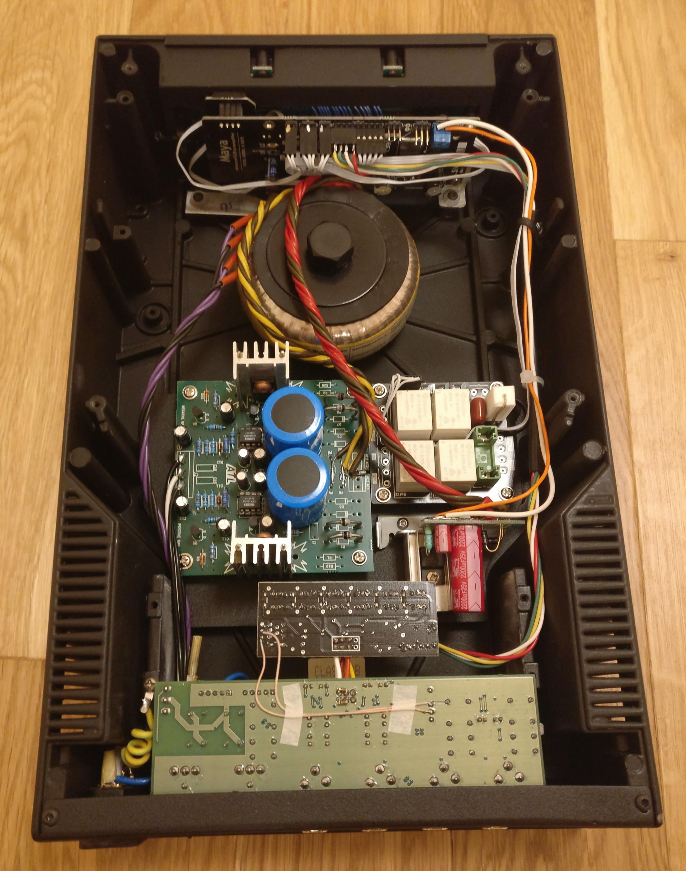

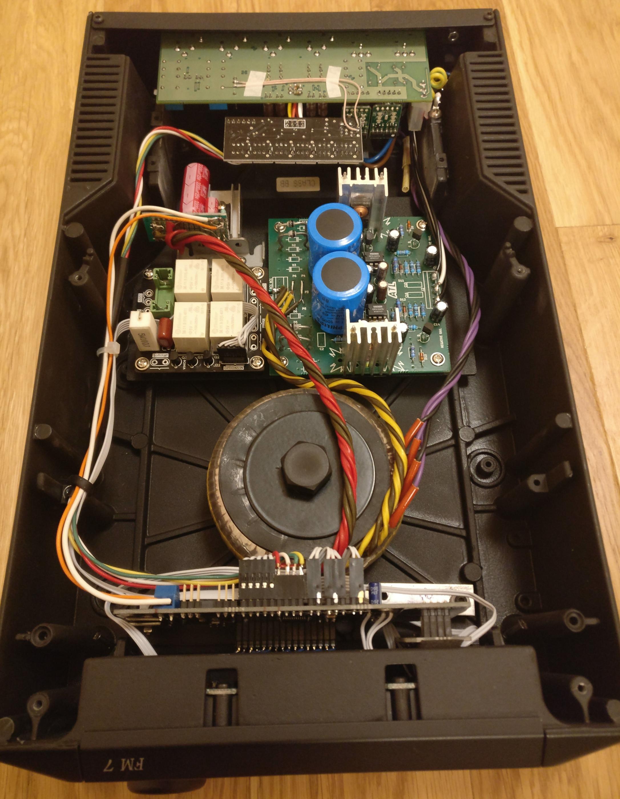

A few pictures as promised 🙂 The boards are actually suspended and the enclosure opens at the bottom, Cyrus says it is good for the sound.
