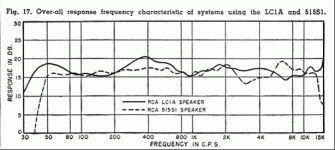

WRT dealing with it from a reflections POV, this is what Olson ~successfully did with his innovative LC-1A 'FR' driver:

GM said:WRT dealing with it from a reflections POV, this is what Olson ~successfully did with his innovative LC-1A 'FR' driver:
I'd sure like to run into a pair of those (and preferrably sometime when i could actually afford more than a look)

I hear ya! I remember how fascinated I was by them both from an engineering POV and how life-like they sounded, so was shocked when I saw a measured response. It made me re-think this whole 'flat from 20-20 kHz' response mentality. LC-1A in large bass reflex designed/measured by Olson and driven by a high output impedance tube amp:
