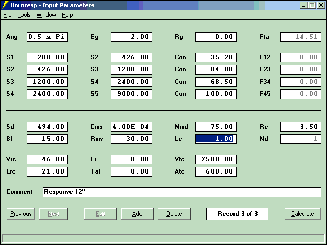

broughd said:
Hi!
I have just copied the model from http://www.cowanaudio.com/hornsubjr.html and input my driver parameters. I had a guess for the ones I wasn't sure of...
The parameters I used are in the file below:
I'm not sure how correct that simulation is. The 0.5Pi value means that the horn is in a corner. Still he adds a conical part that simulate the corner. As far as I can understand it, the last part of the horn should be removed, or the Pi value changed.
Frode
By the way, Hornresp can calculate many of the drivers values. Just doubleclick on the value you want to calculate. Start by putting in the Sd, then doubleclick Cms and so on. Do the values on the upper line first.
Here's how it looks with the values calculated for the Jaycar, and the horn without the last section.
Frode
