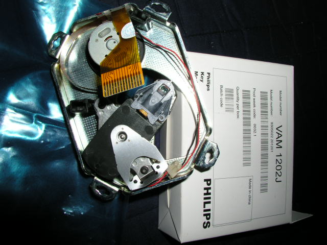

more photos of CDM9/44.
for Wadia 6 user, I also had one KSS-151A on hand which used in cd player such as Teac cd701,601,401
thomas@diyaudiocraft.com
thanks
thomas
