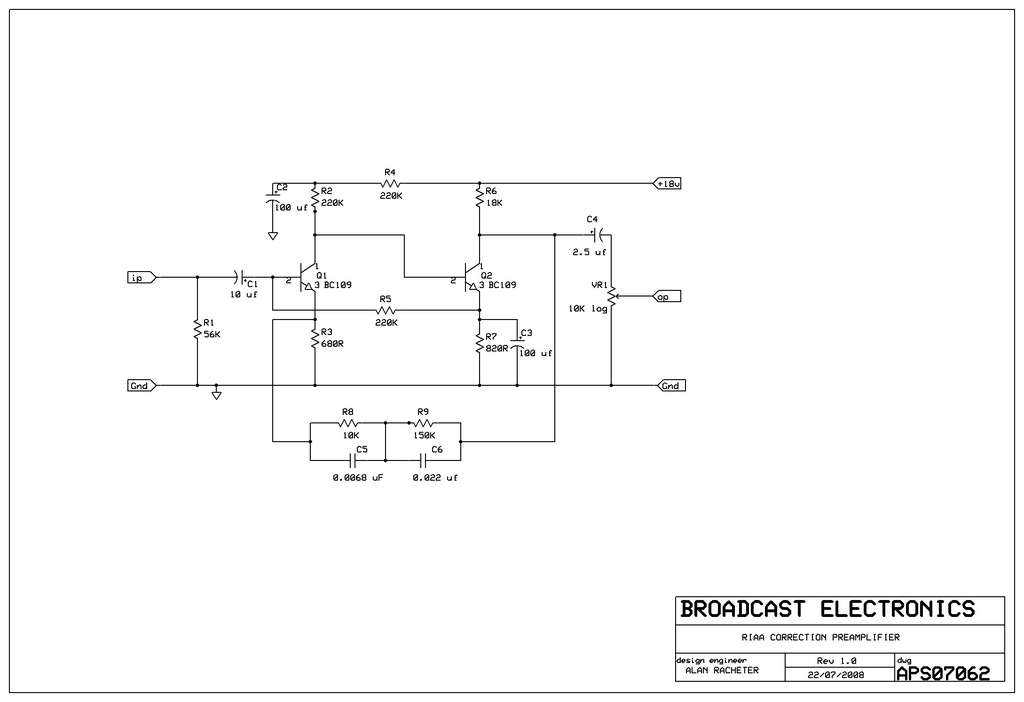

Some, in the broadcast industry, like to
https://www.diyaudio.com/community/attachments/riaapreampschematic-jpg.1038433/

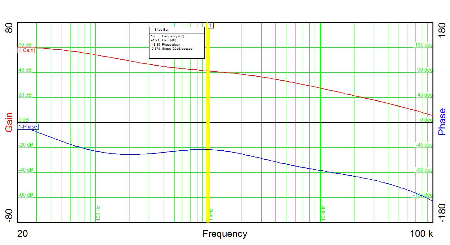

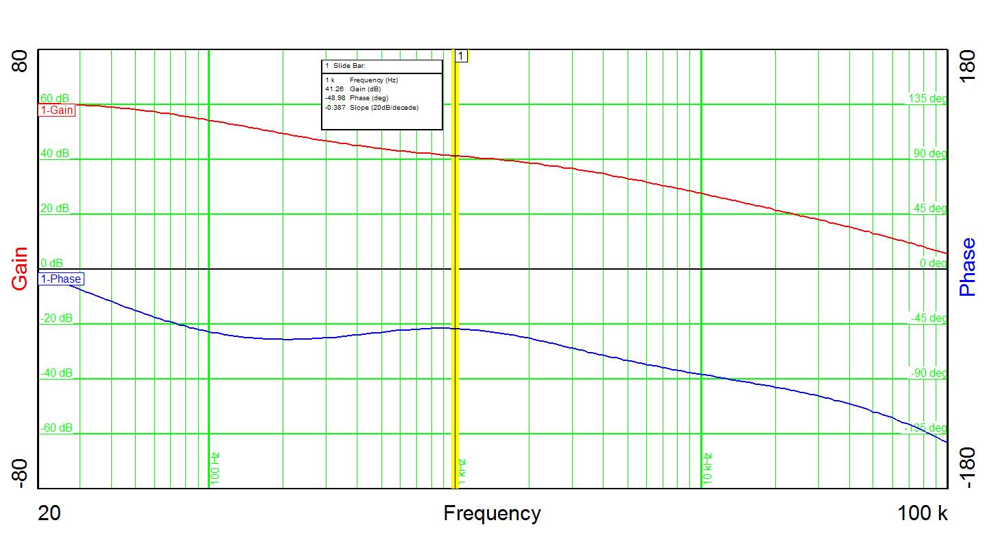

All this nattering about other options for the preamp will fall on deaf ears, as my boards are already finished and stuffed, and should handily out-do any 2-transistor solution, "revered" or no.... The noise observations that originally sparked this thread were made with cartridge in place, which is really how it needs to be done for a practical setup.

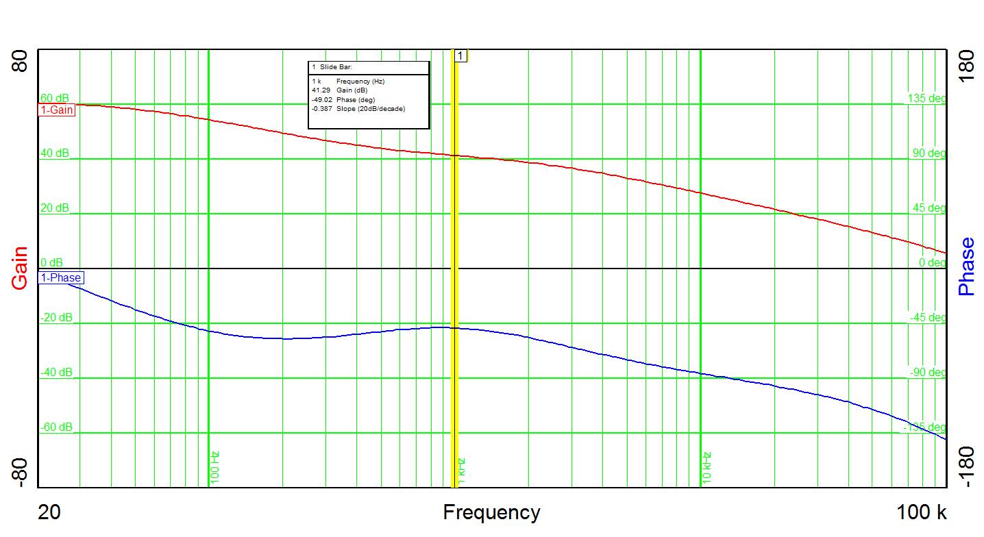

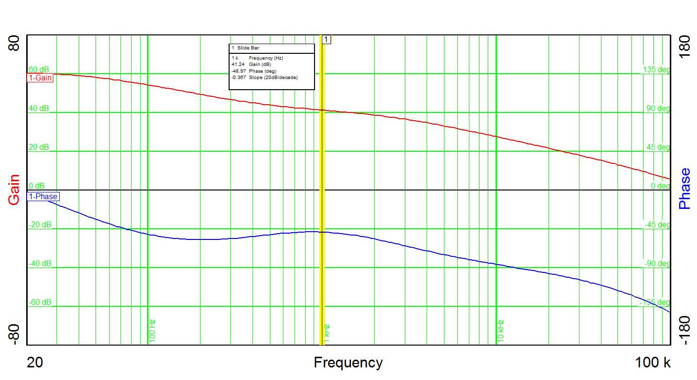

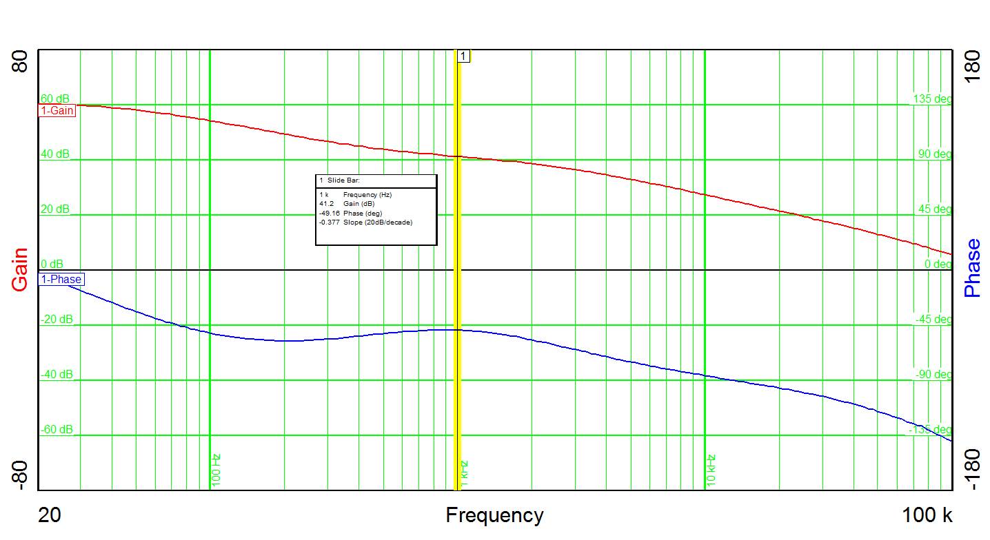

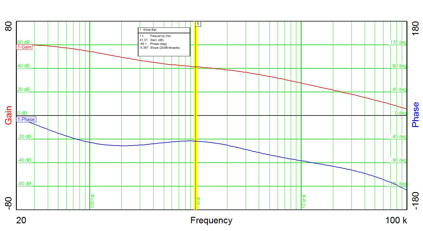

Here's the gain-phase scan from one board, which combines 2 channels of RIAA preamp plus balanceced to unbalanced conversion. The scan is from an unbalanced output used to power an external mixer from its line input.
