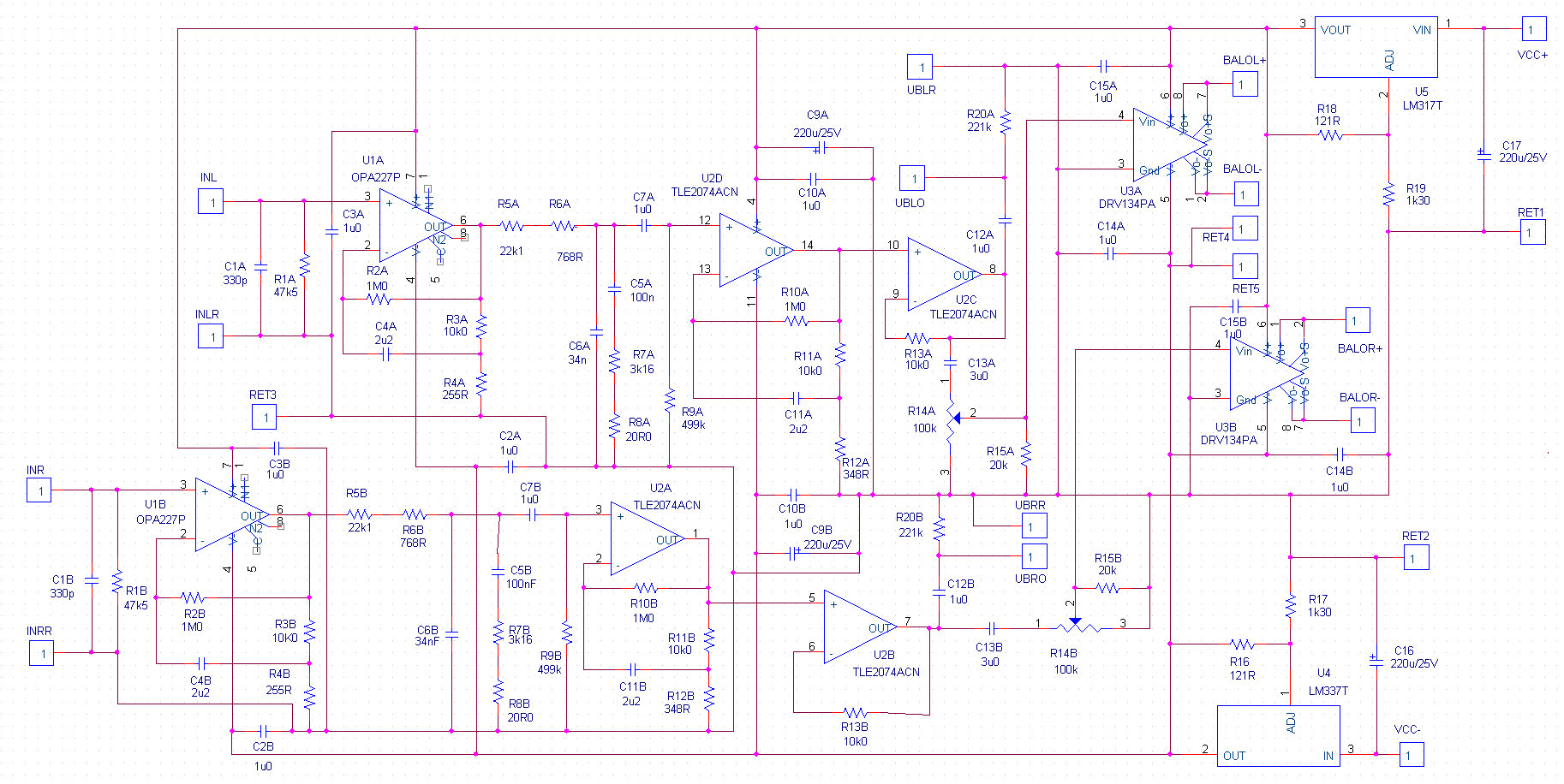

The combination of AD745, OPA2134, and DRV134 sounded good (enjoyable, actually) in the original incarnation of this preamp. which has soldiered on in our main production studio since the early 2000's. I'm interested in how the combination of OPA227 and TLE2074 will sound. I used what opamps I could find, as there is currently a drought of appropriate through-hole parts (if you don't believe me, check the distributors and see what I mean...). I insist on JFET-input opamps for the preamp first stage because of noise issues due to interaction of the input bias current with the high inductance of MM cartridges. Use of JFET-input parts is also crucial in the feedback scheme I'm using for the basic gain blocks.
The Stanton 680s we originally used in the studios had an inductance of almost a Henry. The Ortofon Pro S cartridges we're currently using have an inductance of about half that (450 mH), so maybe not quite so much of an issue. Keep in mind also that this particular setup doesn't have to be all audiophile nicey-nice, as the signal from the master studio gets considerably mangled in its journey up to the transmitter tower , ~20 miles from the master studio - this is an FM radio station after all, not a living room listening environment. The original caveats on perceived noise with the console slider up still apply. When I can find where I've stashed my AD745s and my OPA4134s, I may swap and see if there is a difference in perceived listenability.

To Mark - in the original circuit using LT1115 the noise was very obvious and objectionable with the slider up at normal playing level on the mixing console. Substituting a resistor of the same value as the cartridge resistance across the input cleaned up the noise. It was the nearly 1H inductance of the Stanton cartridge that caused the problem. Things quieted down very dramatically after switching to the AD745. I expect similarly quiet operation from the OPA227.

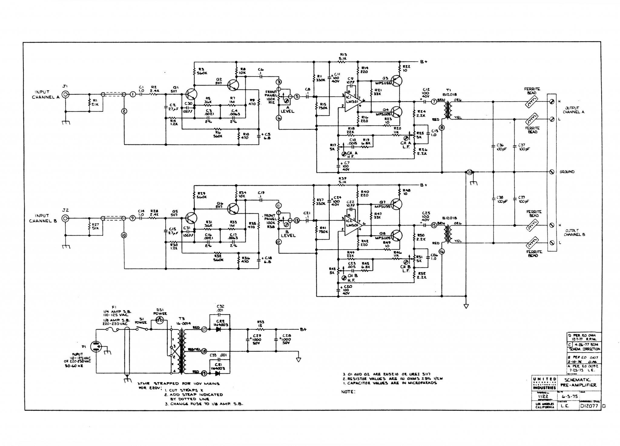

You guys can ague the relative merits of that POS 2-transistor RIAA circuit as much as you like. I'm not going to tear up what I've already done. The circuit in question must also provide balanced outputs to feed our mixing board, as well as unbalanced outputs so that a visiting DJ can plug in his mixing board for things like beat matching. The circuit should also at least make a college try at duplicating the RIAA EQ curve with minimal error, though I will add in some low frequency roll-off, so that signals from warped records don't get in to confuse the downstream signal processing. That 2-transistor circuit is nothing that I would want to leave behind as a legacy with my name attached to it. The same goes for its vacuum tube brother using 12AX7.
I certainly did not recommend the two transistor circuit. It has poor headroom, is not particularly accurate to the RIAA curve, and may be noisy. There is almost no flexibility to improve the circuit with just component value changes. A redesign would be needed. We did kinda hijack your thread and I apologize for that.

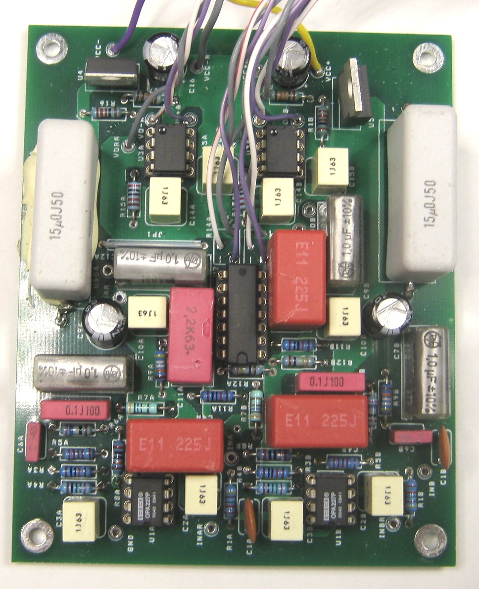

We both know who was to blame for that.... What I built for the master studio is very similar to the preamp I built for the KFJC production studio, a design that has served very adequately since 2004. The only service I expect to perform on that older preamp may be a simple re-cap,. Having said that, I used long life low ESR capacitors (Panasonic HFQ) for PS filtering, so they may still be good...

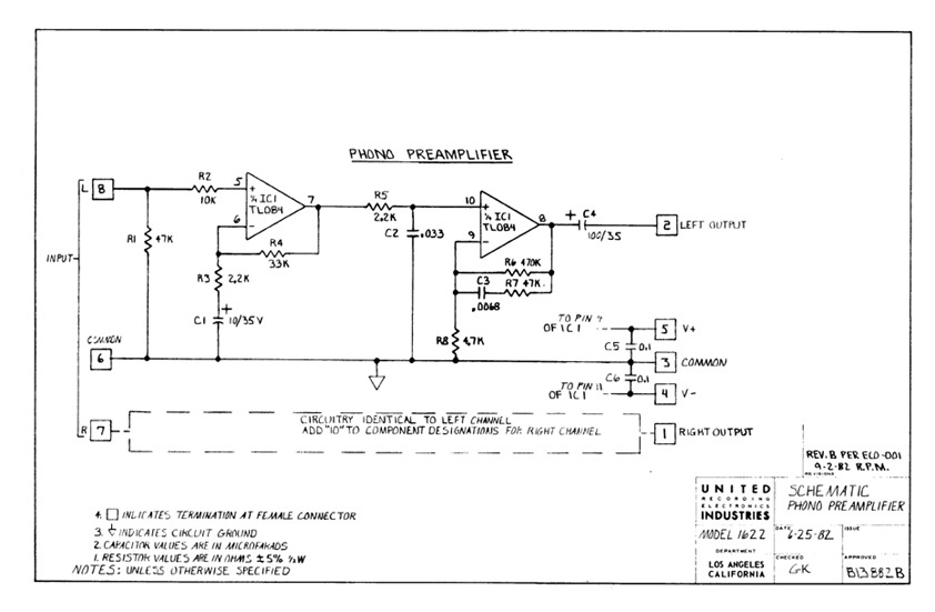

How about the UREI 1122 phono preamp, allegedly found in many recording studios and radio stations. It has balanced outputs... but uses a mere two transistor RIAA stage, LM301 with MPSU55/MPSU05 booster for line driver, and an unregulated power supply. 0.5% THD, 60 dB hum and noise, and 42 to 50 dB channel separation. The "response trimmers" look an awful lot like tone controls. It's disturbing how much people are willing to pay for these.
The 1622 card from the revered 1620 mixer looks better; sometime this century I hope to build a version.
It's interesting that you managed to get so far from the noise optimum that it was audible and even objectionable with a record playing. Underestimating the effect of the equivalent input current noise is a very common mistake, even Douglas Self made it in the mid-1990's, but often record surface noise still masks things when there is a record playing.
See https://worldradiohistory.com/UK/Wireless-World/00s/Electronics-World-2003-10-S-OCR.pdf pages 38...43 for a simple way to account for the frequency-dependent cartridge impedance. Mind you, one section of the switch in figure 5 is drawn in the wrong position and the terms spectral density and power spectral density are mixed up. 3852 Hz becomes 5179 Hz when you use ITU-R 468- instead of A-weighting.
The LT1115 and LT1028 are really the very worst op-amps for MM amplifiers. The only thing that's even worse is several of them in parallel, as Elektor used in the MM version of the Supra 2.0. That reduces the already negligible noise voltage, but makes the noise current even worse.
