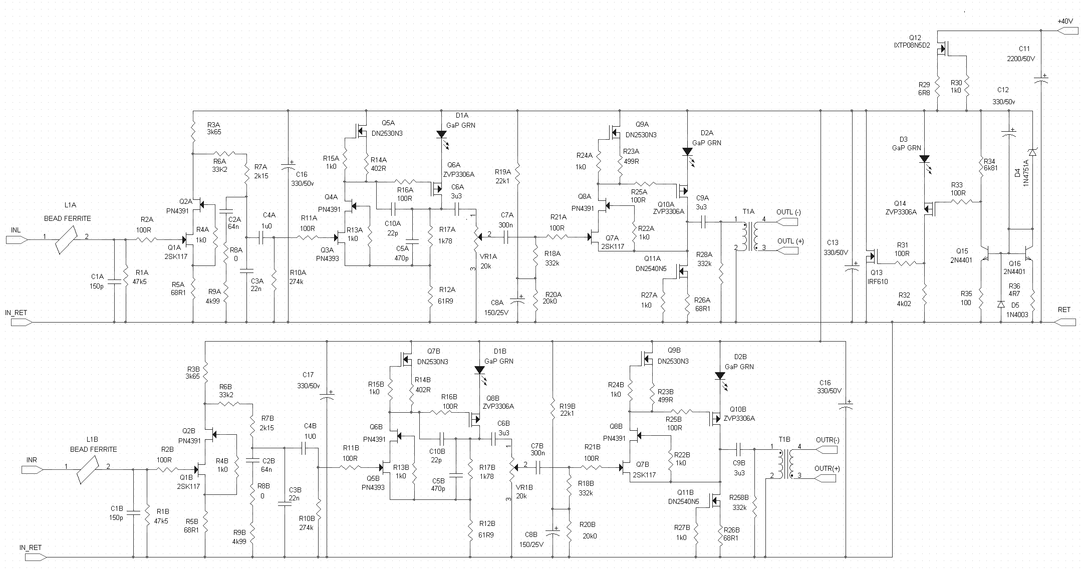

I occasionally help out a local college radio station with engineering. Among other things, I have constructed a couple of RIAA preamps for their production and master studios. It's not exactly an audiophile operating environment. For the main production studio, I designed and built a preamp based on the passive equalization circuit shown in "A". The front end amplifier U1 was an LT1115, and the post amplifier 1/2 of an OPA2134. This fed another OPA2134 buffer and a DRV134 balanced driver. All the guts for one turntable fitted on a small (~3" X 4") circuit board. To my chagrin, the noise performance of this circuit was less than spectacular, with very audible hiss in the monitor speakers when the pot on the mixing board was turned up all the way. However, the preamp sounded nice, with tight bass and well-articulated midrange and highs. As an experiment, I plugged an RCA plug terminated with the cartridge equivalent resistance into one of the input jacks - presto, no noise, zip, zero, even with the slider on the mixing board pushed up all the way. I was forced to conclude that the problem might be with the TT cartridge. The most common broadcast cartridge is a Stanton 500 or 680. These have an inductance of ~900mH (!) and about 1250 ohms resistance. I decided as a preliminary hypothesis that the noise current of the first op amp was interacting with the inductance to produce the noise. I replaced the first opamp with a FET input OPA134, and the noise mostly went away, though the overall sound became more "constricted". Can anyone recommend a better FET input amp (single) that I can use in the first stage? I am considering an AD745JN (if I can find some) or an OPA627.
To get around the bias and noise current problem for the main studio preamps, I used a passive setup with the gain block shown in "B", feeding AD826 buffers and DRV134 balanced drivers. This has been more or less successful, though it's a lot more parts. Has anyone had similar experiences in a broadcast environment?

i've always been curious about "passive eq" between 2 op amp based feedback gain blocks - what's the theory?
you are using feedback around the op amps to provide flat gain when the op amp gain inherently rolls off with a first order slope - wether you subscribe to the classic feedback theory maximum loop gain principle or to Otala's phase intermodulation distortion/TIM camp, both lines of reasoning suggest that puting a riaa lp pole in the feedback network will give better results
perhaps the opa134 will sound less "constricted" with a feedback cap implementing one of the riaa poles and providing a large region of constant loop gain where the riaa rolloff and the op amp open loop gain rolloff compensate each other - additionally the slew rate demand is hugely reduced
the zero intoduced when the noninvering circuit reaches unity gain is easily compensated by a passive interstage rc if you beilve it necessary, Thorstein actually recomends a hf zero as being desireable to cancel the cutting head amp rolloff
If you pose your question about equalization in another thread, I'm sure you'll get all the answers you want. There are more combinations of feedback and passive equalization than a cat has hair... I chose the simplest implementation of passive equalization.

I was under the impression that passive RIAA EQ was a bad idea and it is the worst configuration for noise and headroom. Although you have terminated the input and got little noise so proved that it's a cart interaction problem, have you tried any other pre-amps, just out of interest? Even a cheap one!
the AD797 datasheet is a bit light on the noise current discussion but the info is there if you know how to use it
the LT1115 ds is a bit better but both oversimplify by talking about source resistance instead of impedance
ancient national semi app notes help, look for an-104 and an-222
basically your mid band cart Z of ~ 10 KOhms has 2pA/rtHz noise current flowing in it from the AD797 input noise current giving 20 nV/rtHz (rising with source impedance)
on a total noise basis you would be better off with a TL071
but you really haven't established that the noise is an issue at all, without doing some numbers on cart sensitivity and system gain the hiss could easily be > 10-20 dB below record surface noise and you are just wasting everyone's time
my earlier point was that your circuit topology is very poor by most recognized criteria, the "simplicity" of the schematic is an artifact of human visual perception or function block style thinking and doesn't reflect the performance limitaions of the op amp gain blocks in the compelte circuit context
i find calculating the pole location in a op amp gain block with a feedback cap rather simple, parts count is actually lower and performance is objectively better

Here's the next rev of TT preamps for the KFJC main studios. The overall sense of the preamp is inverting, but I'll be switching around the leads on the output transformer for non-inverting response overall. Output transformers are Reichenbach RE 11-DM

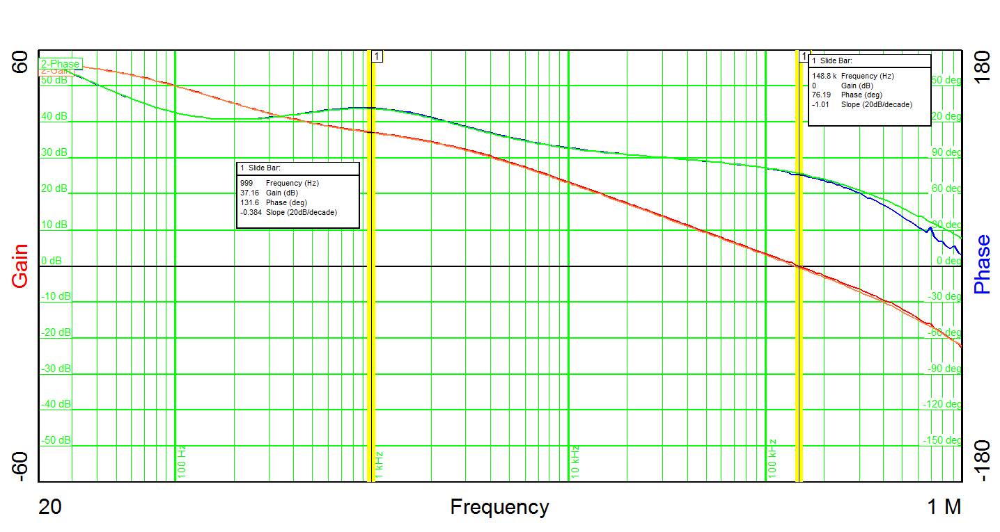

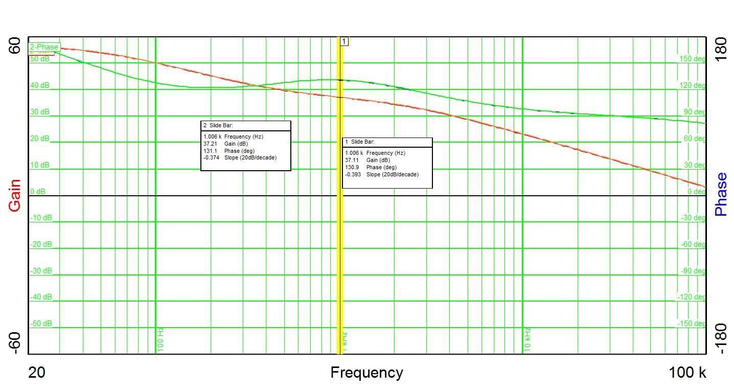

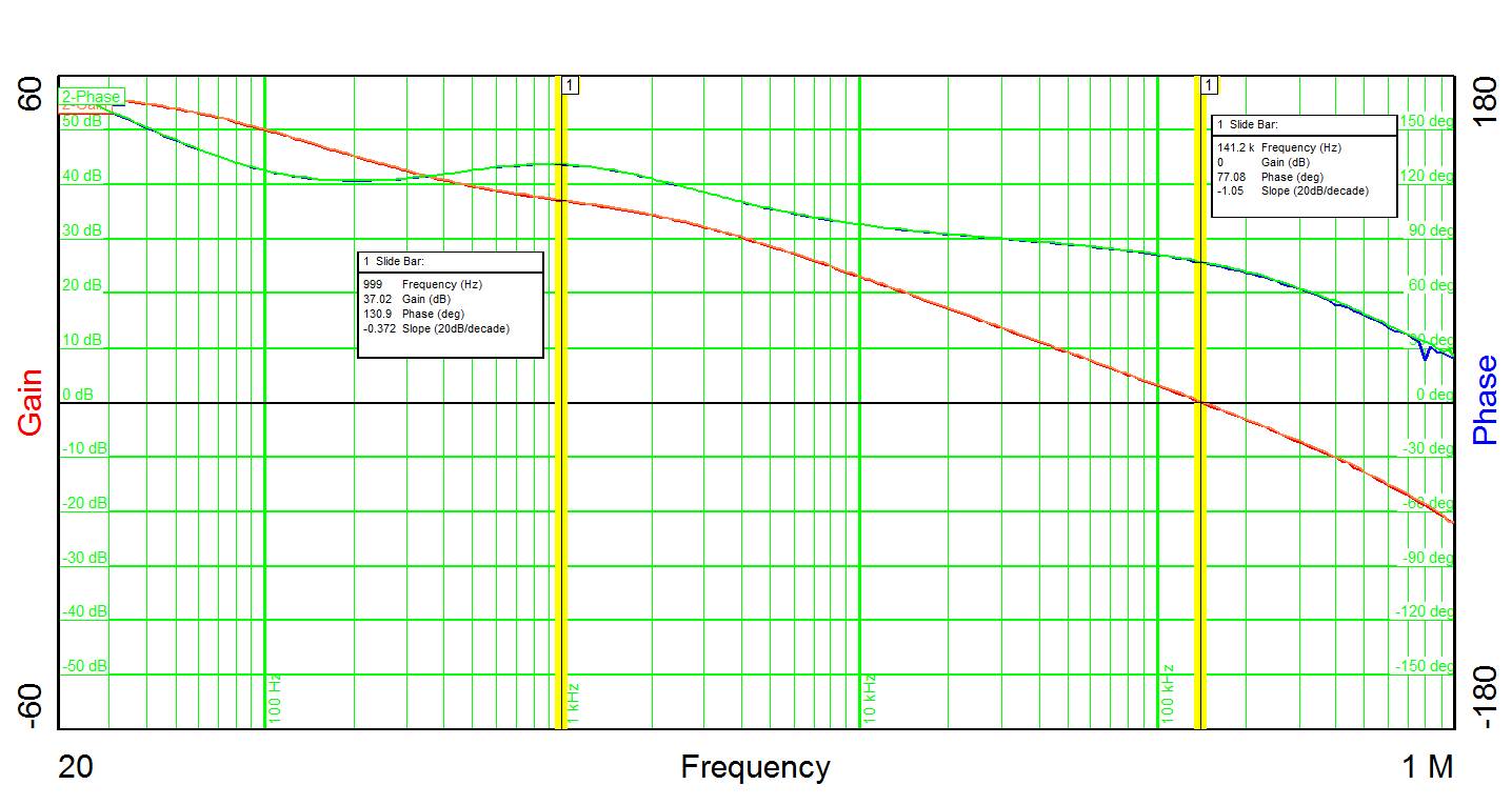

Here are the response curves for the three modules that are going into the preamp box, each representing two channels of RIAA amplification/equalization plus a unity gain line driver, Response curves line up in a rather satisfying way...
