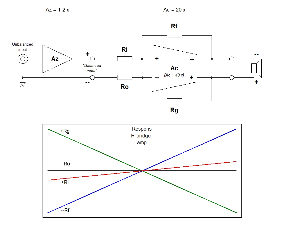

You can use low RG to keep RF low, and drive it with a dual op-amp.
I assume RG is the input resistor of the inverting amp? If so, that dual opamp in front is an extra amplifier in series with the amp itself, so how to fold them together? I've tried a T-network feedback, but it prooves very unstable in hf.
Agreed with your post #6 and points HiZ and corresponding node definitions.
Yes.
Yes.
Not sure what you mean. Attached is the schematic of what I am proposing. You technically do not need the 2nd op-amp, but it adds symmetry.
Best, Sandro
That's more or less the same I have in mind with a double inverting symmetrical bridge (triggered by BesPav initial contribution #1; sorry, we're not intentionally hijacking your topic currently) I'm working on some time now.
Other then BesPav noninverting circuit bridge, this setup is indifferent to the following and end stage configurations and needs no adjustments, control loops (intrinsic stable) or compensations during simulations (dc-100M); real life will force hf caps in the feedback though (parallel over Rf and Rg). But I want to get rid of the Az stage, which serve as impedance buffer only when I want Ri and Ro at low values (100Ω), keeping Rf and Rg at 1kΩ and comp-caps at sensible values. A T-network for Rf and Rg yields hf instability. There is no need for a second pre to buffer the ground node, not even in open loop!
However, Az can be a srpp or a single stage Pass pre amp (sounds obvious) or the like. Even more, like BesPav bridge design, there is way less stress on the power rails and dynamic demands.
You can put an instrumentation opamp pair in front of fully-differential one.
Since CMRR more like than ∆R/R it's effective to increase input impedance higher than usual 10k.
Also ground wire needs to be the same impedance than the signal wire if an output filter on the source side is used.

All true and agreed. But I want a very low Ri (most pre cannot drive), almost current driven. A high Ri and Ro needs that crazy high Rf and Rg, even parasitic capacitances brings the Fo... bandwidth back under 100k, so phase is running away from 10k already. Compensating within the bridge to overcome this (peaking) yields extreme sensivity to hf noise. A small build made mumbling voices and afar lighing audiable (on headphones).
Actually, both your and my bridge are children of instumentation opamps.
An instrumentation opamp to drive an instrumentation amplifier. Hmm...
Why not...
Common base or mirrored open emitter as input.
5 leg of AD844 at the source side as voltage-controlled current source (just load noninverting input to ground with gain resistance and feed your voltage to inverting leg, perfect V->I converter with at least 3 zero THD) and inverting AD844 leg as receiver, again with noninverting input feeded with 1-stage gain resistance to GNG and 5 leg to GND as 2-stage gain.
Hi-Z source and Lo-Z receiver as true current signal transfer.
