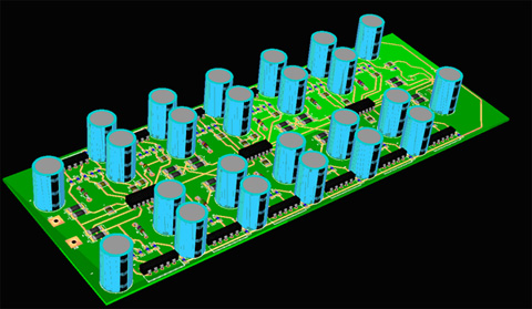

This is my version of the bridged/parallel LM3886. I will have boards in the next few days. It is for sub use and should push 600W @ 2 ohm. I will use it at lower voltage and 4 ohm load for about 350w output.
The short chips along the edge are the LM3886's. I haven't updated the rendering model to show it accuratly.

you are kidding yourself.InlineTwin said:This is my version of the bridged/parallel LM3886. I will have boards in the next few days. It is for sub use and should push 600W @ 2 ohm. I will use it at lower voltage and 4 ohm load for about 350w output.
350W into 4r0 requires 52.9Vpk =37.4Vac into your load and require upto 12.6Apk from each of a three parallel pairs set up (6 chipamps in bridged/parallel).
Do you really expect the chipamps to survive supply rail voltages of around +-57Vdc? You seem to be ignoring the maximum current specification of 7 to 11Apk.
In DIY, you either slavishly copy a good working design or you learn to do some of the arithmetic. Spouting impossible numbers does not achieve anything. As for 600W into 2ohm, you are in the dream world of car audio fiction.
Did you not look at the layout??? It is 12 (that's twelve) LM3886 in BRP. Don't start spouting off nonsense when you have not reviewed the project.
Read section 4.5 in the AN-1192. It gives Pd max, which gives the max disspiation allowed on each chip in the BRP configuration. You can back out a voltage from this and I think you know where to take it from there to find max power out.
As an example to make sure you are doing it right try to get the 200w number they show at 8 ohms and +-37 volts. Maybe you will surprise yourself.
I missed 6 of the chipamps.InlineTwin said:It is 12 (that's twelve) LM3886 in BRP.
But, I stand by the impossible peak voltages shown in my example calculation. The current/chip would be halved using 12 rather than 6chipamps.
Your project still cannot achieve 350W into 4ohms nor 600W into 2ohms.
