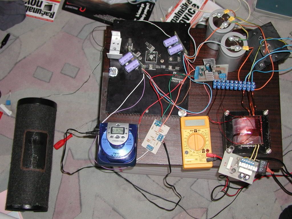

Well I would agree, but you can drive 4ohm load in bridge mode too, I have done it... but supply was only +/-30v and for short time, just to see if bridging adapter worked. By driving 4ohm load you will hit current limit pretty fast, 8 or more ohme load should be connected only
Hi,luka said:Well I would agree, but you can drive 4ohm load in bridge mode too, I have done it... but supply was only +/-30v and for short time, just to see if bridging adapter worked. By driving 4ohm load you will hit current limit pretty fast, 8 or more ohm load should be connected only
That is a standard test I carry out.
Fit a resistive load of half the intended speaker impedance and check that the amp can drive it adequately (>=180% of max output power) and does so without any transient instability on the test waveform.
I would expect every competent amplifier that is designed to drive an 8ohm speaker to easily drive 4r0 for a few seconds. The output stage gets too hot too quickly and risks damage to the junctions if this maximum power "test" is continued too long. This implies that a good 4ohm amplifier should easily cope with driving 2r0 for a few seconds, but any responsible designer will never claim, unconditionally, that it is a 2ohm capable amplifier.
