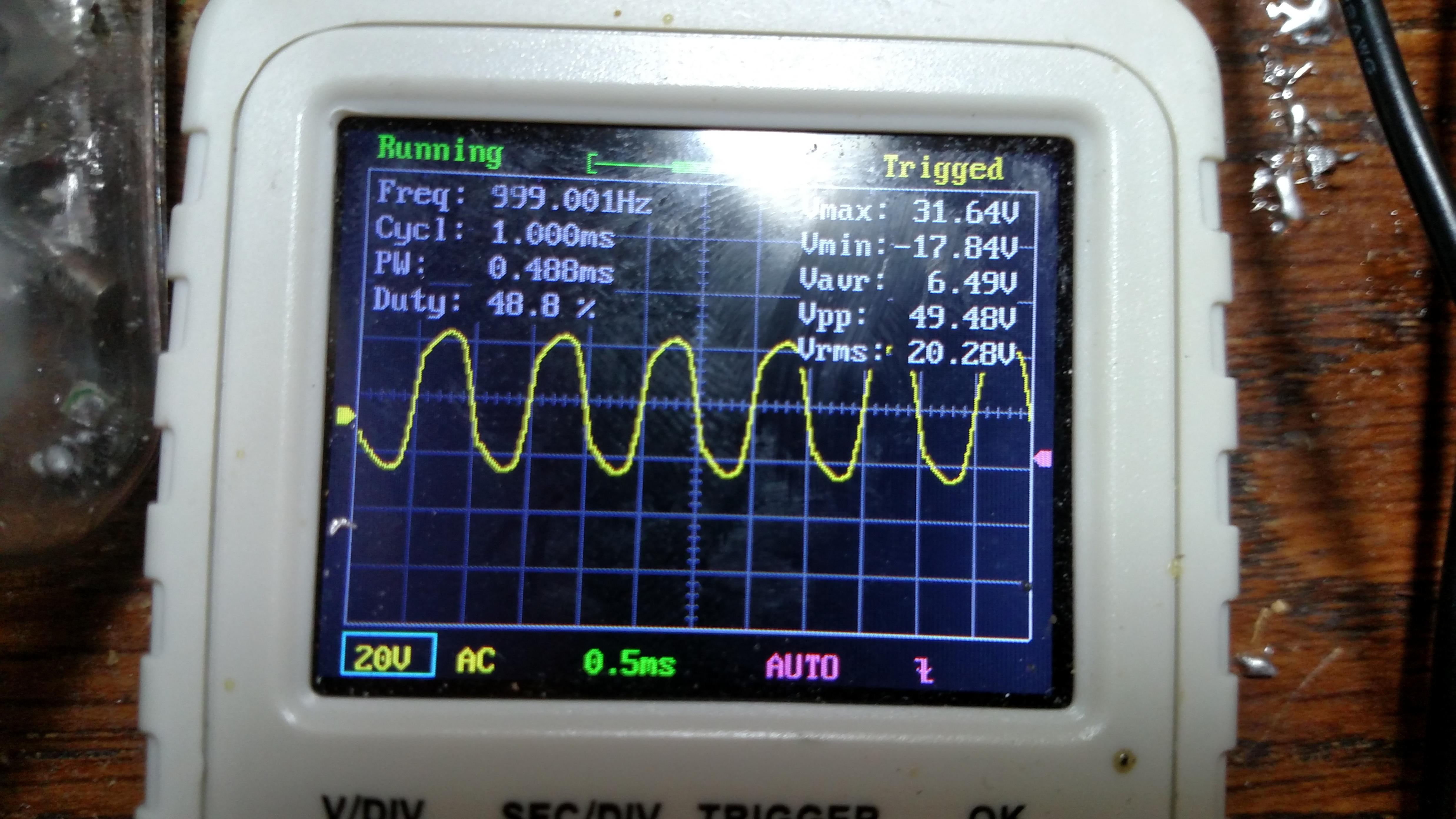

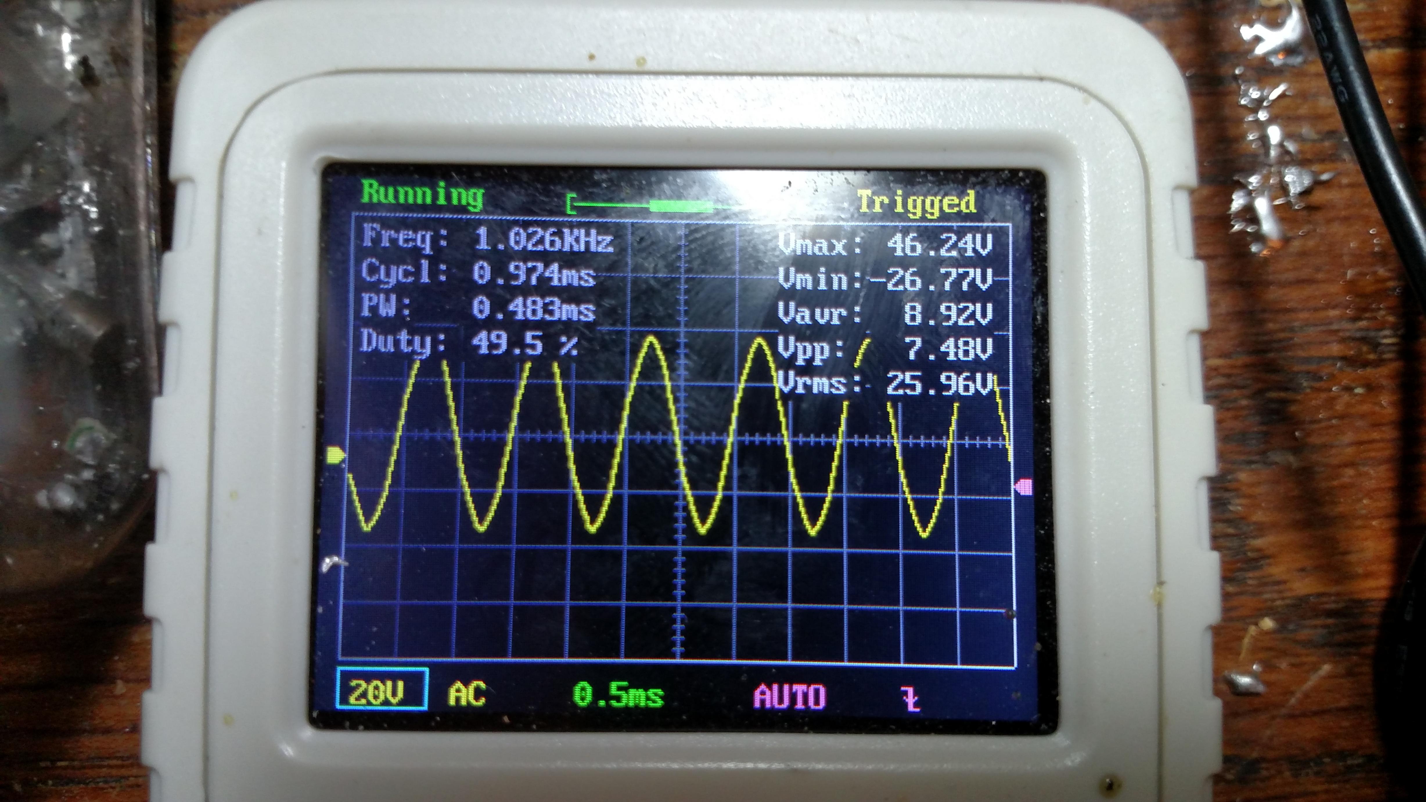

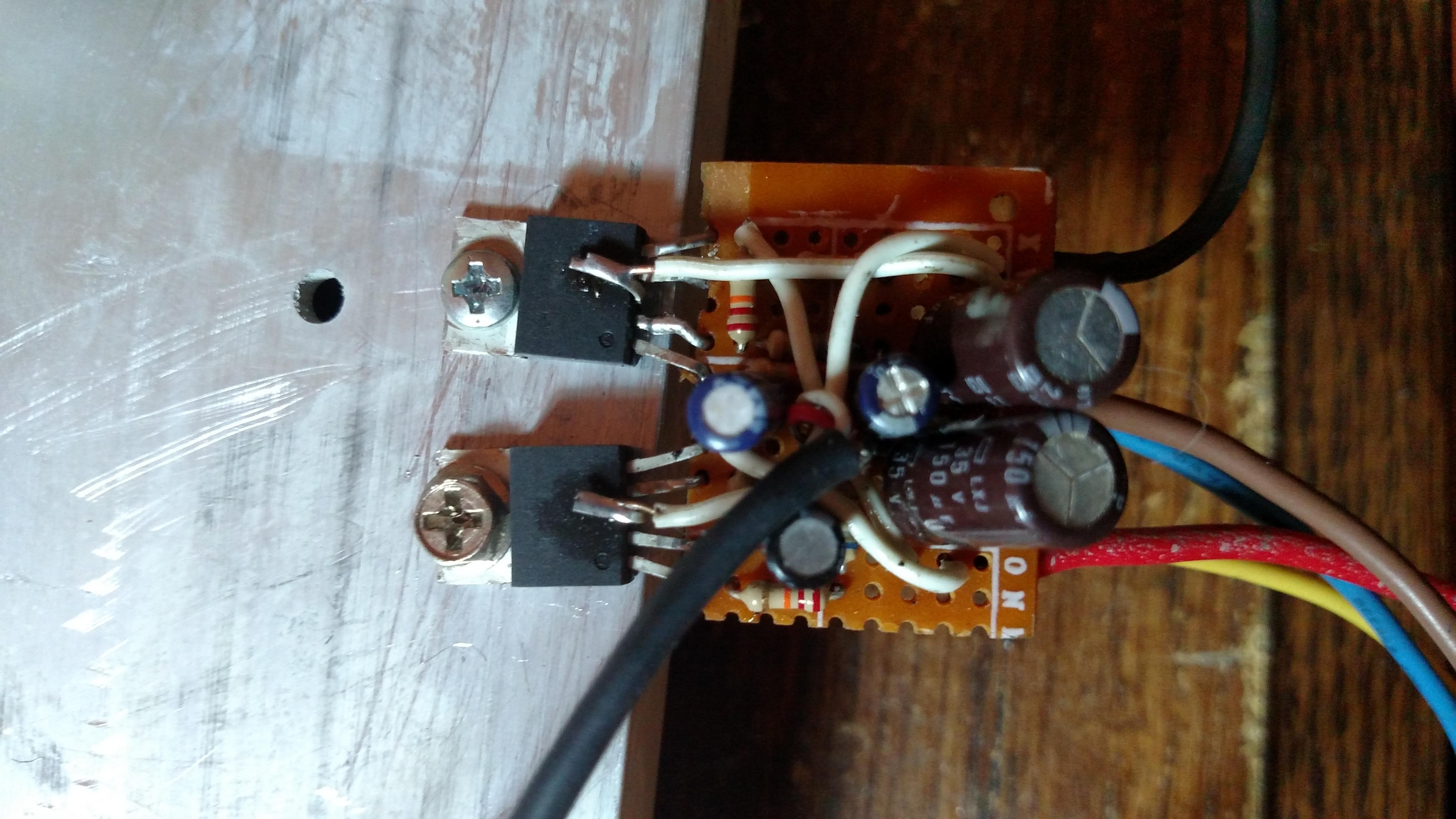

Built this circuit with 30-0-30 supply, driving a 17.5 ohm center tapped load. Scoped from center tap of the load to output of primary amplifier has very nice output, but the other inverted amplifier output is lacking resolution and decreased power. I do have some TL-072 chips that I could possibly employ to resolve the asymmetry issue, but would rather put those to use in a high power solid state amp. Any suggestions from knowledgable experts frequenting this forum shedding some light on what measures can be taken to resolve this issue are greatly appreciated.

Shorting c7 yeilds no change in the output waveform whatsoever. Now I wonder why it is even called for in the schematic...
And yes ubergeeknz, that centertap is left unconnected to ground or anything other than the probe reference.
Just tried scoping the outputs (still loaded BTL mode 17.5 ohms) and the primary chip output was clipping, so I reduced the input signal until a perfect sine was achieved. The output on the second chip still very diminished by comparison. (51v p-p vs 21v p-p)
->CORRECTION! I just noticed that the INPUT SIDE AMPLIFIER is actually the one with diminished power, NOT the inverted one!
Perhaps I should also mention that my load is actually 2 transformers in series. I plan to drive 4 power transistors in BTL mode with the output of these 2 transformers.
The sine looks good when referencing to gnd, but the inverted amp output is lacking power, and scopes out as pictured above when referenced to the tapped center between the 2 trafos.
Pokeing around with my probe I am seeing a very pretty sine of 17.64v p-p!!! on pin 2 of the inverting amplifier that I initially thought was the one with diminished power. Maybe there is too much power at the inverting amplifier that is crippling the primary chip? I will keep at it and see what I can see...
Using a varistor I connected between pin 2 and GND on the primary amplifier, as I reduced resistance to GND, the output increased quite rapidly. The output also increased a tiny bit on the inverted amplifier as well. Looks like I just need to set this circuit up on a breadboard and tinker with values until I find a happy balance for the 2 LM1875 chips. Thanks for any tips, and please, keep 'em coming! I ain't done yet! 🙂
Spot on ubergeeknz! when I was connecting all the ground leads looks like I missed that one. I am not seeing 17v sine on pin 2 now, registering zero on both pin 1&2 on the inverting amplifier. Output is symmetrical. My transformers are not. I guess there are differing materials in the ferrite cores I used because I am still seeing a difference in waveform and power on those transformers. If reverse the arrangement the problem follows the arrangement. Oh well guess I get to build a new set of identical transformers. Thanks for the help! \m/
