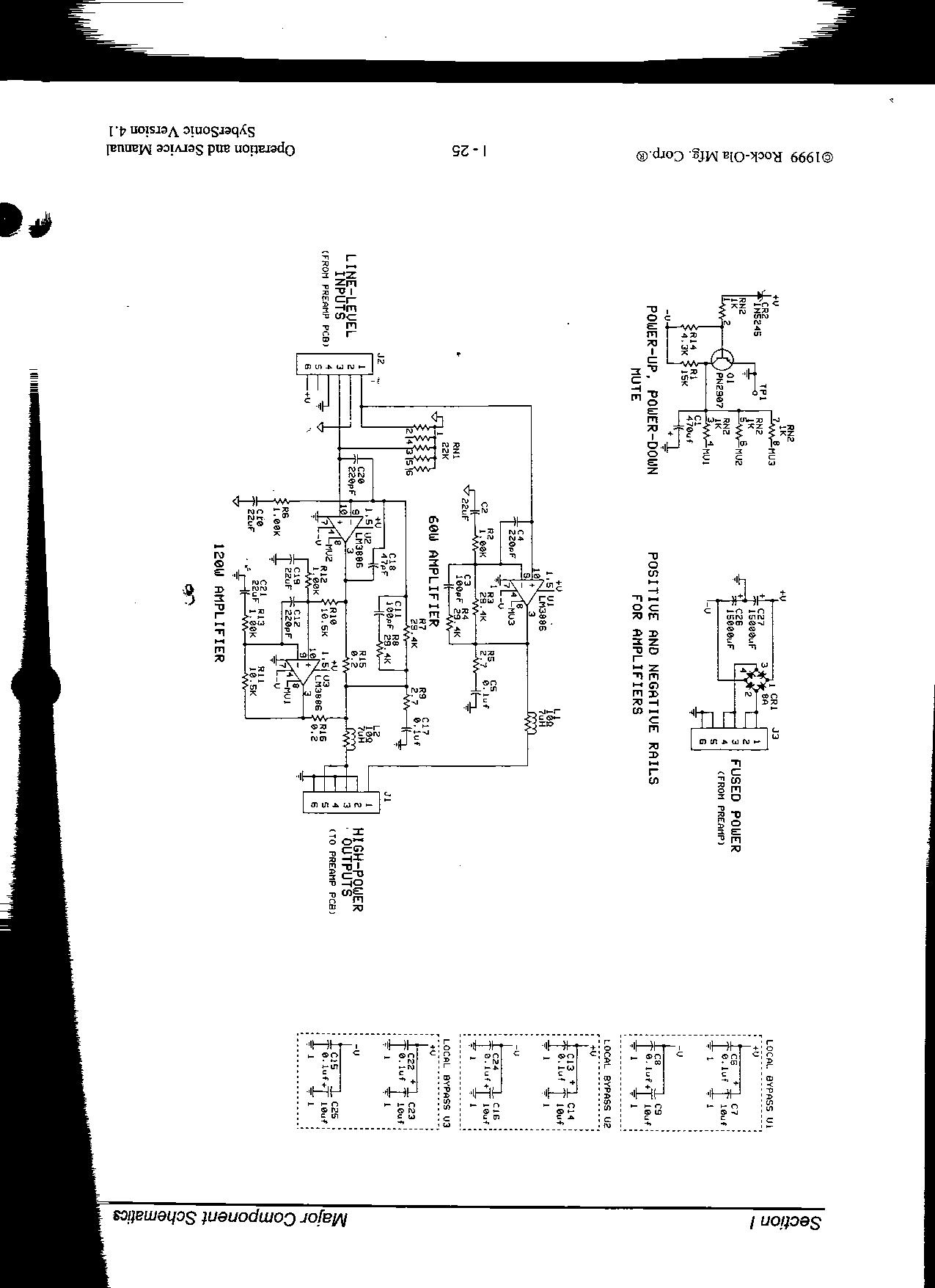

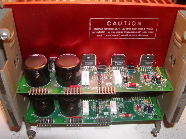

You can purchase something like this off ebay. Its out of a Rock-ola Bubbler Jukebox. It has the cover removed as well as the computer controlled preamp.
Each module contains one channel of unbridged power. It also has one channel of bridged power. A module for each channel right and left. It has the capability to provide 60 watts stereo per channel and 120 watts bridged per channel.
All you add is a AC supply and signal and take off output to the speakers.
Hi 6BG6GA, that diagram shows one channel wired for parallel operation, not bridged, and it would only provide a nominal 120 watts into a 2 ohm load. Beyond that, it's a rather strange way to parallel these things; different feedback circuits for each one which could lead to unequal currents through the output summing resistors, and one amp output is driving the input of the other which is not the optimal way to do it. I would recommend steering clear of this design.
Mike
Mike
Ok, I just realized there are two amp assemblies there that could be bridged, but I stand on what I said about the design, I don't like it.
Mike
Mike

I don't know what to say.... It works well for Rock-ola. It sound good in my Rockola Bubbler Juke box.
The amplifiers sound identical to the chip amps that I made.
Well the thing putting me off the rock-ola is that it comes pre-built. I'd like to have a hand in the design and then put it all together, for the same sort of money I could probably get a pretty decent commercial amp but I prefer the diy route.
