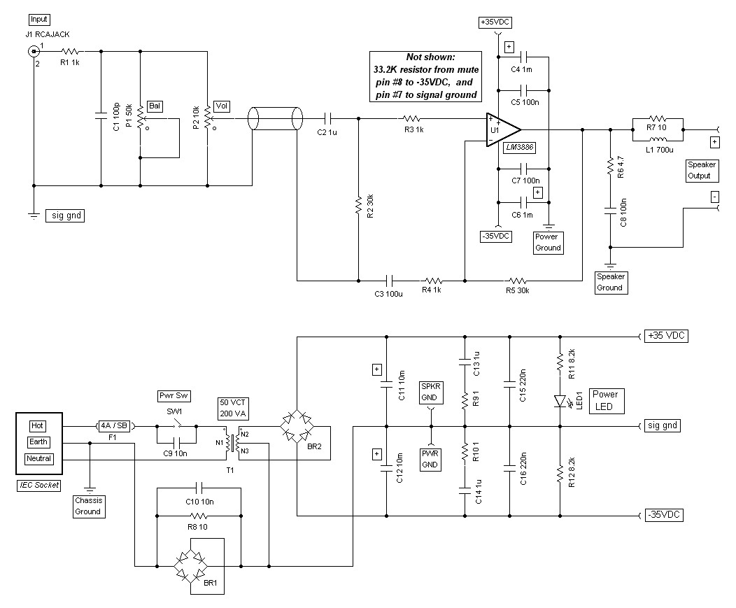

edit: Chipamp.com schematic attached for quick reference.

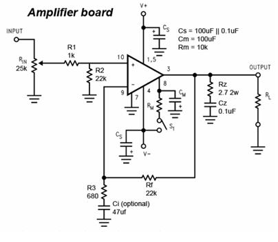

That schematic you have shown again is not suitable as a beginner project.
You need an AC coupled design that includes all the National "optional" components to give beginners the best chance of building a successfully operating amplifier that is less likely to blow up and maybe more importantly reduce the risk of damaging your speakers.

Edit, just seen your new post: I'm pulling my hair out now lol. I wanted a kit because the parts are cheaper from canada and the pcb's are both well designed and again cheaper than custom boards. Assuming you use PCBs, where do you get them from in the UK? I don't mind designing my own but I need to get a solid design sorted first and properly understand each bit. If I did my own board then I can lift the circuit exactly as is from the NS datasheet, perhaps using a PSU kit from chipamp.com.
Or there is the option of veroboard, but it seems like it might harder to have a star ground and my track width is limited by the board.
A buffer is something I haven't looked into yet but the NS circuit has a 10k pot on it, so again keeping the circuit exactly the same it should work?

Wow, ok big revelation, it makes much more sense now. I've updated my excel doc so it can recalculate everything when I change the inputs.
As for the resistance across the terminals I can't actually tell you because the speakers are in my house in Leeds while I am in London for the summer, plan is to design this as a mini summer project and build it on my return.
To meet the current requirements of the transformer I will indeed need a 300VA one so this means 25V is the best choice, the next step is 30 and that is too much for a number of reasons. This also points to about 40W per channel which makes me happy again lol 🙂 Gain becomes 25.

Hmm, what is it that concerns you about the chipamp.com design Andrew? The problem I have with the ebay one is there is no circuit diagram or parts list (until it've bought it) so I'm not sure what I'm getting. At least the chipamp one has panasonic caps, the boards look good and lots of people on here have used them. (And it comes with a potentiometer which I keep mentioning). The ebay one is cheap in fairness, half the price of the other one, so could be worth a punt at £22, just worried the quality might be dubious.
If I go to 225VA there is a 28Vdc option but that would run 90V with 254Vac and that assumes it meets the stated regulation and isn't worse. Erring on the side of caution makes me think 25V is fine now that I've got my sums right.
Is that 28Vac 225VA transformer a 230:28+28Vac?
If it is, then on UK mains it will overvoltage the 3886.
forget cost for the moment.Hmm, what is it that concerns you about the chipamp.com design
Look at the National datasheet. Look for all the "optional" components. Read what each does. DO NOT OMIT the optional components.
DO NOT build a DC coupled nor a mixed AC & DC coupled amplifier.
Do a search on builders problems with National chipamps. Many of the problems are directly attributable to missing out one, or more, of the "optional" components.
I'm looking at transformers here And yea it looks like 230:28+28V
DC coupled amps: point taken, capacitor in series with the speaker. The single supply circuit in the datasheet suggests 4700uF 50V? (and parallel resistor+inductor look useful in stopping high frequency resonance)
Not quite sure what a mixed amp is though?
Looking at the kit circuit and the NS circuit I reckon I could chuck away any small components that have different values and use the values from the datasheet (just keeping things like the 10mF caps and amps themselves). In other words, if it looks like fig1 page1 would it be suitable?
