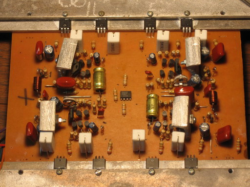

I can't be sure without seeing the schematic, but those diodes may be to help with temperature compensation. They should be mounted on the heatsink if that's the case, but they are shown on the PCB.
You have substituted slower transistors so that will help stability a bit. The design is still fundamentally flawed though.

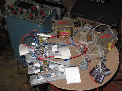

I already tested 2~3 hours long.
With 3 sets of MOSFETs ( total 12 MOSFETs ).
With 4 SPKs 8ohm 100W series & parallel to get LOAD 8 ohm.
I got headge ( because of Low Frequency )when I tested in my room.
I used equlizer to get more bass.
I think that will be stable if I used good heatsink.
I found that if I used more MOSFETs Heat will reduce.
Now I used very little heatsink.
But I blow air with fan.
That didn't hot in tested condition. ( Only Warm ).
My power supply didn't handle in that condition.
I think AMP can handle MORE POWER.
I think I used more transformer.
Because rail to rail Voltage reduce abt 90 to 73 V.
SPK Out put wave abt +/- 60 V clip deform in supply 73 V condition.
You can see all in my photo.

I can't believe how inadequate those heatsinks are for 73V rails! Fair play if it didn't blow up yet!

I do new PCB for neat & tidy of my IRF bridge.
I think, My bridge AMP didn't need protection when power On & Off.
Because I didn't hear anything when power On & Off of my bridge AMP.
I think that is because of my IRF AMP design which I got from internet.
Is that true ?

Hello richie00boy,
My schematic is same as old one.
Change in PCB rail line.
Because I faced each other (two amp) in my PCB. U can see in my photo.
So, I changed One circuit.(rotate Transistors,Diodes,Capacitors,Zener,Mosfet to convient with supply rail).
Sorry for my poor english

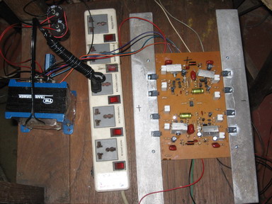

Difference In power supply.
Now, I used only one Transformer.
Old, Used Two transformers.

Bridge amps work best with one transformer. At the very least you need to make sure both amps share a good ground if you use two transformers.
