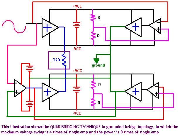

richie00boy said:Any power amp can be bridged provided the power supplies are sharing the same ground.
Also Two Pre-Bridged amps could also be bridged provided the power supplies of that two modules must me seperate and they also feature grounded bridge topology as well

But you link the -ve of one amp to the +ve of the other amp to gain a series-connected set of amps?
richie00boy said:But you link the -ve of one amp to the +ve of the other amp to gain a series-connected set of amps?
Certainly yes richie....
But won't the shared ground at the source side upset things especially if an unbalanced input source is used?

richie00boy said:But won't the shared ground at the source side upset things especially if an unbalanced input source is used?
Not at all!
Surely putting the entire swing of one side of each amp between the amps, yet tying the input down to a common point (thus each amp swings either side of this common point), will melt the input lead?

How many single amp can connect ?
Are there another bridging to get MAX POWER ?
Can I test with 4 power OPAMP ( like TDA 2030 ) in your Quad bridging technique ?
If that's OK, I will test with IRF 540 & 9540.
Must I use 3 separate power supply ?
One is dual supply & the others are single.
Is that true ?
Where can I ground for each OPAMP ?
Can each OPAMP ground to green line ( like in your photo ) ?

Try this Technique with 4 single opamps like TL071 else.... or 2 dual opamps like TL072
Yes there are 3 different power supplies..2 single and 1 dual
Max amps in this configuration are 4 which could be bridged
The Green line is Global earth

Hello Workhorse,
Where can I learn more detail about Quad Bridge technique ?
I cannot find in google search.

Hello Workhorse,
Can I series with two separate POWER AMP with separate input which is isolated with transformer ?
And then bridge or series with two serried POWER AMP (total 4 power AMP ).
Can I used like that
Start points - & + are join together.
- + - + ----> output 1
+ - + - ----> output 2
OR 4 series POWER AMP.
Pls, explain if u can.

Hi myanmar
Here you have the schematics of one implementation.
In this one, the supply (page-10/10) has a switch (Q510//511//512) who connects the Capacitors (C810 and C812) in parallel or in series depending on the signal amplitude.
In fact you have two power supplies in parallel for low power and in series for high power.
Please note that you could use this in any amplifier topology.
